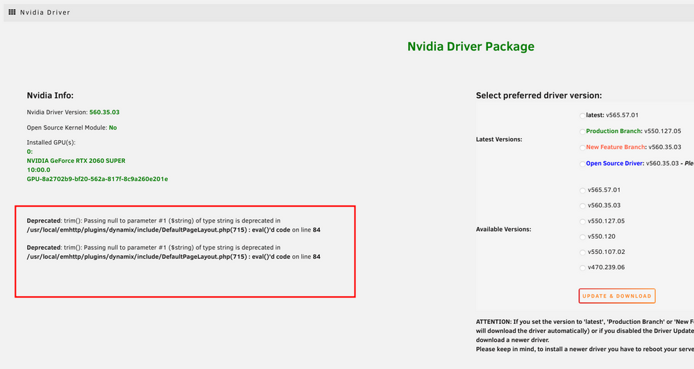

Do you probably have these messages on your plugin settings page:
If yes, do the following:
  1. Uninstall the plugin
  2. Reboot
  3. Install the plugin
  4. Visit the plugin page and select a 580 driver version
  5. Reboot

Around a week ago I started having an issue when I click on "nvidia driver" in settings, it goes to a blank screen and never loads...plus it seems I can't access any other part of Unraid for several minutes...I saw there was a plugin update today but didn't fix the problem...
Please post your Diagnostics but most of the times this means that there is an issue with the hardware.
