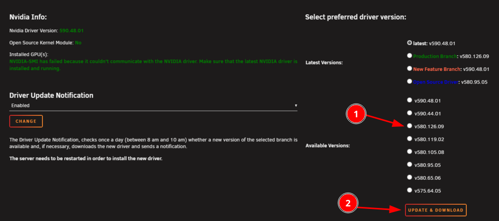

nvidia driver version 590.xx causes "NVIDIA-SMI has failed because it couldn't communicate with the NVIDIA driver. Make sure that the latest NVIDIA driver is installed and running."
hardware: Nvidia GPU P2000.
tried to rollback to version 580.xx by selecting version in the nvidia plugin. System says 590.xx already downloaded. I guess asking how do I roll back to a previous driver version (580.xx seemed to work)?
Can you please post a screenshot from which message you are presented with?
I really can't imagine that other folks can downgrade the driver and it won't work on your system. Select a static 580.x driver version and click Update & Download <- this will take some time.
Your Pascal card is now basically deprecated by Nvidia and it's now in the legacy branch which means you have to stay on the driver versions 580, so just a heads up that you have to buy a new card in the next few years.
attached is screenshot per your request. I also tried to remove the plugin, after reboot it reappears.

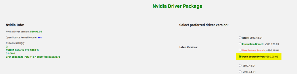

From the plugin page I select v580 (open source) as its listed as an available driver and I get the attached. Remember I uninstalled the plugin, reboot and the plugin reappears after reboot.
Is it possible to upgrade open kernel driver for unraid 6.12.15 ?
I have a 5000 series GPU I want to use, and Unraid 7.2 doesn't startup my dockers correctly (rc.docker: Docker daemon... Failed. but they startup OK manually, etc /etc/rc.d/rc.docker start) , lacks nerdtools and everything else I want to use, as a result I backed out to 6.12.15 until 7.x is improved.
Presently on 6.12.15 I have only the option of Open Source Driver: v565.57.01 .
In Unraid 7.2.3, "NVIDIA UNIX Open Kernel Mode Setting Driver for x86_64 580.95.05 " worked.
I see driver 580.95 supports kernel 6.1. Is it possible I can modify the nvidia plugin startup script to install a newer packaged driver other than the old nvos-565.57.01-6.1.126-Unraid-1.txz ?
Or run the NVIDIA-Linux-x86_64-580.95.05.run
Please post your Diagnostics.
Have you yet tried to select for example v580.126.09 from the list here:
and then clicking Update & Download? Since this is what I already said above, if you just leave it at v590.48.01 and you've click Update & Download it will just verify the Checksum.
However if the plugin reappears something is wrong on your system since this should not happen and possibly the plugin cannot be uninstalled for some reason.
Sorry, such old versions aren't supported anymore and the Open Source Driver won't be recompiled for such an old Unraid version (released about a year ago).
However you can compile your own driver package and have to make sure that it's correctly load at boot, please see this container:
https://github.com/ich777/unraid_kernel
and the build script for the Nvidia Drivers is here:
https://github.com/unraid/unraid-nvidia-driver/tree/master/source
Please do note that in my opinion it's not worth to go through all the effort and just upgrade to 7.2.3, I haven't heard anything bad about 7.2.3, I would strongly recommend to upgrade.

11 minutes ago, holtdw01 said:
attached is the diagnostics, also when I select a previous version of the driver I get the message attached earlier regarding v590.xx already downed loaded. it does appear to be something problematic with the plugin.
Do you also have these messages on the plugin page:
If yes, then this basically means the plugins is broken and you have to uninstall it.
If the plugin is still there after you uninstalled it and rebooted then something else is wrong with your system which I can't tell what it be, please make a post in the General Support subforums.
I see from your syslog that the initialization from the GPU was done early, but failed obviously because it's a 590.x version driver, so this means the removal from the plugin was not successful, which isn't an issue from the plugin itself usually since the plugin doesn't handle the removal, this is outside of the scope from the plugin.
However I would recommend that you do the following:
  1. Remove the Plugin
  2. Reboot
  3. Check if the Plugin is still there, if yes create a post in the General Support subforums, if not continue
  4. Install the Plugin again
  5. Select a 580.x driver version
  6. Click Update & Download and wait until the Dialog windows says it's finished
  7. Reboot
After that the correct Nvidia driver should be installed.

I am having issues trying to get my 5060ti working with 590 or production drivers. It just refuses to detect the GPU unless I use 580 open source drivers. I am trying to use this card for AI and it seems I might need 590 with CUDA 13.1 to enable features like MXFP4 quants.
Here are dmesg related to nvidia:

Here is my diagnostics. nvidia-smi wont detect anything under production or new feature branches
ugreen-diagnostics-20260121-1607.zip
50 series need open source currently.
ah thanks for that confirmation. Are we waiting on an updated unraid kernel or nvidia to release the open source versions?
I don't understand?
Go into the settings from the plugin, select the Open Source driver, click on Update & Download, wait for the dialog to say it's okay to reboot, reboot your Server, done.
6 minutes ago, ich777 said:
I don't understand?
Sorry, I meant when can we expect 590 drivers to work with blackwell/50 series cards? Are we waiting on nvidia or unraid to do updates?
