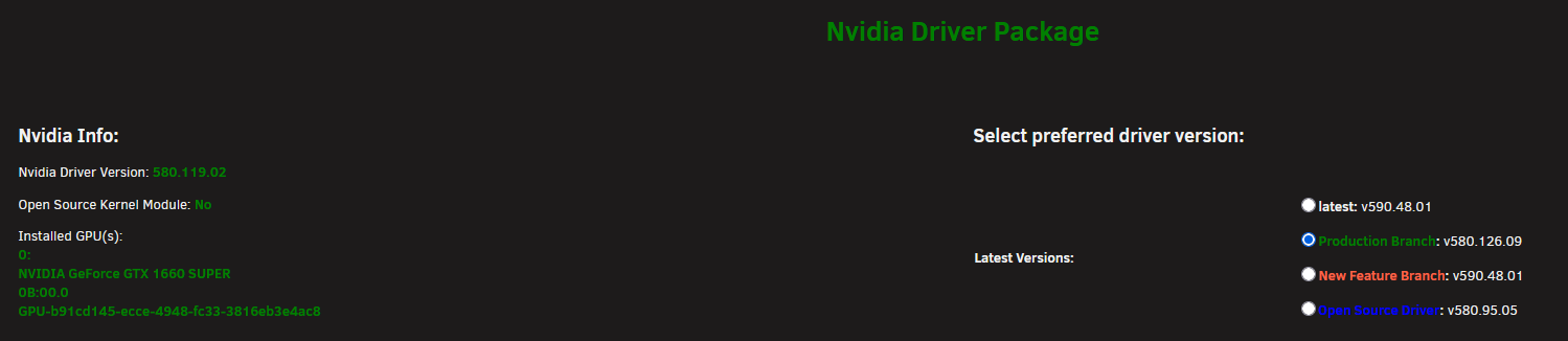

Apparently, the latest update failed to install. I'm showing my current version as 580.119.02 and in the available versions list, production is shown as 580.126.09. I tried downloading and installing from the plugin page, but it's telling me that the newest version is already downloaded. Will this just fix itself when the next version becomes available or should I go through whatever the process is to manually update?
Thanks,
Sam
What was the error message?
If it tells you that it's already downloaded then it should be fine, you can try to select the driver version manually and click Update & Download, this will verify that the driver is installed.

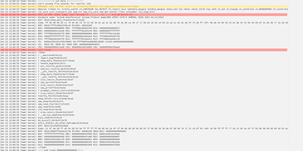

from 12/04/25 until about 1/16/26 everything was running fine. but a few days ago my unraid started randomly crashing.
I changed pcie from auto to 4.0 and that didn't do anything. but changing it to 3.0 appears to have made it slightly more stable but it will still crashes. going from every other hour to once a day or so. I tried setting it to 2.0 instead of 3.0 but that had the same results as 3.0.
both Above 4G Decoding is enabled and Resizable BAR Support is enabled.
ran the mem test and had no errors.
I have syslogs for the last few days but im not sure if those are safe to share. So I have included a screenshot of the error from right before the most recent crash.
attached are my driver info, nividia-smi, tower diagnostics, and my syslog error.
@ich777 if you say it's safe to include my syslogs I will add them.
Thank you for all the help and sorry to be back asking for more.

Edit: Found it:
Notification
Found new Nvidia Driver v580.126.09 but a download error occurred! Please try to download the driver manually!

9 hours ago, SamDu said:
Don't recall exactly, but it was something unhelpful along the lines of, "The update failed to install. Update the plugin manually."
Notification
Download failed for some reason, can't tell what went wrong when the download failes, maybe a short disconnect, GitHub not responding or something else happened, download errors are really hard to track down.
The plugin has a lot of fail-safes built in so that it is really hard to mess up, even if the driver is not found on boot, the plugin tries to download it on boot time, of course the boot time will take a bit longer depending how much bandwidth do you have and how fast or slow GitHub is.
So to speak, if you the plugin tells you that driver version 580.126.09 is already downloaded and the Checksum is OK, then it is safe to reboot, since when the Checksum fails it will try to re-download the driver.
I don't think that the Nvidia driver is the culprit since it seems that lsof is the cause of the issue.
Did you maybe install some other Docker/LXC/VM that could be the culprit?
The message lists just the modules which are linked in the Kernel and therefore it's listed first or at least somewhere at the beginning and the Kernel is always tainted because usually ZFS is there on Unraid and of course the Nvidia driver.
However I removed the Diagnostics since it seems SpaceEngineers is able to the write into the system log and there was some token included.
