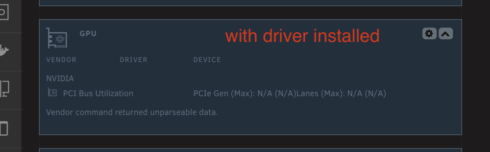

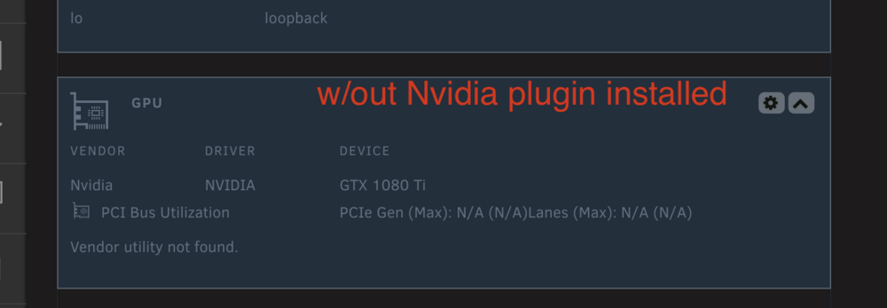

I recently installed a Gigabyte 1080 Ti and am struggling to get the driver to recognize the card. I have tried the following:
  1. I tried the production branch install, open-source install, and other listed versions. All gave the same issue:
I noticed some weird behavior as well. When uninstalling the driver, I saw that my GPU statistics app was able to see part of the GPU's identity but when I installed the driver again, GPU statistics now showed "N/A" in all fields:
  1. I have also disabled Secure Boot and the integrated CPU graphics within my BIOS settings.
  2. I made sure to disable and enable Docker upon first install.
  3. I have removed and cleaned the PCiE slot on my motherboard, and reseated it.
The card's fans come on, my BIOS can see the PCIE slot is in use. I'm not sure what to do. I feel like I'm going crazy trying to get this driver to work.
Thanks in advance.

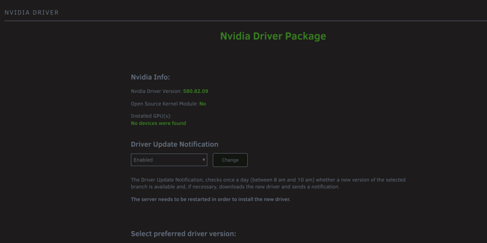

Hello reaching out with a quick question; as been meaning to upgrade the unraid OS to the latest. (current 7.1.4)
Currently running: Nvidia Driver Version: 580.82.09
At this moment plugins has detected an update for the NVidia Driver, when looking at the details of the driver it states....
Select preferred driver version:
Latest Versions:
latest: v580.82.09
Production Branch: Not found for this Unraid version!
Was curious if it is OK to proceed with upgrading the OS before the NVidia driver?

I'll give my input here, as ich777 is offline and it is after midnight at his house. I gave a short answer earlier, as I was unsure of the current behavior of the plugin code. If you scroll through the past few pages of this thread, you will see a number of people having issues after updating their driver after removed support for the Pascal cards in the 590.xx.xx drivers. ich777's response made it more clear how the plugin is handling it.
I would proceed like this:
  • Select your current version (v580.82.09) in the Available Versions area of the Nvidia plugin (not Latest v580.82.09). Click UPDATE and DOWNLOAD. The plugin will check, see that it is already installed, and quickly give you the Done button.
  • You can now update the Unraid OS
During the Unraid update, there is a Nvidia helper program that checks if an Nvidia driver is installed, and updates it if the driver version currently installed is one that is available for the Unraid version you are upgrading to (ich777 needs to recompile drivers for each kernel that Unraid uses). If the driver version is not available for that kernel, it updates to one that is. In the past, it updated to the "Latest" version. Worked great for a long time.
Then things got funny. The latest RTX 5xxx GPUs require the open source drivers. The Pascal cards now only work with the 580.xx.xx (and older) drivers. Looks as ich777 now added additional checks, so if you are on a 580.xx.xx driver, it will only update to the latest version of 580.xx.xx (and not 590.xx.xx, which won't work for the Quadro Pxxxx GPUs).
I think an Available Version is a good safety net to prevent accidentally finding yourself on a 590.xx.xx version after unthinkingly updating.
You also may want to start thinking about updating to a newer GPU. I recently replaced my Quadro P400 with a RTX A400. The P400 will probably be supported for a year or more, but its time is running out. Eventually there won't be a diver that supports the card that can be compiled against a future Unraid kernel, or a change to the runtime code used in Docker containers may require a later Nvidia driver version.
