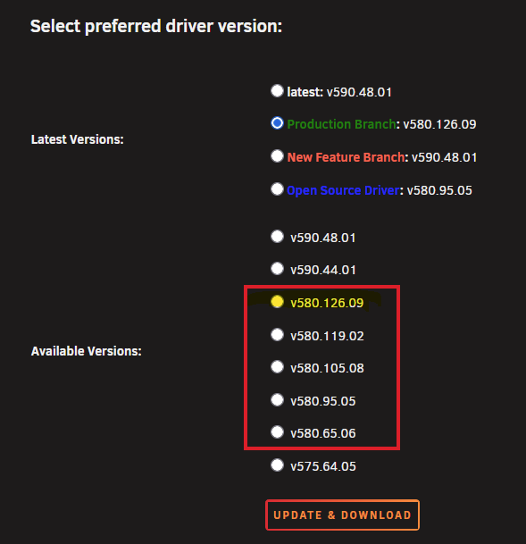

Attached current status of the plugin
Currently I am pending triggering the OS update as I require to select a maintenance window that works best.
From what I am understanding, before proceeding, is to manually select/set the radio button to 580.82.09 (screenshot) before pushing the OS update? If I am correct, doing this will keep it on the current version; which will allow further review of the driver, after the OS update/maintenance window?
Open to feedback, thank you again! )

I'll give my input here, as ich777 is offline and it is after midnight at his house. I gave a short answer earlier, as I was unsure of the current behavior of the plugin code. If you scroll through the past few pages of this thread, you will see a number of people having issues after updating their driver after removed support for the Pascal cards in the 590.xx.xx drivers. ich777's response made it more clear how the plugin is handling it.
I would proceed like this:
  • Select your current version (v580.82.09) in the Available Versions area of the Nvidia plugin (not Latest v580.82.09). Click UPDATE and DOWNLOAD. The plugin will check, see that it is already installed, and quickly give you the Done button.
  • You can now update the Unraid OS
During the Unraid update, there is a Nvidia helper program that checks if an Nvidia driver is installed, and updates it if the driver version currently installed is one that is available for the Unraid version you are upgrading to (ich777 needs to recompile drivers for each kernel that Unraid uses). If the driver version is not available for that kernel, it updates to one that is. In the past, it updated to the "Latest" version. Worked great for a long time.
Then things got funny. The latest RTX 5xxx GPUs require the open source drivers. The Pascal cards now only work with the 580.xx.xx (and older) drivers. Looks as ich777 now added additional checks, so if you are on a 580.xx.xx driver, it will only update to the latest version of 580.xx.xx (and not 590.xx.xx, which won't work for the Quadro Pxxxx GPUs).
I think an Available Version is a good safety net to prevent accidentally finding yourself on a 590.xx.xx version after unthinkingly updating.
You also may want to start thinking about updating to a newer GPU. I recently replaced my Quadro P400 with a RTX A400. The P400 will probably be supported for a year or more, but its time is running out. Eventually there won't be a diver that supports the card that can be compiled against a future Unraid kernel, or a change to the runtime code used in Docker containers may require a later Nvidia driver version.

Hello,
Appreciate this feedback and attention to detail.
I proceeded as per your instruction's and selected the driver version manual/static - v580.82.09, which quickly prompted the Done button.
The context and additional information helped, thank you for taking to time to explain that.
Regarding the suggestion regarding considering a new GPU, replacing the current Quadro P2000. I appreciate you tossed the A400 in the hat, truthfully the P2000 was deployed strictly for transcoding, and wasn't locked or limited to how many sessions or transcodes it could do.
With that, I wouldn't know where to start with comparable replacement GPU and I am happy you mentioned the A400 as it gives me a baseline to go from and look at that card specifically or comparable models. I may circle back with some questions on that. (NVidia vs AMD)

On 2/1/2026 at 7:52 AM, ConnerVT said:
If you are still using the Quadro P2000 you will want to stay on 580.xx.xx. Nvidia has obsoleted the Pascal based cards and is removing support for them from 590.xx.xx.
Best to manually select a 580.xx.xx version (latest one is fine).
Thanks again for all the help.
Managed to grab a NVIDIA RTX A400 and was able to successfully install it today. Everything is working well and updated to the new OS using the v590.48.01 drivers.
Appreciate the recommendations and assistance from everyone including @ich777 should be a nice GPU change for the coming years.
