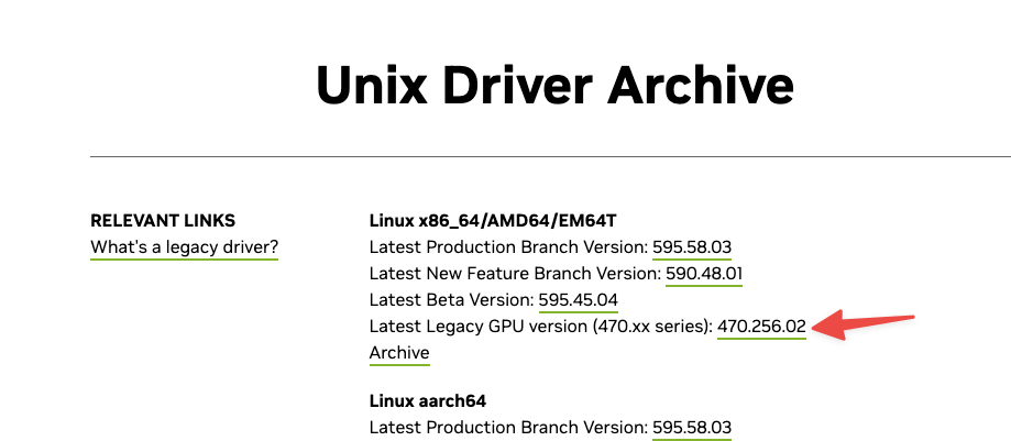

Sorry for the inconvenience with the Nvidia Legacy Driver (580.x) and the new Unraid builds but it seems that Nvidia didn't update their page for the Legacy branch where the version numbers are pulled from and therefore the driver was never built for the new beta versions:
However I've implemented a fix so that the correct driver versions are pulled now.
The compilation just started and the drivers will be available in the next 30 minutes for the new Unraid beta, please switch the driver version manually if you are already affected from this (upgrades from this point on won't have that issue).

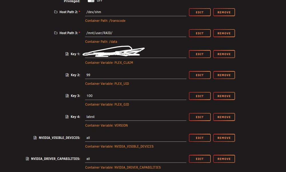

I've included screen shots and diagnostics as well as my docker template, because hey, the problem could be me.

In your NVIDIA_VISIBLE_DEVICES you need to put your NVIDIA ID, found in the NVIDA setting, start with GPU-xxxxxx-xxxxx-xxx-xx-

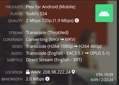

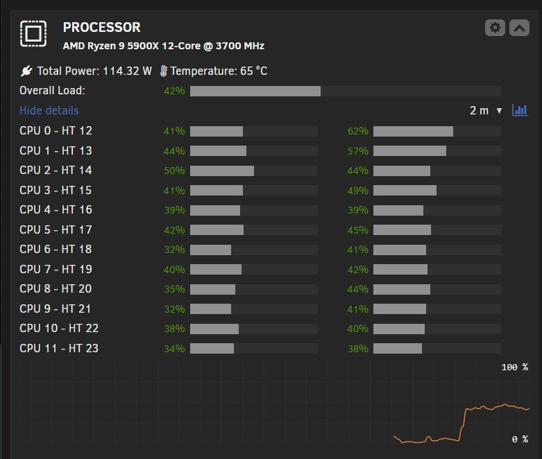

I swear I'm not on drugs. Doesn't help. Switch anything to transcode and the CPU goes nuts.
I've tried an Android device, a Windows Plex app (not the web app), and various media sources. Most stuff direct plays of course, but when I force it to 720p (for example)
