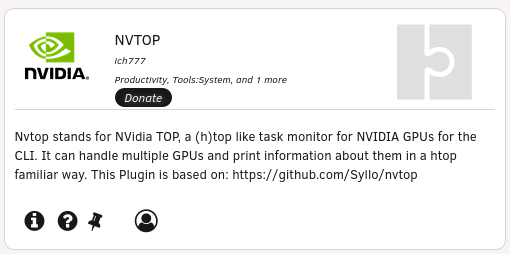

I have a suggestion/request: is it possible to include nvtop command with this plugin? I thought about asking in the nerdpack plugin, but seeing how it requires the nvidia plugin to be useful, I figured that here was a good place to start
I don't want to include nvtop in the Nvidia Driver plugin itself because it's not a part from the official driver but I can look into it if it's possible to create a plugin.
May I ask why or for what do you need it?
Well I'd hate to have a whole plugin just for one command. I can check the with the nerdpack author and see if they are interested?
As said above, since this is a third party plugin and not part of the driver itself I really don't want to include it in the driver package itself, hope this makes sense to you.
I think it wouldn't make much of a difference if you install it through the nerdpack or through a plugin the benefit of having a plugin is that when a update from nvtop drops it easier to install it or at least to update it.
Oh yes I understand why you don't want to include 3rd party. I just thought I would ask if it was possible. I would still be grateful for a separate plugin. I appreciate your work here my friend.
There you go:
Fantastic! Installed and working. However I do get these errors when I run it, but it does not seem to affect functionality.
nvtop: /lib64/libtinfo.so.6: no version information available (required by nvtop)
nvtop: /lib64/libncursesw.so.6: no version information available (required by nvtop)
Thank you so much!
That are actually warnings and can be irnored, if you want to hide it you have to start NVTOP with:
nvtop 2>/dev/null

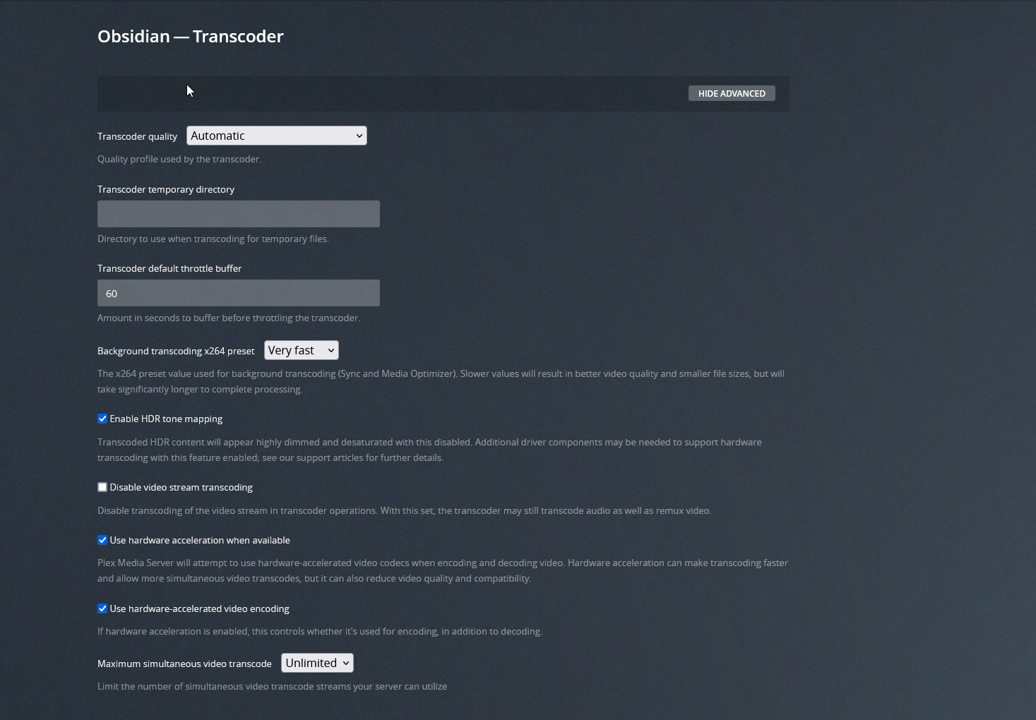

Hi All,
I am having issues with getting encoding to work on my plex container, decoding seems to work fine. Any idea why? Did I do something wrong?
Thanks.
