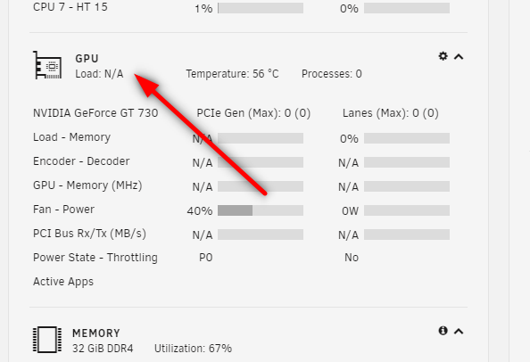

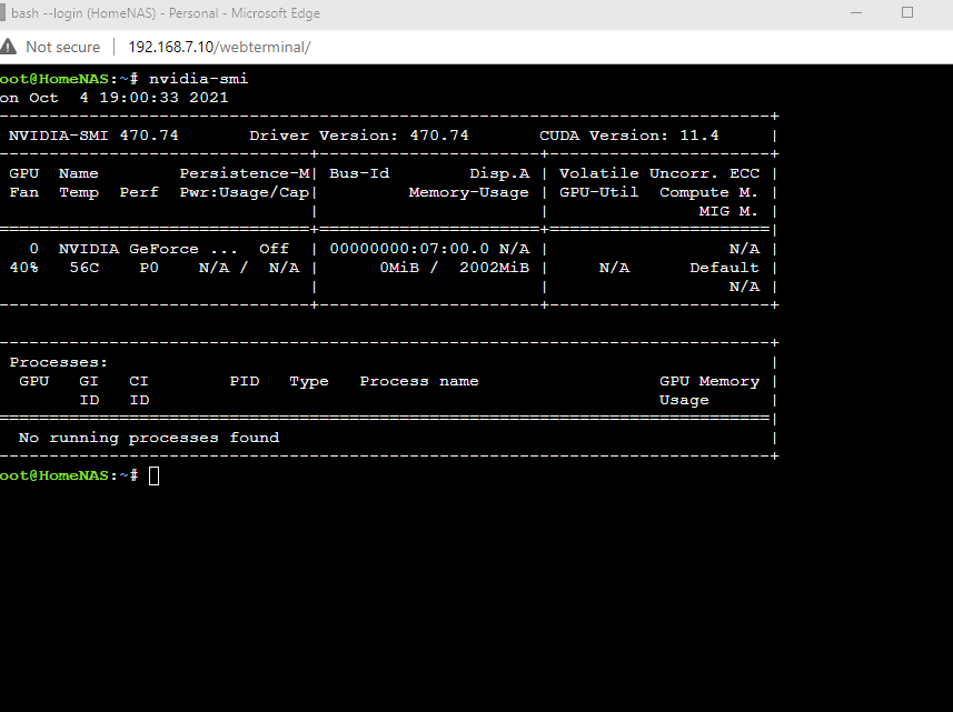

Hello, I am not sure if unraid recognize my nvidia card. the gpu load is showing NA. Is it normal?04_10.2021_19_02.13_REC.png.2e13ab89c64b82965cb249a72a76936b.png
Yes, this is a common thing.
The problem is that the GT730 is a pretty old card that is based on the Kepler architecture.
Nvidia often breaks compatibility for older cards in nvidia-smi so the values doesn't show up when a new generation of graphics card is released.
Your card is maybe capable of reporting those values but nvidia-smi can't display it because they actually broke compatibility in some kind of way for this card.
Another example would be that even some GTX1050Ti's won't report power draw or other values like in your case.
May I ask what you do with the GT730? If you are using it for HW transcoding in Plex keep in mind that this card can't handle h.265
You can also search this thread for "N/A" and you will find more posts about this but there is nothing I can do about that.

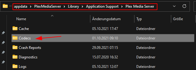

I did see others recommend deleting/renaming the Codecs folder as I did get a Codec error when trying TLotR but seemed okay after restarting.

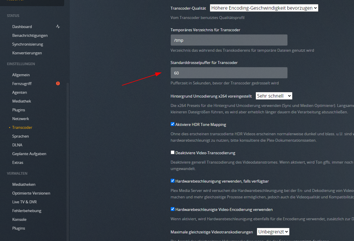

I had played with the buffer as well (increased it to 5 minutes) but it's back on 60 seconds.
Definitely seems like a buffer issue though as I can see it catch-up on the playback bar and that's when it errors. But usage on the GPU is only ~600MB.
I've purged the Codecs folder and increased the buffer to 300 seconds again.
