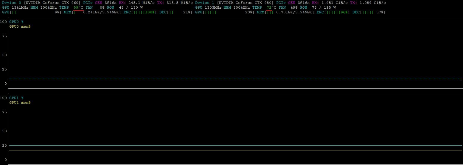

On 10/6/2021 at 12:51 PM, ich777 said:
How hot did the cards get?
Are you sure this is caused by the transcoding itself? Is it possible for you try Handbrake if the same happens there too?
Unfortunately I can't 100% confirm it's the encoder, it's my best guess. But there was also issue with network (switch was kind of broken) and after removing it there was no crash yet. But I run only one card.
For sake of testing I just turned both of the cards to encode and will report if it crashes or not.
So far the temps are like this: GTX 960 - cca 60 Degree, GTX 980 - cca 70 Degrees

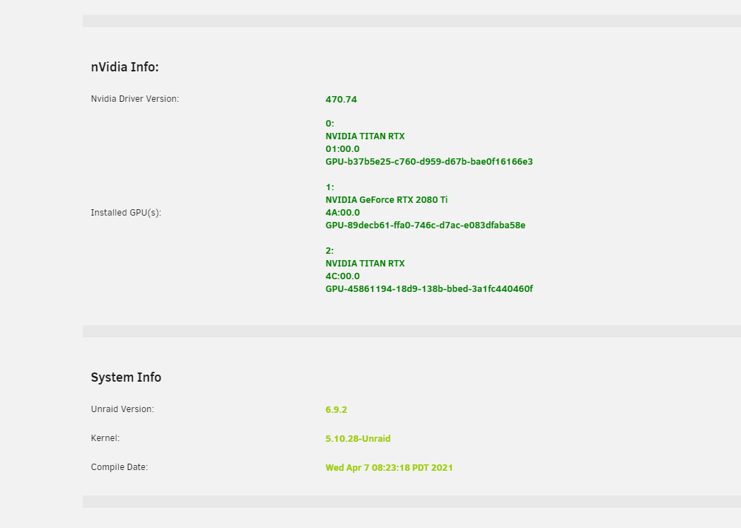

this happens at random times. I have 3 GPUs 2x RTX Titans and 1x 2080Ti:
I have 3 Docker Containers that utilize the GPUs. PhoenixMiner (uses all 3), Plex (2080Ti), Deepstack(Dual Titans). I thought maybe they couldnt all run together, so I stopped the others and just ran plex. system still crashed. right now they are all off, and Its still running, but time will tell.. Ill leave an update if it crashes again.
syslog.zip tower-diagnostics-20211009-0736.zip
How warm do the cards get, are they cooled enough for those kind of workloads?
just ran plex
What do you mean with that? A transcoding session? If yes on which card?
Maybe a card is broken but thats only a  vague guess...
Usually a null pointer reference is when the driver wants to access an unmapped memory region but this is the first time I've see this issue here...
So I did not get crash as before, maybe because I caught it first but seems like it network related at least this was in log:
 they are watercooled and dont go north of 52-4c.  I ran plex, no transcode, no nothing. i navigated to a show I wanted to watch, and then it crashed. Plex is tied to the 2080 Ti. the server is still going strong... without any of the nvidia based dockers running. normally it would have crashed by now. if its a memory map issue, could it be due to a memory size difference between the first and 2nd card? the fact that I have 3 cards? the fact that plex is pointing to the smaller one?
assuming that the thermals arent an issue, should this be able to run multiple docker containers pointing to the same GPU?
