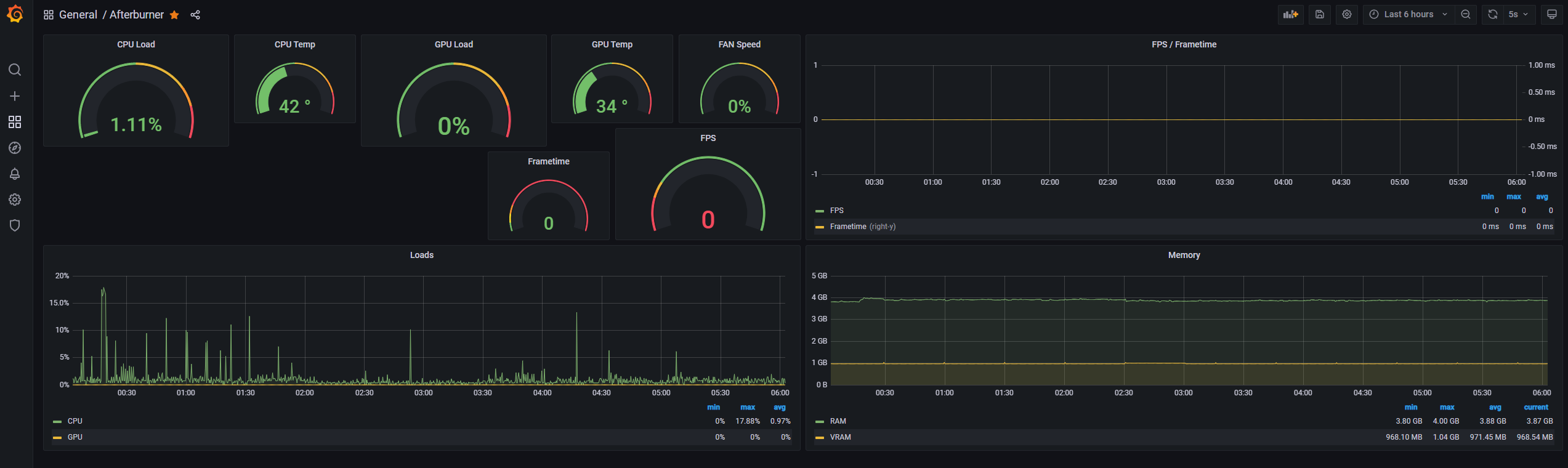

So, a gpu that is bind to vfio and also used in a vm (shut down), won't appear in the plugin?
My idea here is to try check the gpu power status, usage, fan speeds etc. while idle and before turning on the windows vm.
Edited by Kydonakis
i have no idea why you would do so ... but actually rather leave a VM running instead keeping it off (using less power then turning vm off, even when some small cpu usage is needed), when you want to have some infos while the VM is in idle, take a look at the MSI Afterburner prometheus plugin here, takes some nice Infos out for grafana.
sample from here (my idle gaming VM)

Thanks for the reply. Very nice plugin for monitoring.
One gpu (gtx1060) in my system which is used by one vm. While the vm is shut down, I see that the gpu fan are spinning so there should be some load on the gpu. This is what I am investigating here!
there is no load on the gpu, there is just no control so thats why the fans are running (wrong mode while off)
keep an vm running and you good to go
As @alturismo said there is no load on the GPU but since if you stop a VM the card is in technical terms reset (like if you reboot a computer or better speaking started) and dependent on how the manufacturer from the card has implemented how the card behaves when no driver is loaded in the BIOS of the card the fans spin at 0%, 30%, 50%,... on some cards they spin even at 100% like you can read a few posts above.
ok, I see. It is only the "reset status" of the gpu bios that causes the fans to rotate at some speed and this comes with no extra load (power consumption). Thanks for the information.
It is then, in my case, either choosing between a 24/7 half-speed fan spin (vm shut down) and the zero fan speed that comes with an extra 50-60W on the idle vm (cpu consumption and random windows disk readings/writings).

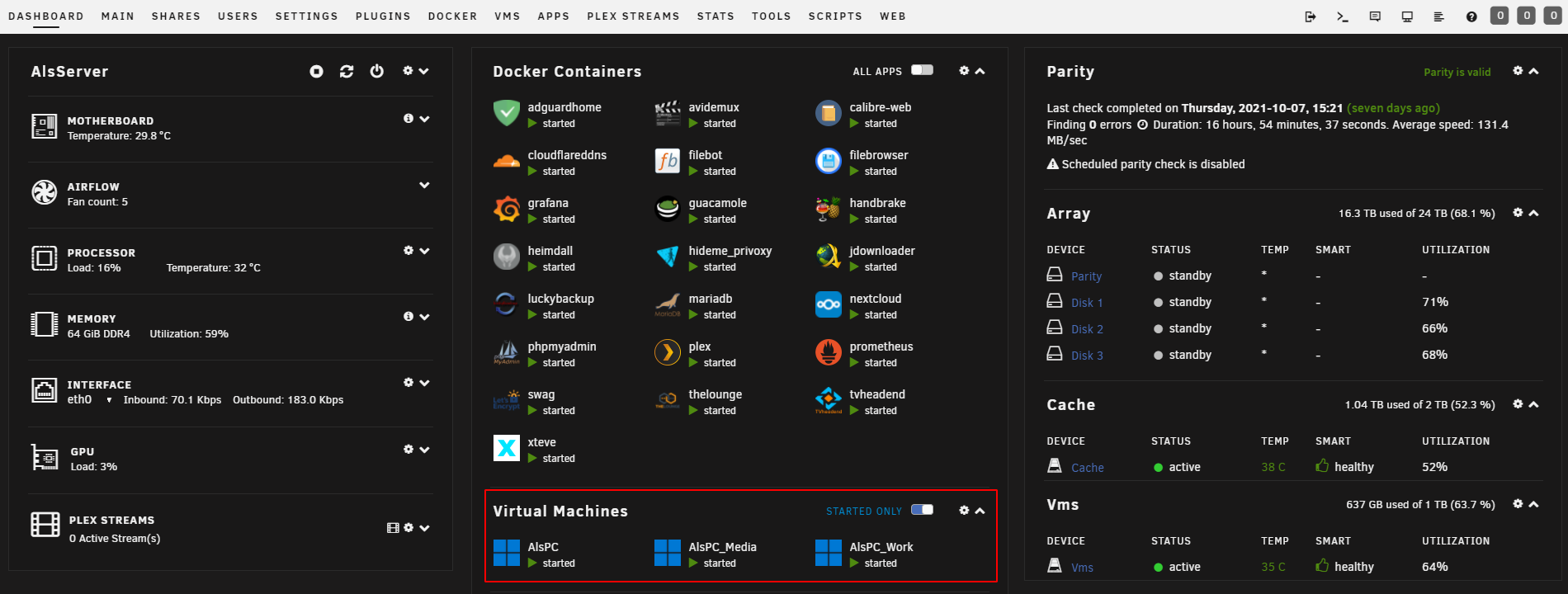

if you need a extra 50-60W for an idle VM there would be something wrong i assume
in my case, my whole system need ~ 10W less when the VM is in idle instead turning it off and the GPU is not in low mode ...
and im ~ 60 - 65W in total with 3 running VM's, 1VM x GT1030, 1VM x RTX3070, 1VM gvt-g igpu and some docker(s) etc ...
when i now turn my Media VM off (RTX 3070) my power consumption increases to 70 - 75W in total, so senseless to me to keep it off, i just have some small idle CPU consumption ... so for cooling it would be a little better, in sum i loose to turn off.
