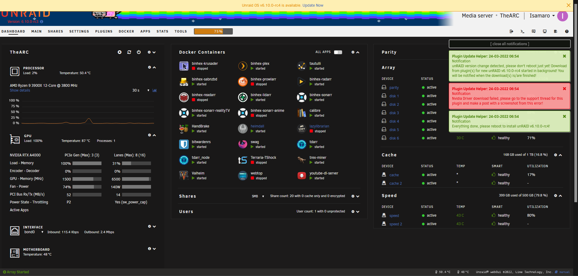

Hello, I received this error upon installing Unraid 6.10-rc4, should I roll back to rc3?  Thanks in advance.  1930923752_Screenshot2022-03-24163037-Copy.thumb.png.225a117990ae4bcf6ddbb8005ef3045b.png
Edited by Isamaro
Grammer!
You should follow the instructions in the screenshot you posted and post the error in the nvidia driver support thread.
Nothing to worry about, please see this post:
Thank you, ignoring the error and rebooting fixed everything!  You rock!
Shouldn't happen anymore or better speaking you will get a completely different error message. :)

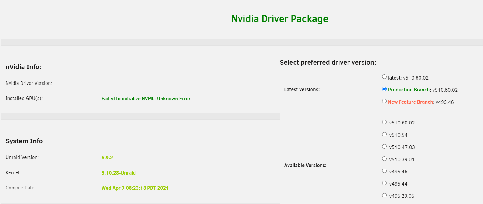

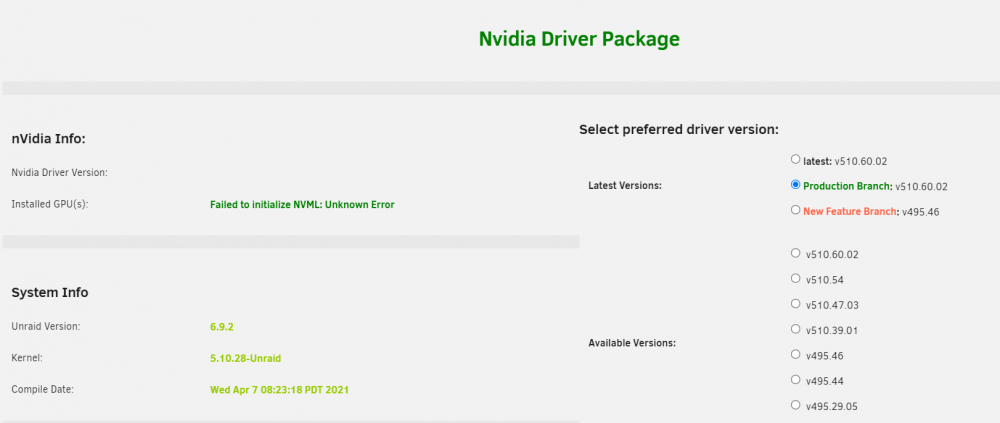

Have following issue after upgrading Unraid to 6.9.2 (reviously everything was working properly):
"Failed to initialize NVML: Unknown Error"
But GPU is defined in sysdevices propelry.
Tried to reinstall plugin with no success
Any ideas what to do in that case?
Please post your Diagnostics.
3 minutes ago, ionedji said:
6.9.2
From what version did you upgrade?
Old version 6.8.1
Also there was a BIOS reset taked place, but I have reenabled VD-T and PCIE virtualization. But don`t know maybe I did somethng wrong.
tower-diagnostics-20220403-2222.zip
Sorry, mislead you in previous messages. Upgrade is not the reason cause plugin was working on the same 6.9.2 version before. But before the issue my BIOS settings was reset (due to USB boot failure) so after this I have this error. Seems I should check BIOS settings but don`t sure how they can affect GPU and it`s functionality.
OMG, I`m an idiot.
Sorry, found out that VM with GPU path through was turned on automatically and this was the reason of issue.
Turned off VM and now everything is ok.

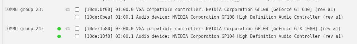

Yes, I now got time and saw this:
03:00.0 VGA compatible controller [0300]: NVIDIA Corporation GP104 [GeForce GTX 1080] [10de:1b80] (rev a1)
	Subsystem: ASUSTeK Computer Inc. GP104 [GeForce GTX 1080] [1043:8592]
	Kernel driver in use: vfio-pci
	Kernel modules: nvidia_drm, nvidia
As you can see the GTX1080 is bound to VFIO.
Please also note that your GT630 isn't supported by the newer drivers anymore.
Do you want to use the GTX1080 or the GT630 in a VM or for containers?
I`m using 1080 for dockers, GT630 is used as main GPU for Unraid so nothing to worry about. Thank you for your support, sorry for disturbance :)

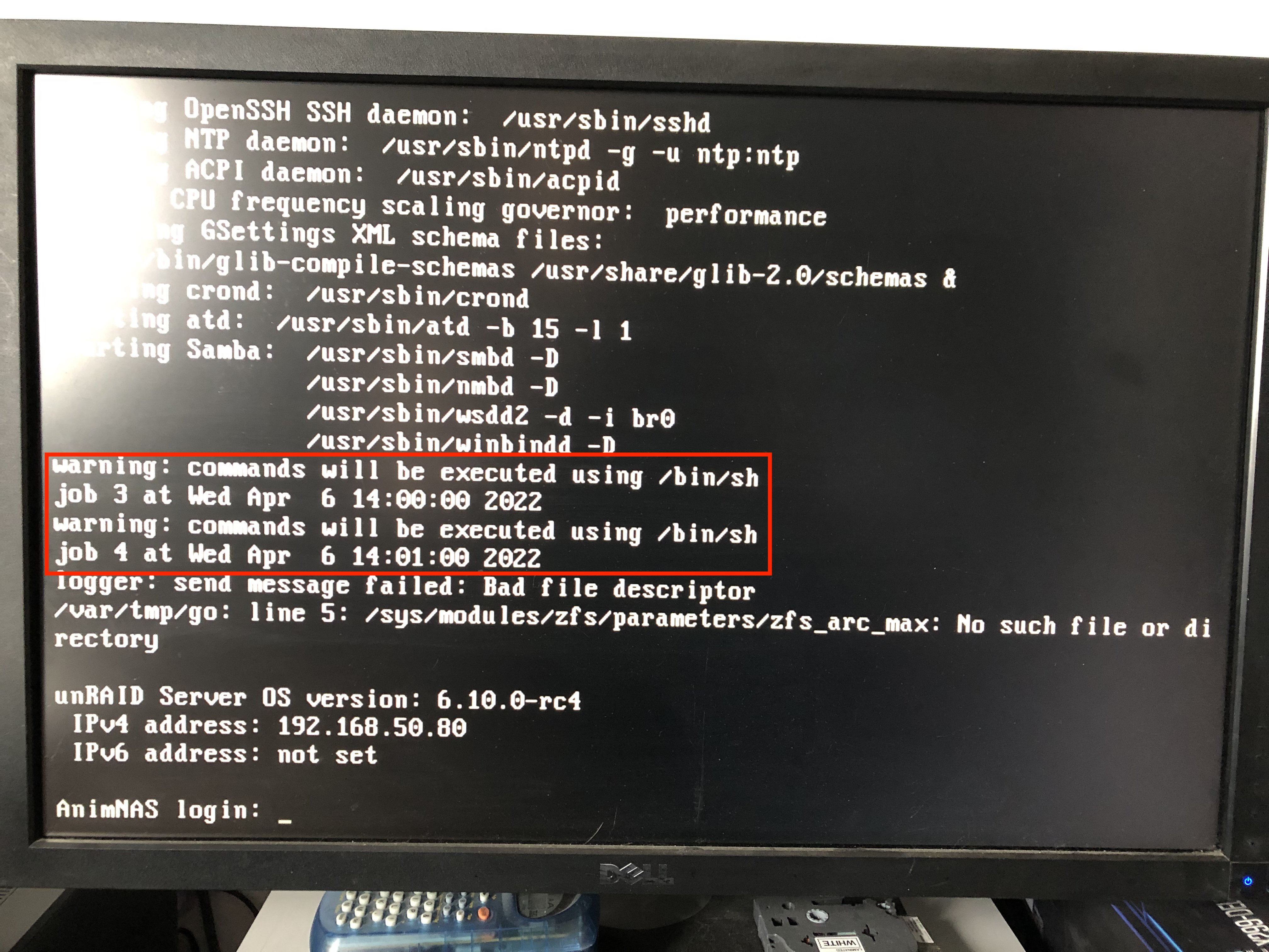

I just had to do a flash drive replacement and everything is back up and running, but I noticed an old reported issue is apparently still occurring and is now being duplicated.
On 10/7/2021 at 2:12 PM, N385 said:
Warning: commands will be executed using /bin/sh and it sits on that for about 60 seconds
@ich777's reply:
This can be ignored and will be fixed in an upcoming version from the plugin, the ~60 seconds are actually the time it takes to install the plugin.
The attached picture of my normal boot now shows 2 of those messages:
I fixed the /var/temp/go issue (ZFS plugin related) but I'm also still trying to find what causes the logger: send message failed: Bad file descriptor message. Any thoughts on the job 3/4 messages?
Edited by AgentXXL
Please attach your Diagnostics.
I will grab a clean set after my next reboot, but I prefer to send them direct vs public posting. I do use the anonymize function but having looked through them, there's still info captured that I prefer not be public. That said, it's more about the job 3/job 4 messages which seem to be very similar to the message reported by N385 last year. Has the issue that caused those messages been fixed?
I find no evidence of those messages in syslog, and haven't found any logs specific to the Nvidia plugin that I can look through. I understand wanting a full set of diagnostics but it would be nice to get tips from more advanced users like yourself so that we can do our own troubleshooting.
Edited by AgentXXL
You can always send them directly to me...
This is not really an issue at all and I don't think that thay are caused by the Nvidia plugin, rather I think they are caused by another plugin, but I could be wrong about that, maybe I've also introduced such a new message with the update from the plugin where I introduced the automatic update check to it.
As said above these are not really issues at all, I don't think you have any trouble running a plugin or something causes instability or am I wrong?
This is mostly because I have to run a background process that checks my Github repo every day if there is a newer Nvidia driver available.
One background process is also running for the Plugin Update Helper (don't know if you have seen it already in action) which is always running regardless of which Driver Plugin (Nvidia, DVB, ZFS, USBIP,...) you have installed.
That are maybe the two things that causes this messages.
But as said above these messages will not harm your system in any way, have to look into it if I can hide those messages, but I'm really not entirely sure...
Thank you... I'm not seeing any issues that I can trace to the job 3/job 4 messages, but my OCD prefers to see a clean boot. I'm in the process of doing some minor hardware maintenance today so I'll capture the fresh set of diagnostics and send them to you. It's odd that I can't see anything in syslog that mirrors those messages, and same for the 'logger' message that I'm also trying to track down.
I haven't seen anything that would point at the Plugin Update Helper, but I'm using both your Nvidia and ZFS plugins. If you need me to check anything on my system, let me know.
Its obviously not a rush, but hopefully we can track down the source of these messages. Even if there's not a simple way to prevent them, knowing what actually causes them will help satisfy my OCD.
I’ve seen those messages on boot ever since installing the nvidia plugin on 6.9.2. My OCD just isn’t as bad. 😁
@ich777 I just had a small realization on why there's two such messages - because I'm now using 2 of your plugins - Nvidia and ZFS. That makes it likely that it's the same code in both plugins, and as such it could be related to the Plugin Update Helper if both use it. Note that the messages go away if I boot without those plugins installed, so it's certainly looking like they're the culprits.
I'll be sending you my fresh diagnostics from yesterday shortly. I may have tracked down the logger message as something related to using a remote syslog server. The rsyslog functions are initialized before the network is fully up, so it fails with a few errors during the bootup. That's a native unRAID issue so I'll follow up with a bug report for them.
Regardless, thank you again for your plugins! I'm very pleased with the functionality from both of the ones I'm using.
22 hours ago, AgentXXL said:
Nvidia and ZFS
Please update the plugins and reboot, warnings are now hidden.
