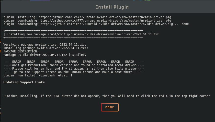

Hi, I'm trying to reinstall the plugin and am getting this error, can anyone help me troubleshoot?
Do you have any adblocking software on your network? If yes disable it and wait for at least 10 minutes and try it again.
If this doesn‘t work make sure that the plugin is uninstalled, reboot your server and try it again.
This is usually a indicator that your server can‘t reach GitHub.
Please also post your Diagnostics.

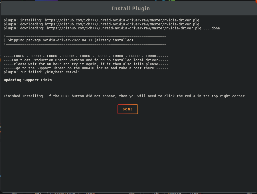

No adblocking software.  I've tried several reboots and can ping github if that helps
diagnostics-20220429-0149.zip
Not related to this but if you have the Intel GPU TOP plugin installed please remove those lines from your go file:
modprobe i915
chmor -R 777 /dev/dri
The plugin will handle the activation from the iGPU.
Please run this command once from your command line:
rm -rf /boot/config/plugins/nvidia-driver
Can you also ping GitHub from your server?
Can you open this file or download it on your server with this command:
wget https://raw.githubusercontent.com/ich777/versions/master/nvidia_versions
I would also recommend that you first upgrade your Server to Unraid version 6.10.0-rc5, you are still on 6.10.0-rc2

Thanks, I removed those lines from my go file.
I ran the command, it ran successfully
yes I was able to download the file from github
I upgraded to rc4 and ran into some issues with something else I was working on a few weeks ago so I reverted to rc2.  Unless you think it's relevant to this problem I'm currently having I'm going to hold out till the next version update
2022-04-29 02_26_03-root@Jarvis_ ~ _ bash --login (Jarvis) — Mozilla Firefox.png
RC5 was released just a few days ago... May I ask into what issues did you run?
Please reboot and try to install the plugin again from the CA App, it should work without a hitch.

I don't fully remember, it was a few weeks ago, but I think it had something to do with a networking error with one of my dockers.  I'll mess with it when I get a moment in the next few days and see if rc5 fixes my problem.
