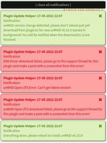

I'm getting a failure too. Got this notification-
Event: Plugin Update Helper
Subject: Notification
Description: Nvidia Driver download failed, please go to the support thread for this plugin and make a post with a screenshot from this error!
Importance: alert
Immediately after the failure notification I get a success notification-
Description: Everything done, please reboot to install unRAID v6.10.0!
Importance: normal
Not sure which one to believe.
This is another error...
You can safely ignore that error, it's mainly caused because the Changelog from 6.10.0 isn't formatted the right way and the Plugin Update Helper has no other way of detecting the Kernel version and that fails.

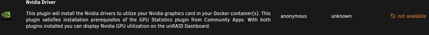

6 hours ago, repomanz said:
Just upgraded to 6.10 today and appears the plugin failed.  Went to reinstall the plugin and get this:
Have you removed the plugin in the first place from the failed download tab?
Please execute this command once from the command line and reboot, after that install the plugin again from the CA App:
rm -rf /boot/config/plugins/nvidia*
(Copy the exact command, otherwise this can cause data loss!)

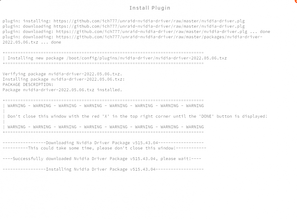

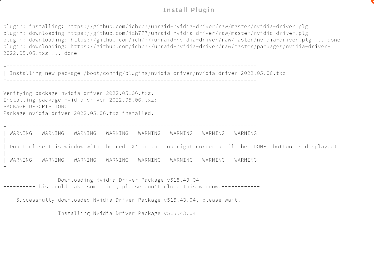

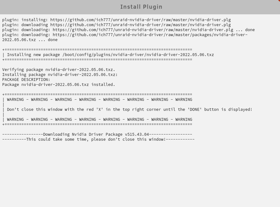

Hi, I am having similar issues to the above with a slight difference, my installation seems to hang up on the driver installation, before 6.10.0 this would not take more than a minute give or take, I left this open for more than 20 mins and it did not progress.
Steps I have tried to resolve:
1. Reboot Server
2. Remove plugin from failed
3. Executed command "rm -rf /boot/config/plugins/nvidia*"
4. Reboot Server
5. Reinstall plugin from CA
6. Stalled at installing driver
1. Reboot Server
2. Plugin not in failed
3. Execute command "rm -rf /boot/config/plugins/nvidia*"
4. Reboot Server
5. Execute commands: mkdir -p /boot/config/plugins/nvidia-driver echo 'first_installation=true driver_version=latest local_version=none disable_xconfig=false update_check=true' > "/boot/config/plugins/nvidia-driver/settings.cfg"
6. Reinstall plugin from CA
7. Stalled at installing driver
GPU's are visible under devices and cant see anything obvious in the log that references an issue, not sure where to go from here now? Please help.
Which one exactly?
Can you post your Diagnostics please?
Can you maybe open up a second window from your Unraid instance and pull the Diagnostics when it's stalled?
Please don't do this... before installing without specific advice...
Simply try:
  1. Remove the plugin from failed installations plugins tab
  2. Execute command "rm -rf /boot/config/plugins/nvidia*" (without double quotes)
  3. Reboot
  4. Pull a fresh copy from the CA App

I believe I have figured out my issue, after 3 attempts (6 reboots) at following the below steps:
  3. Reboot
I was consistently met with the screen shot below and never moving beyond this point when installing the plugin.
What I then tried was the following:
In my server I have multiple Nvidia GPU's one of which was bound (vfio) for passthrough, I unbound this card, and then followed the steps above and the plugin and driver installed without any issue, dockers using acceleration immediately started working however VM did not.
I then rebound the GPU (vfio) and rebooted and all dockers and VM's returned to the working state that had existed in 6.9.2.
I hope this is helpful, but definitely solved the issue for me on 6.10.0.

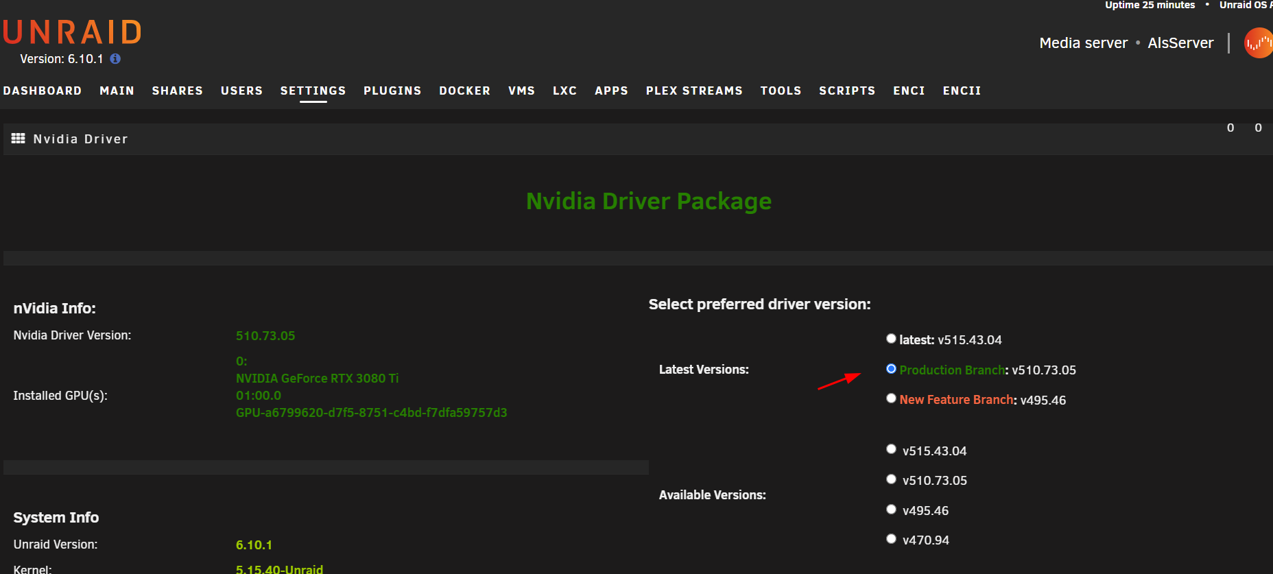

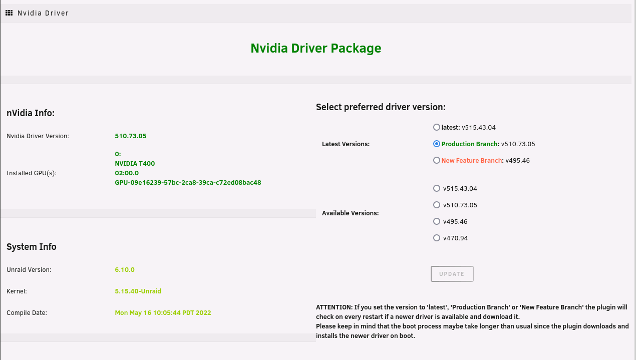

Upgraded to 6.10.1 and had a problem with gpu again, went into plugin settings and it has reverted to latest driver again.
Seems it is not honoring driver preference settings between upgrades?
im on the production branch, just updated and all is as expected ?
may take a look at your flash config what is written there
Already rebooted again with the setting changed, this is what it looks like now, and this is what I had set in plugin prior to OS update
