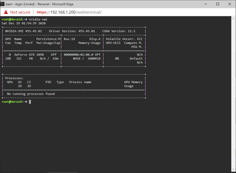

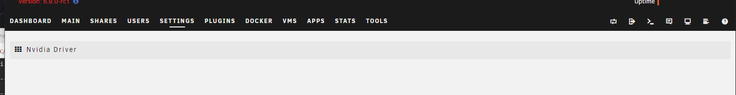

I cannot get the driver to work on 6.9RC1. I had the linuxserver driver working on 6.83. I removed that driver and then upgraded to 6.9RC1 following the instructions at the beginning of this thread to install the Nvidia plugin. The screenshot below shows that I have the plugin installed.
I get nothing when I click on the Nvidia driver as seen below;
Here is the output of nvidia-smi. It took it about 10 minutes to run, but eventually gave the information below;
I tried some of the suggestions in this thread such as reseating the card and making sure that was not bound with VFIO. I also rebooted multiple times in addition to disabling Docker. Any other suggestions?
Can it be that you have PiHole or something installed in your network?
The Plugin page just shows a empty page (when you click on the Nvidia-Driver symbol)?
EDIT: Anyways wouldn't it be better to use the Intel iGPU for this (no restriction of HW transconding streams).
