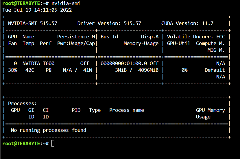

After updating to 6.10.3 my t600 no longer can be used to transcode or in vms. It is detected in the nvidia plugin. I have VT-D Enabled but IOMMU is showing as disabled in Unraid. I am pretty confused. The nvidia-smi command shows there are no processes, which is true as plex transcoding us being done on the cpu, but as this image shows, the gpu statistics says it is doing something. It all worked fine untill I added my raid card and updated to 6.10.3. I think it could possibly be the motherboard as 2 of the ram slots stopped working this morning as well. Any suggestions?
Don't use this command use it in combination with 'watch' like:
watch nvidia-smi
(to exit press CTRL + C)
Doesn't have to be true, you have to undestand that Plex transcodes in chunks and ahead of time and also does throttle the transcode and maybe you've issued the command where it was actually throttling, that's why I recommend using the command from above.
Also transcoding is not done entirely on the CPU, don't forget that if you transcode it is most likely that the Audio has to be transcoded to and if you have embedded subtitles in the file Plex can use almost 100% of the CPU, in your case, if the transcode is done entirely on the CPU it would use 100% of your CPU since this is a fairly old CPU nowadays.
Please double check that it isn't working, my Nvidia T400 is working just fine on 6.10.3 with the latest Nvidia driver and from what I see, yours should also work fine too.

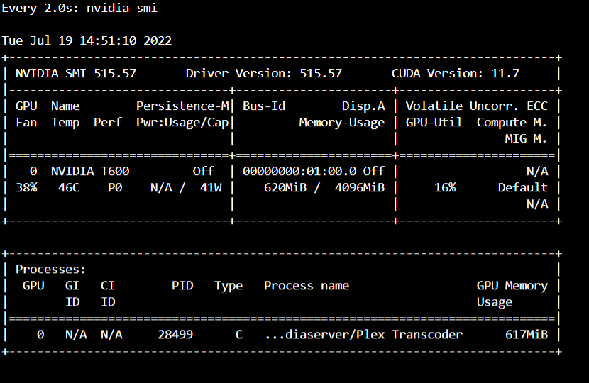

It is reporting this back. I think it may be working but not correctly, does this mean it is an issue with the plex implementation of the gpu?
Interestingly, when I disable HW accelerated transcoding on plex, the gpu still shows the same as the image above, suggesting it is being incorrectly utilised
EDIT - When I disabled both checkboxes for hardware acceleration No running proccess was found with watch nvidia-smi

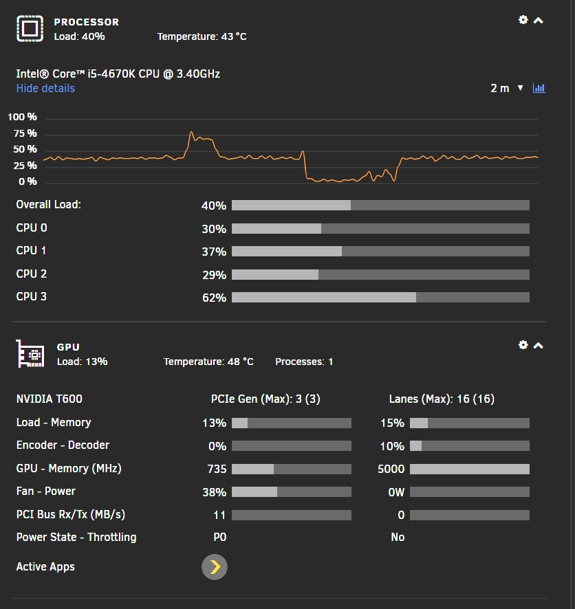

I think I have found the root of the issue. The 4670k only has 16 pcie lanes, when adding the raid card to the second pcie slot this will have halved the pcie bandwith of the second slot, resulting in the gpu only getting 8 lanes instead of the 16 and I think this would account for the drop in perfomance.
Thanks again for your commitment to the community and for your time spent on noobs like myself.
Definitely not.
8 lanes are plenty of lanes to do the transcode, even one lane of PCIe 3.0 is enough to do it.
1 minute ago, ich777 said:
Definitely not.
I am completely out of ideas then :(
5 hours ago, ich777 said:
So this means everything is working in terms of the Nvidia Driver or am I wrong?
After some more investigation, I can see that the nvidia gpu is only being used to decode and not to encode
Maybe you are transcoding to a format that it can't handle or something like that, but that seems more of an issue with the container/settings than the plugin.

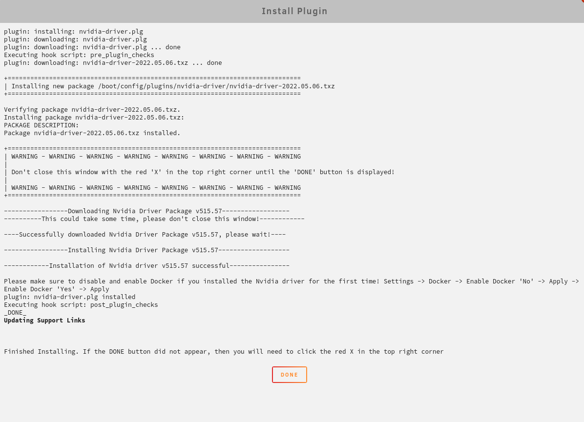

last night I was streaming from Plex, suddenly the stream freezes. went to check my unraid dashboard, timeout error... reboot the server, unraid boots up fine, everything else is working correctly EXCEPT my plex docker container is stopped, errors on start, the error was a bad param on --runtime=nvidia, ok so I remove that param and all the other gpu flags, plex container works fine now on cpu enc.
I notice that the driver plugin is missing, and go to reinstall it, I get this error:
plugin: installing: https://github.com/ich777/unraid-nvidia-driver/raw/master/nvidia-driver.plg
plugin: downloading https://github.com/ich777/unraid-nvidia-driver/raw/master/nvidia-driver.plg
plugin: downloading: https://github.com/ich777/unraid-nvidia-driver/raw/master/nvidia-driver.plg ... done
| Skipping package nvidia-driver-2022.05.06 (already installed)
-----ERROR - ERROR - ERROR - ERROR - ERROR - ERROR - ERROR - ERROR - ERROR------
----Can't get Production Branch version and found no installed local driver-----
-----Please wait for an hour and try it again, if it then also fails please-----
------go to the Support Thread on the unRAID forums and make a post there!------
plugin: run failed: /bin/bash retval: 1
Updating Support Links
Finished Installing. If the DONE button did not appear, then you will need to click the red X in the top right corner
I'm assuming I need to delete the driver installation so that the plugin can be reinstalled?
Please post your Diagnostics.
A crash shouldn't wipe the Nvidia Driver plugin at least I don't know how that would be possible.
Can you open this file on your local computer: Click
Do you have any AdBlocking software installed on your network?
Please double check on the plugin page that the plugin is first uninstalled from the Plugins Error tab if it is in there, then reboot and then try again to redownload the driver plugin from the CA App.
EDIT: I think GitHub has a bit of an issue currently, I'm downloading between 50-100 KB/s currently... :D
removed from errored plugins, rebooted, reinstalled and got this slightly different error message

Installing package nvidia-driver-2022.05.06.txz:
PACKAGE DESCRIPTION:
Package nvidia-driver-2022.05.06.txz installed.
attached diagnotics (unfortunate did it after reboot)
tower-diagnostics-20220721-1342.zip
