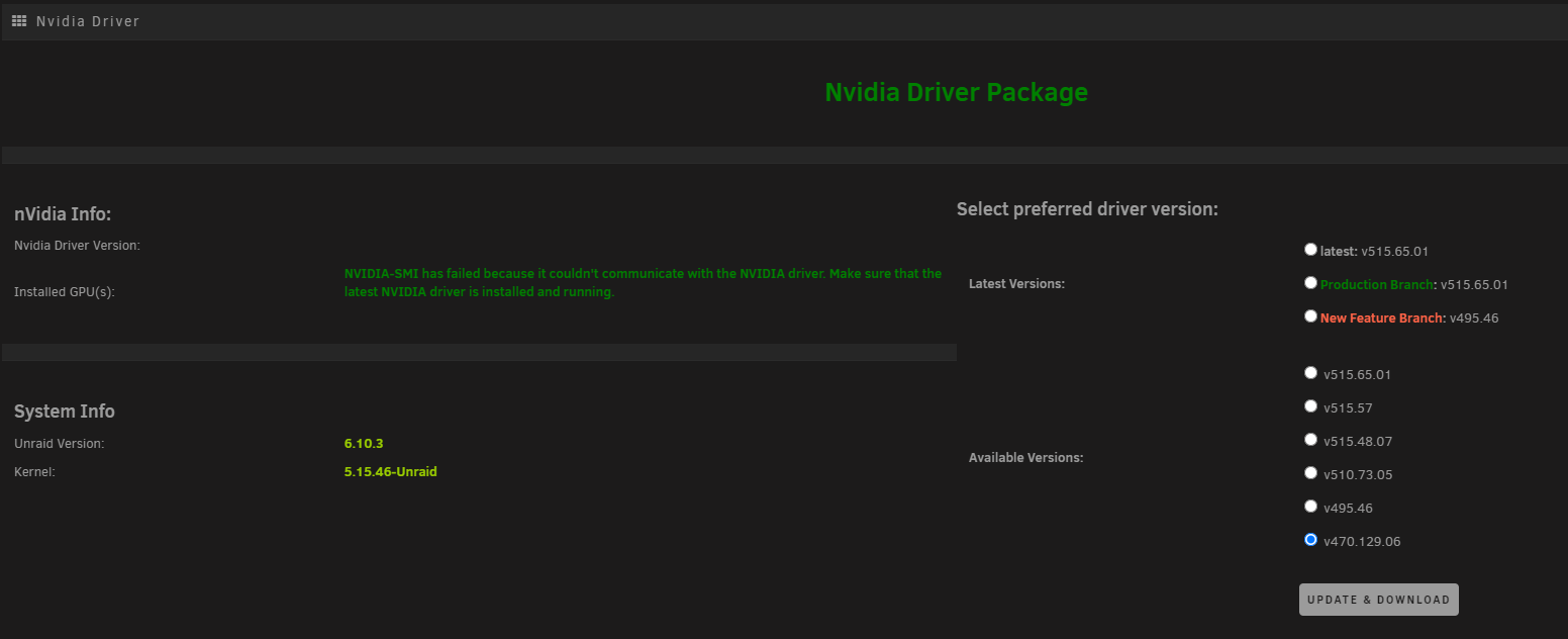

I am getting the error: "NVIDIA-SMI has failed because it couldn't communicate with the NVIDIA driver. Make sure that the latest NVIDIA driver is installed and running." I need to be able to install driver 377.83 for my Quadro 2000. How do I install this driver?

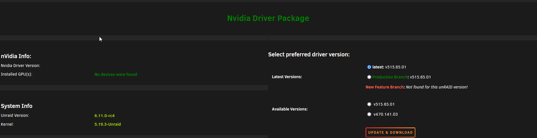

Good Morning, I'm having an issue with this. Tried going through step by step a few times and searching but through the issue but maybe I'm missing something. I'm on 6.10.3 and have a 780ti card. Looking through the list I confirmed the latest drivers that operate this card that are supported in the list are v470.129.06 - I've selected and tried to install them multiple times but they don't seem to work.
I've confirmed the card is functional in another machine and it does appear in my hardware list on my server. Only thing I can come up with it either I've missed something or the card is incompatible with my mobo. Attached are diagnostics and screengrab of what I'm seeing.
Main reason for doing this is to use hardware encoding on Plex. The dual Xeon CPU setup starts to struggle transcoding 4K and bottlenecks on any more than one so I was hoping the Nvidia encoding would help.
Any help would be appreciated.
urhomeserver-diagnostics-20220903-1108.zip
I think you can see why it's not working:
04:00.0 VGA compatible controller [0300]: NVIDIA Corporation GK110B [GeForce GTX 780 Ti] [10de:100a] (rev a1)
    Subsystem: eVga.com. Corp. GK110B [GeForce GTX 780 Ti] [3842:2884]
    Kernel driver in use: vfio-pci
    Kernel modules: nvidia_drm, nvidia
I don't know why but you have bound the card to VFIO in your syslinux.config
22 minutes ago, Leadin said:
780ti
This is a pretty bad choice if you want to use it for Plex HW transcoding...
This card isn't even capable of h265 (HEVC).
I would rather recommend that you look into something like a NVIDIA T400, this card is Turing based, has a maximum power draw from 35W, doesn't need external power and you can get it for about $ ~120,- brand new.

What is the output from nvidia-smi? Please also post a screenshot form the plugin page.
Do you have C-States enabled in your BIOS? On what BIOS version are you? make also sure that you enable Above 4G Decoding.
Is this the first time you are installing the driver?
C-state is disabled, 4G Decoding is disabled by default but will enable it later today.
I had the plugin installed since it was release long time ago but I tried removing the plugin and driver several times & reinstalling it with multiple reboots.
nvidia-smi shows "No devices were found", The message changed from the previous message as the post above now it just shows No devices were found.
