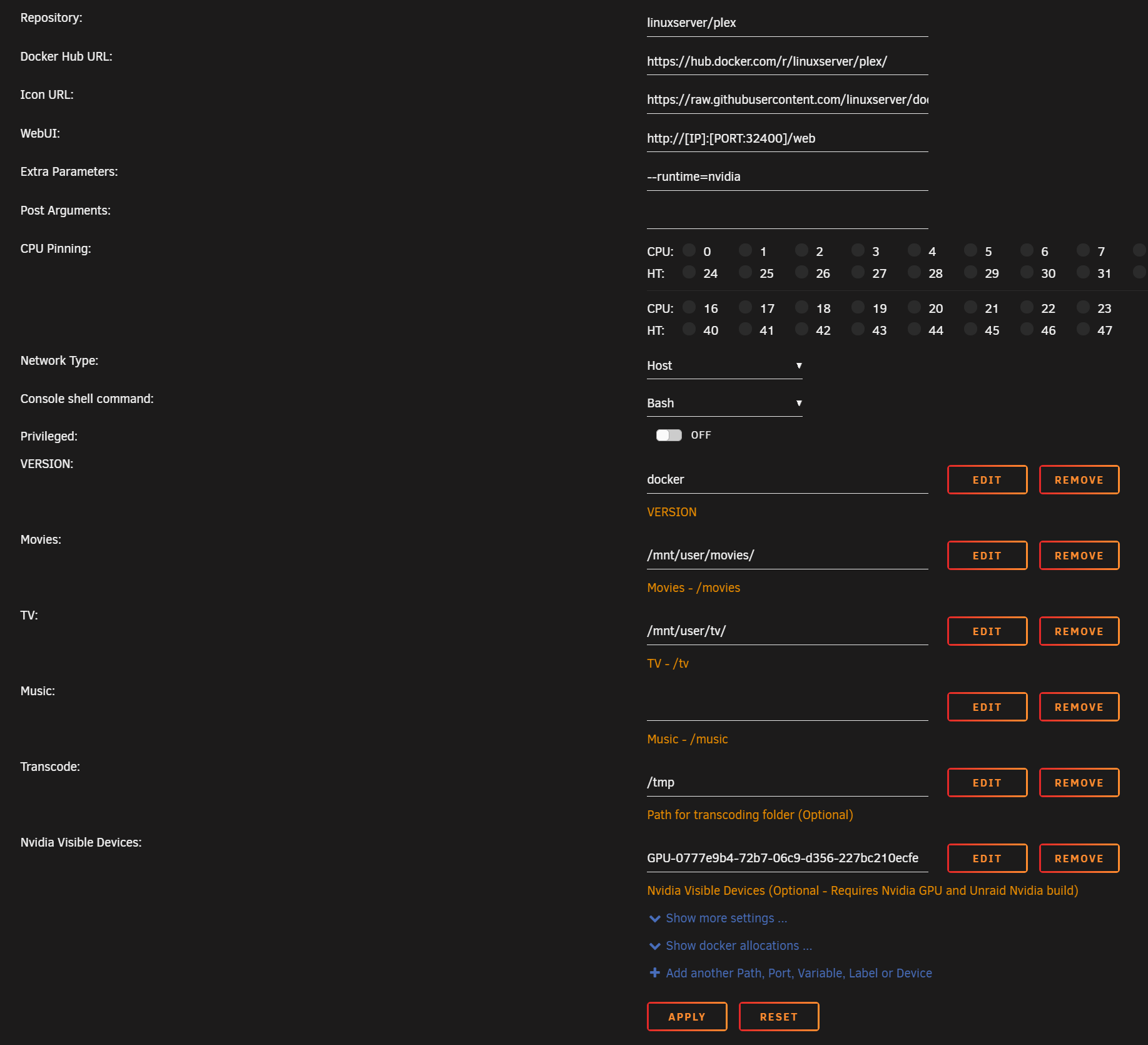

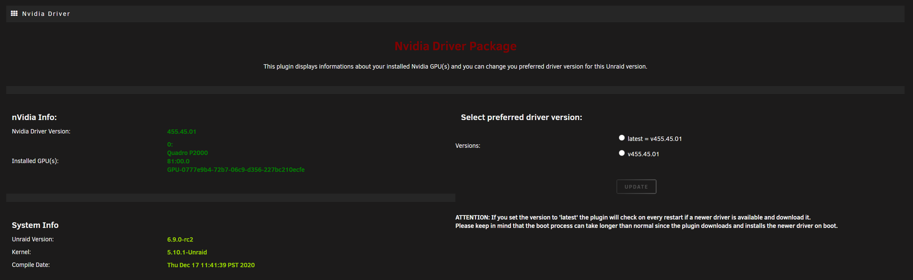

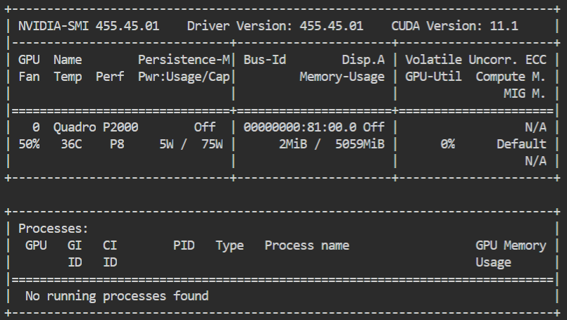

Running into errors trying to transcode with Linuxserver Plex container, unRAID 6.9.0-rc2, and an Nvidia p2000.
When transcoding via Hardware using Plex, the stream will hang on a black screen until timing out.
Have rebooted multiple times; enabled, disabled, and re-enabled hardware transcode in Plex; all containers are updated to latest versions.
The GPU also doesn't show up in the Dashboard tab, though I'm unsure if it's supposed to.
Edited by theradiostar
7 minutes ago, theradiostar said:
When transcoding via Hardware using Plex, the stream will hang on a black stream until timing out.
Can you also try to add the Nvidia Capabilities as mentioned in post two in this thread?
Can you eventually try to use the plexinc/pms-docker docker for testing purposes? For many people it solved the problem.
One thing to note your Card is correctly recognized and should work perfectly fine.
I will try that. Have tried both the Linuxserver and Binhex-Plexpass containers so far; same issue. I'll try plexinc/pms-docker and report back.

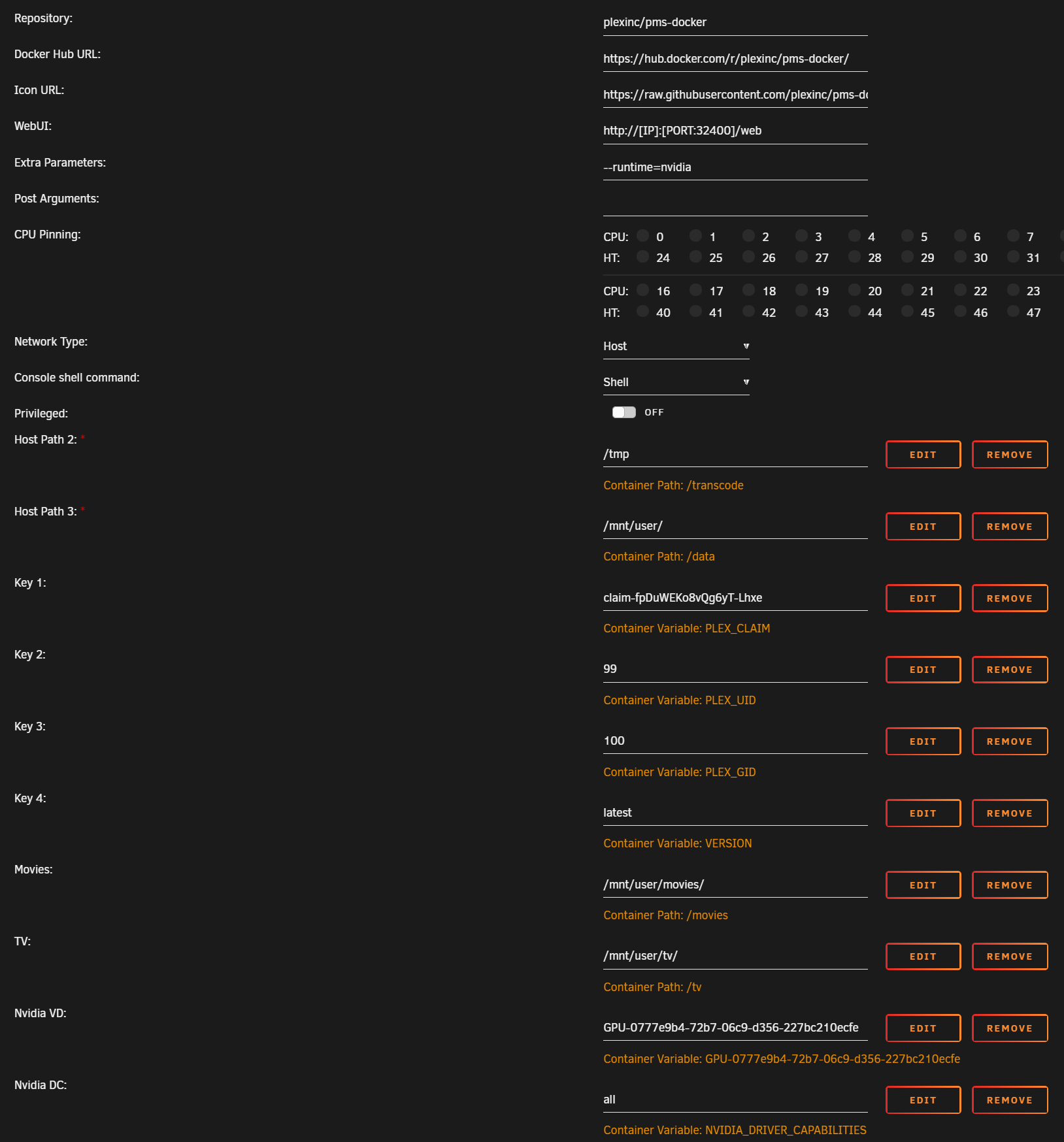

Trying with plexinc/pms-docker -- no dice, same problem.

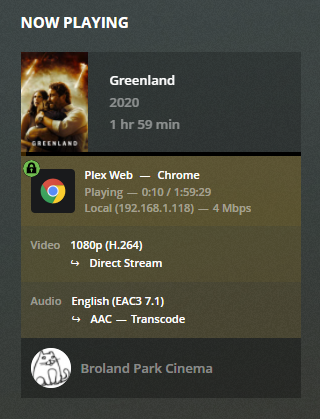

I started a direct stream, then changed playback to 720p to force a transcode. Plex Dashboard doesn't seem to recognize the resolution change, and the playback hangs at a black screen before eventually timing out.
Official Plex Media docker settings:

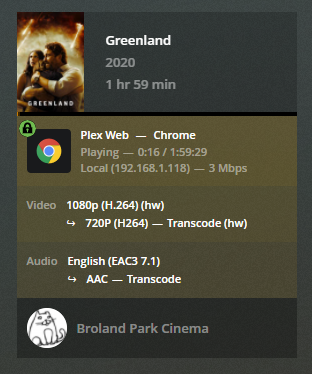

EDIT: I've managed to get it to attempt to use hardware acceleration, but it still hangs on a black screen.
Here's the specific timeout error:
Is direct play even working?
Can you try to disable HW transcoding in general and try if you can transcode the file in software to let's say 720p?
EDIT: Does the transcode with the P2000 ever worked? If so on what Unraid version where you before?
Yes; direct play works fine, as does software transcode.
The P2000 is new, so it's possible there's a hardware problem with the card itself. How would I test that?

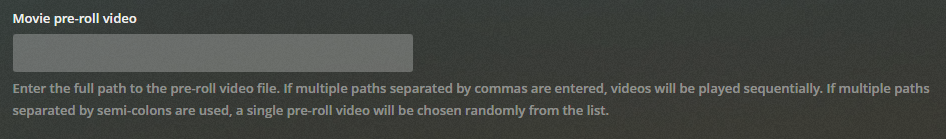

27 minutes ago, theradiostar said:
plz try this: "Clearing the Movie Pre-Roll Video field under Settings > General"
and take a look in the Server Logs under Setting -> Consols. Maybe it is a corrupted Database
Edited by sonic6
My server doesn't run any pre-roll; if this is the field you're talking about, it's clear:
