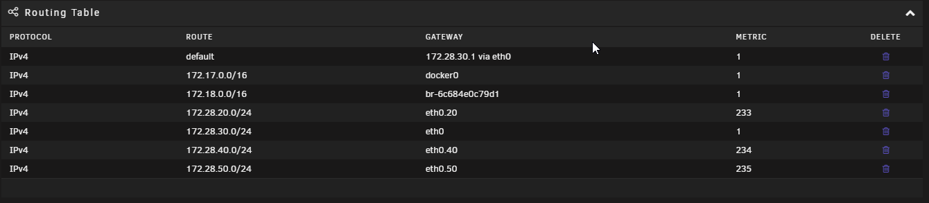

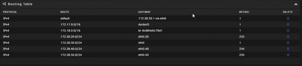

What did your routing table look like before. I am having almost identical issues as you. Same subnet and transfer is fine. Different subnets and transfer works for about a few seconds but then dies. I looked at my routing table and I had a bunch of default routes I had to clean up. Looks like they were auto generated with the VLAN interfaces. Unfortunately even after cleaning everything up I am still having the same problems as you. I'll attach a screenshot of my routing table. Maybe another set of eyes on this may give me a clue.
2021-09-02 00_57_55-unraid_NetworkSettings and 32 more pages - Personal - Microsoft​ Edge.png
