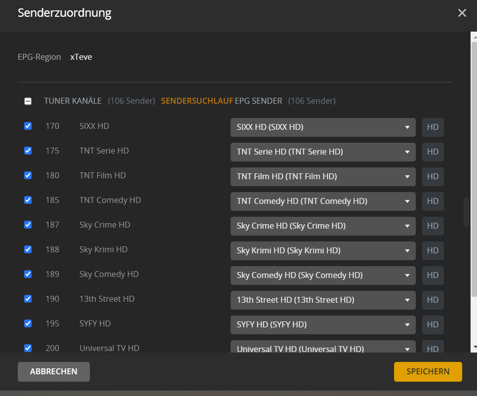

@ich777 Having an issue with plex. I updated the unraid os and switched to your dvb plugin. Now plex is not finding all my channels. Im using the winquadhd tuner. Was working fine before. I tried to search through this thread but i didn't see anything about this issue. Thanks

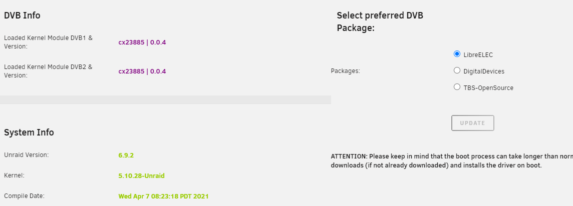

The card does show up in the plugin page, it used to show up as lg and now it doesn't. I am using the LibreELEC package
Looks like everything is showing up correctly, have you passed through /dev/dvb to the Plex container?
The only thing that I can imagine is that the newer driver version from my plugin is messing up something in Plex...

I tried tvheadend and it does show up and has more channels show up in the scan(not all but im still a little unfamiliar with tvheadend)
My best uneducated guess is that its not searching right in plex. Almost like its not using the right channel type.
I put in an hdhomerun that picked up every channel
Thanks
From what I know you need a really good EPG reader so that it works flawlessly in Plex, if I remember correctly @alturismo recommended to use TVHeadend for the TV channels and then import them in Plex, please look at this post here:

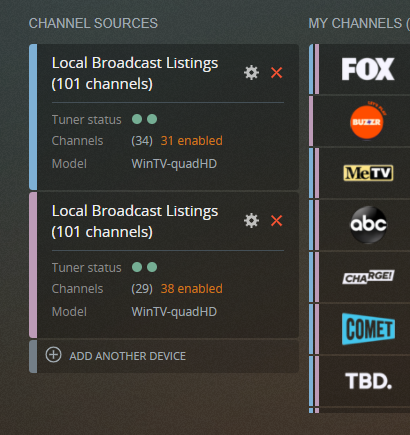

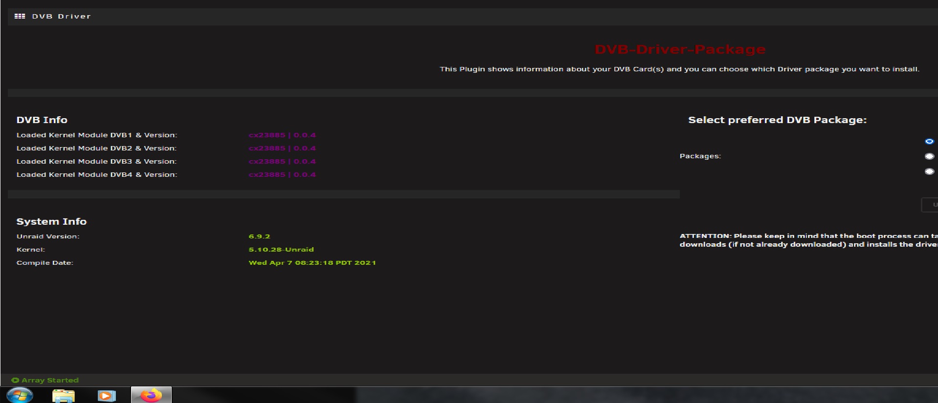

Having a new issue with Plex live TV and am trying to rule out what might be causing the issue.
I had everything working great until yesterday - the plugin worked great and I was able to get all my channels on Plex.
Yesterday I upgraded my Unraid box, moved the TV card (Hauppauge Quadhd) over and everything seems to be working fine.
When I checked on my Plex, some of the channels were missing. I am currently only getting 30-40 out of 60+ channels I was getting before. I tried to rescan the channels (didn't help), tried removing and reinstalling the plugin, but nothing is helping.

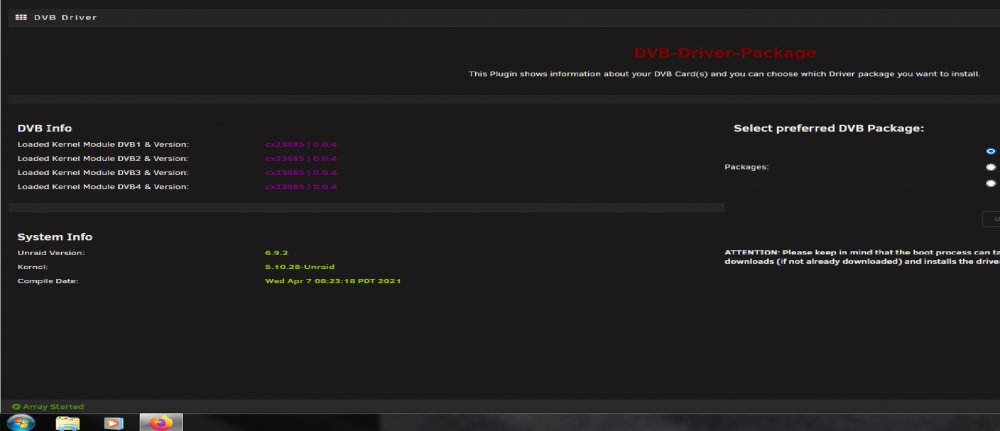

I am using unraid 6.9.2, the official Plex docker, and Plex does see the Tuners (the quad shows up as 2 separate tuners).
At the moment the plugin only sees 2 out of the 4 tuners, but I did see all 4 of them earlier this evening.
I tried setting up TVHeadend but was unable to get it to work. However it was able to see all 4 tuners.
The other part is that each tuner is seeing a different amount of channels even though they are both connected to the same antenna
As I said I am trying to rule out that its the Tuner or the Plugin. I.e. if the Tuner is seen in Unraid, and the Plugin can see the tuner, does that mean those are both working ok? I am suspecting it might be a Plex update, and that is going to be my next place to look.
Any advice on this would be helpful.
thanks
@Dchod about Plex and LiveTV ... its still not really the best option therefore, nevermind now, as its basically working inside Plex may as note, no EPG Data for a channel means no Channel, so may start try to refresh EPG in 1st place if that helps.
what do you see when you click on the available channels ?
are the "missing" ones may still there but greyed out ?
in the end, as soon the tuners are there and working, its basically a plex thing, you will get further by debugging (logs) and ask in plex forums therefore.
Best crosscheck is to look if a tv server like tvheadend can see and use the tuners, if so, tuners are fine.

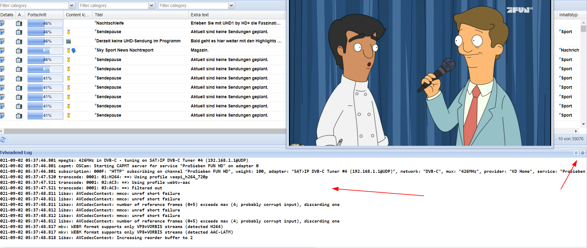

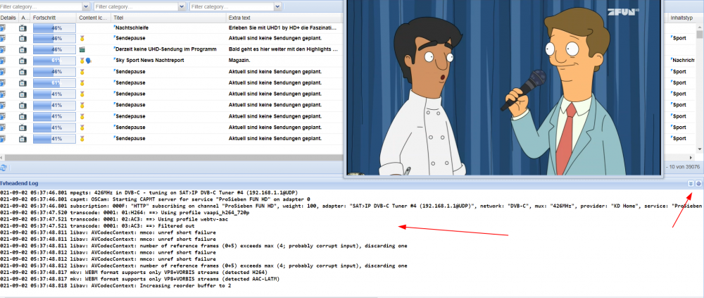

i saw this behaviour on dvb-c as sample when a channel is "scrambled", but i guess you have tested FTA channels too
i dont use dvb-t(2) at all, only dvb-c and -s here, so hard to tell, may also take a look at the tuner card settings what setup may is open there for the card, network, network type, broadcast type, etc ...
what does tvheadend report in the debug window ?
you should see some errors there etc ... and there is may the startpoint whats wrong.
