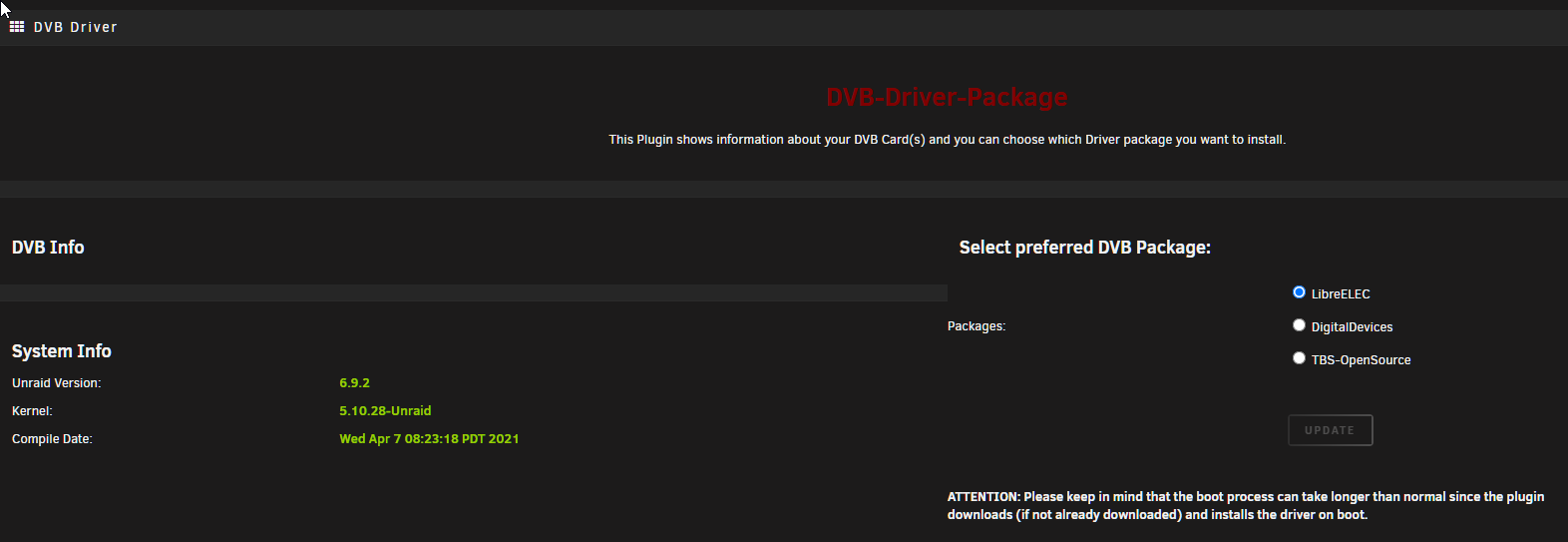

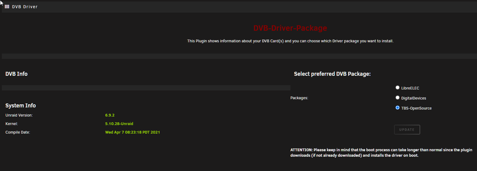

Changed the drivers, still no luck:
I disabled the PCIe ACS override now and switched back to the TBS OS drivers.
Rebooted - Card still not recognized.

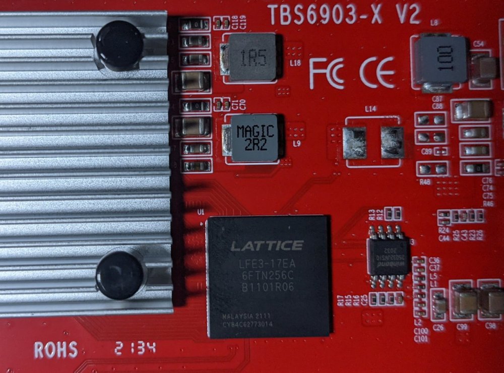

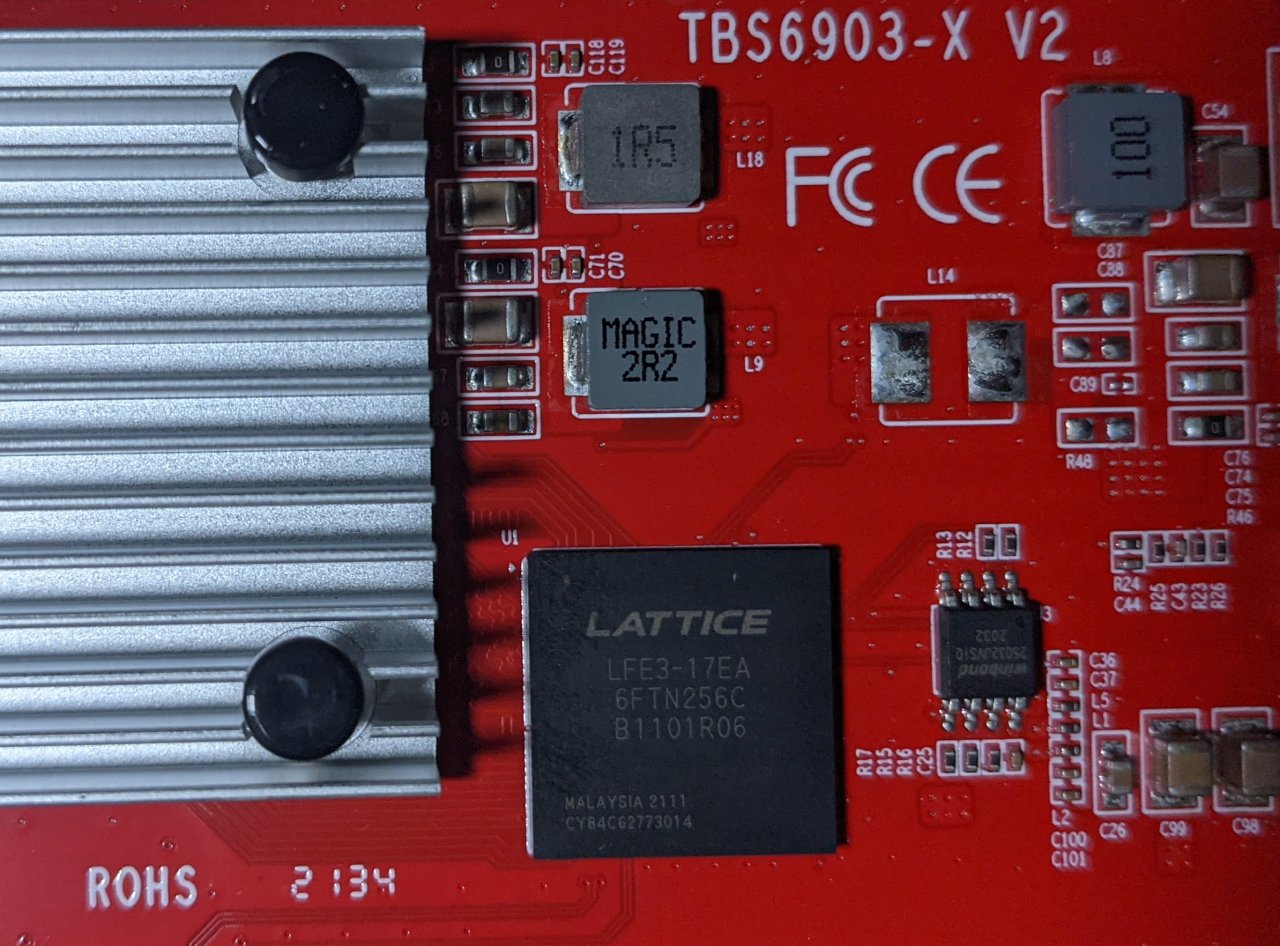

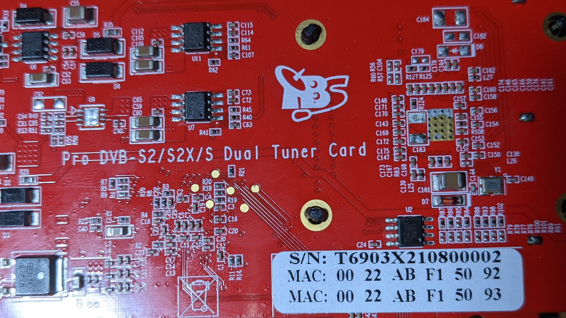

What about forcing the driver to load via modprobe?
Unfortunately I couldn't find out on which chip this card is based.
Thank you for your help in advance.
That's also my problem, can't find any useful information about this... and without knowing what exact chip is on this card it's really hard to insert a module...

Can you also please tell me which version the card is? A sticker on the back of the card should say what type and version it is.

Am I allowed to post the submitted picture on Github, of course with the serial numbers removed?
Posted it already with the serial numbers removed.
