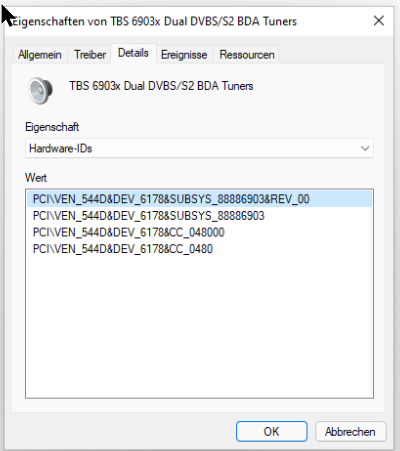

Can you please do me a favor and bind it to a Windows VM and see with which device ID it is recognized there?
In favor to this comment on Github: Click
Is this what you mean?:
Yes, many thanks!

May I ask for another favor?
Have you got another machine where you can try the card and see if the subsystem PCI ID is the same as in your server?
I'm really curious about this because the subsystem PCI ID is not like in your system 8888

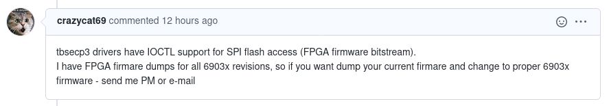

I just had a Phone Call with TBS distibution in Germany to clarify what the problem with this card is.
And indeed, they already knew about the issue.
There has been a mistake in the firmware flashing with the last productions series of theese cards.
As the very friendly guy at TBS could see by the serial number of my card, my card was the second in this series of cards with the wrong hardware-id.
He told me, that there will be a new driver with this hardware-id included. Perhaps there will be also a firmware update, that corrects the id. But this is not sure atm.
If you are interested, crazycat69 posted this on the Github issue, maybe you can fix it yourself if you are interested:
I think, that would be nice, especially according to upcoming unraid updates.
With the right Hardware-ID, there would be no need to build special drivers for any new unraid version.
I am on a business trip until Monday, so if anyone gives me instructions how to do it, I am willing to flash the firmware next week.

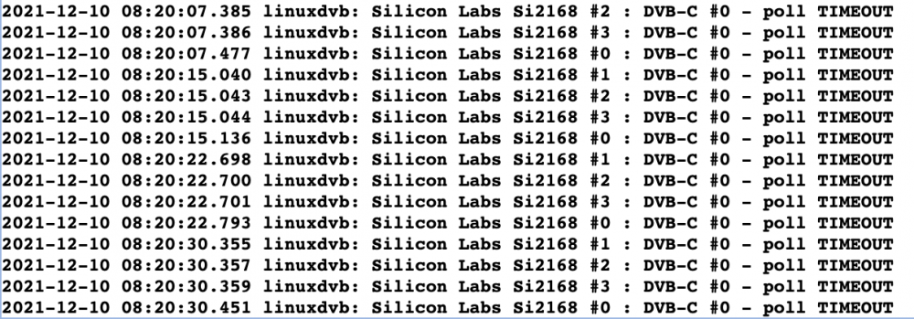

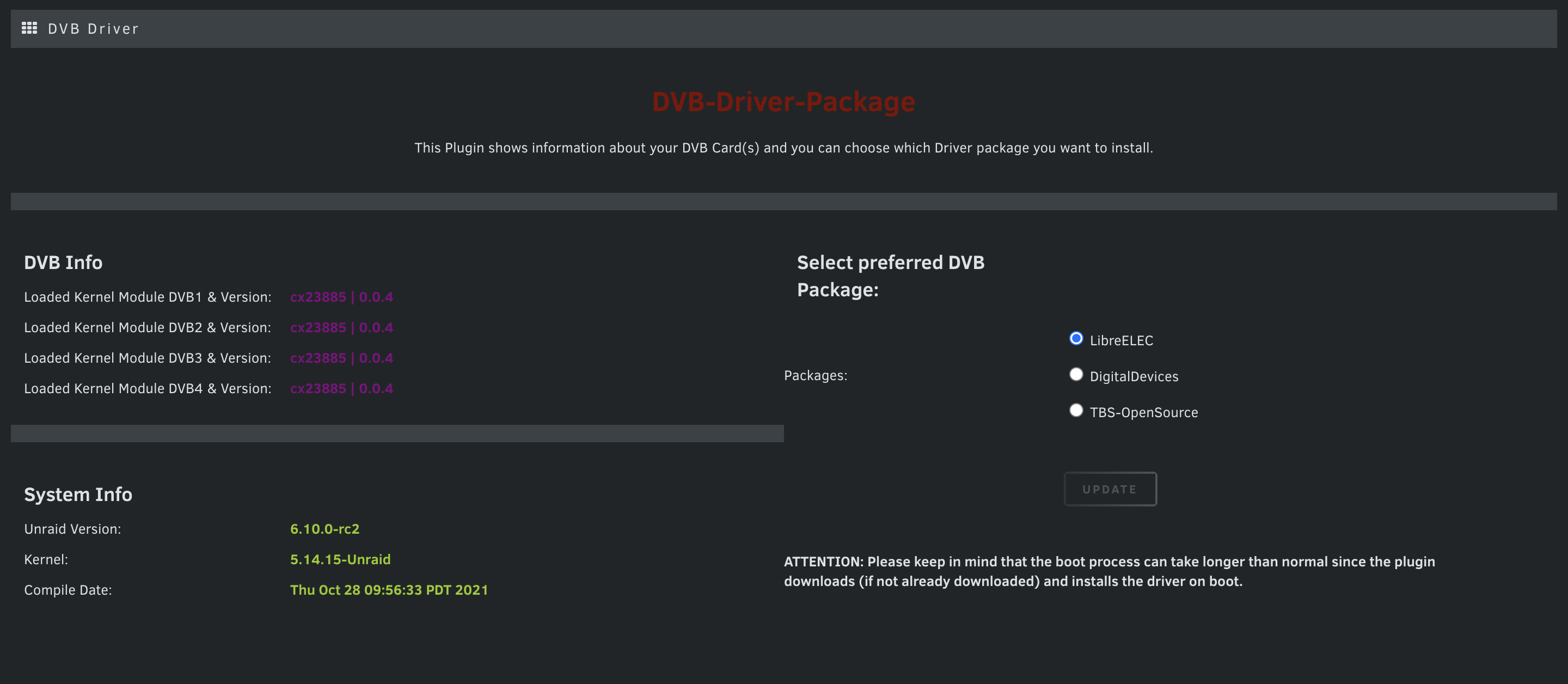

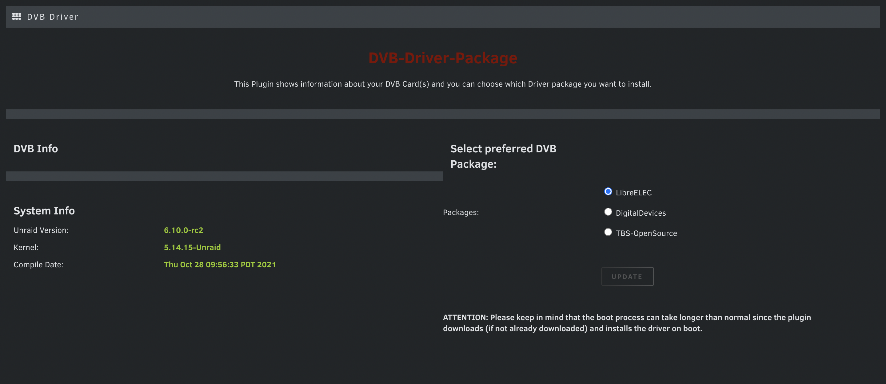

I am currently trying to set up my "Hauppauge WinTV QuadHD" DVR card using LibreELEC drivers. Upon server startup the card gets recognized and passed through to TvHeadend correctly. However, after sitting idle for some time I am unable to connect to any of my streams and the card no longer shows up in the Plugin as well.
Pastebins taken before restart (card idle):
https://pastebin.com/JXSxZwek
https://pastebin.com/0Ng3v0LB
https://pastebin.com/fjAkT3HG

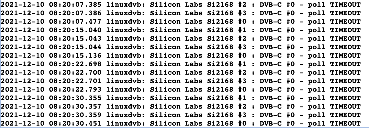

Also, my TvHeadend log is full of "Poll timeouts" (see attached screenshot).
Currently running 6.10rc2.
Any idea what might be causing this? Is the driver not compatible with rc2?
Please paste pictures or logs directly here into the forums by pressing CTRL + V or by putting the logs in a file and dropping them here in the text box.
If your card is recognized and working for some time the driver is working, something else causes this.
Was it working before on older versions on unRAID, if yes, have you changed anything to the system (BIOS Updated, installed new hardware,...)
Please post your Diagnostics.

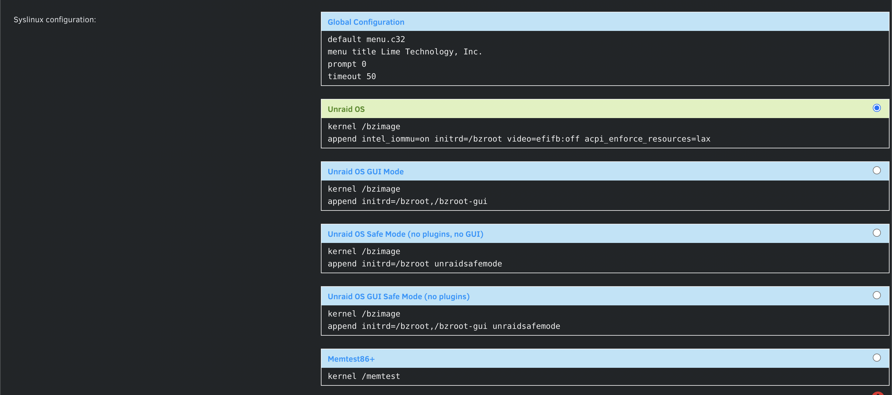

What I have done are some changes to my Syslinux configuration (see screenshot).

Do you need all those options in your syslinux.conf:
intel_iommu=on video=efifb:off acpi_enforce_resources=lax
Maybe try to start removing them, I think you are using efifb:off to pass through the iGPU to a VM? I would also recommend to not use acpi_enforce_resource=lax because this can actually cause issues and maybe damage the hardware if something is accessing your system wrong...

Do you need this too in the syslinux.conf:
intel_iommu=on
I remembered what I needed this for. The "Dynamix Auto Fan Control"-Plugin. Without that line I can't let the plugin control the fans. The PWM-controller doesn't show up. But that's another topic.
Yes, I know, but I really don't like that people doing that. With this option software can actually damage hardware...

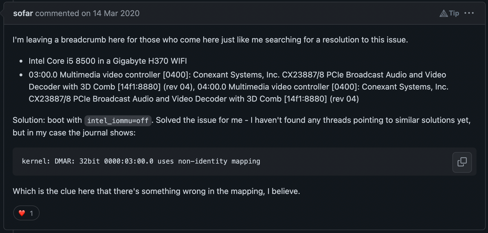

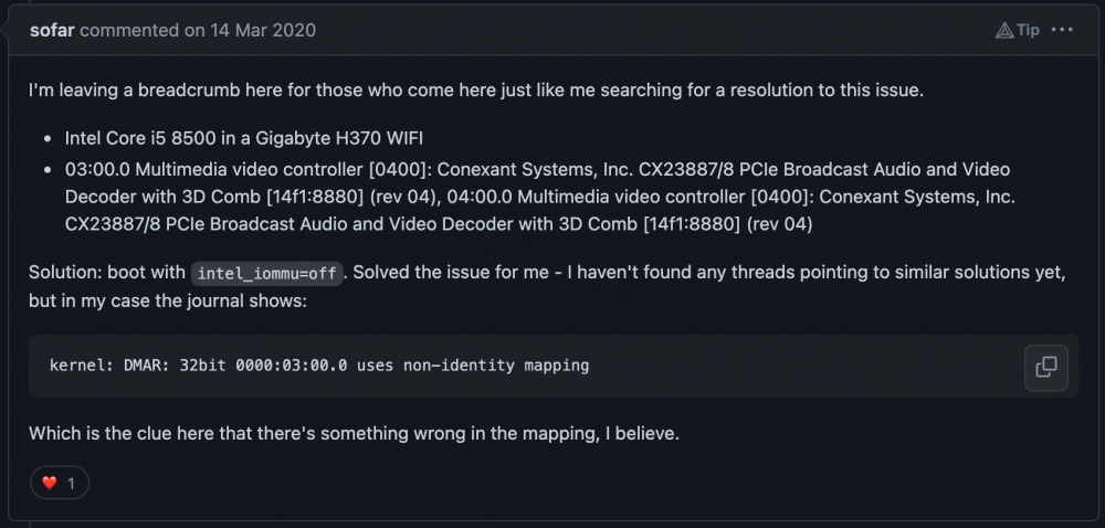

For the first solution:
I think you have the exact opposite from it since it tells you to use:
intel_iommu=off
(but this should not be the solution to your issue I think)
For the second solution:

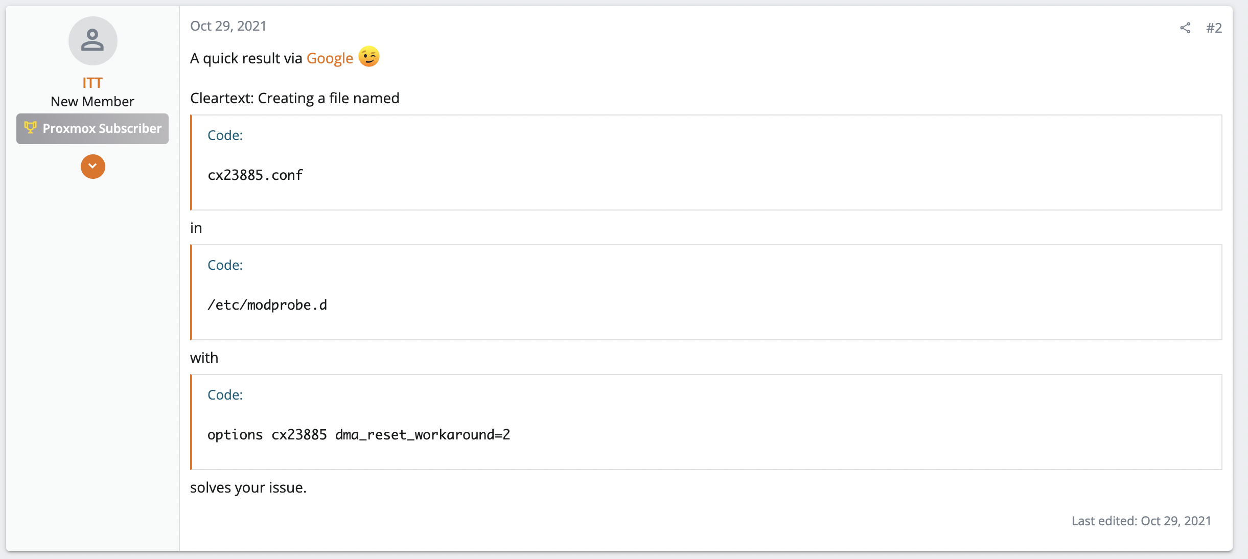

You can do that on unRAID too if you add this to your syslinux.conf "cx23885.dma_reset_workaround=2", like in this screenshot:
EDIT: Sorry for not seeing that earlier, you are booting with UEFI or am I wrong?
Can you try to boot with Legacy (CSM) Mode? Maybe that solves the issue.
Will give it a try and report.
However, this seems to have done the trick! The mpeg-error does not longer show up in the syslog. DVB-card works too. Let's hope it stays that way.
Nonetheless, thanks a lot for helping @ich777 ! Enjoy the weekend.
