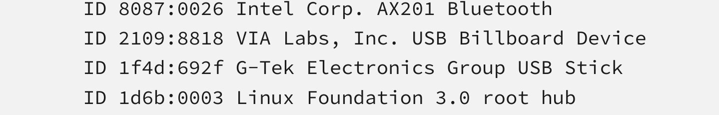

1 hour ago, evilgenius said:
I mean it shows up in device list as gtek. So it is seen by unraid yeah?
A company that males a webcame with the device name TheBestWebCam will also show up there as TheBestWebCam but it won‘t work unless there is support for it.

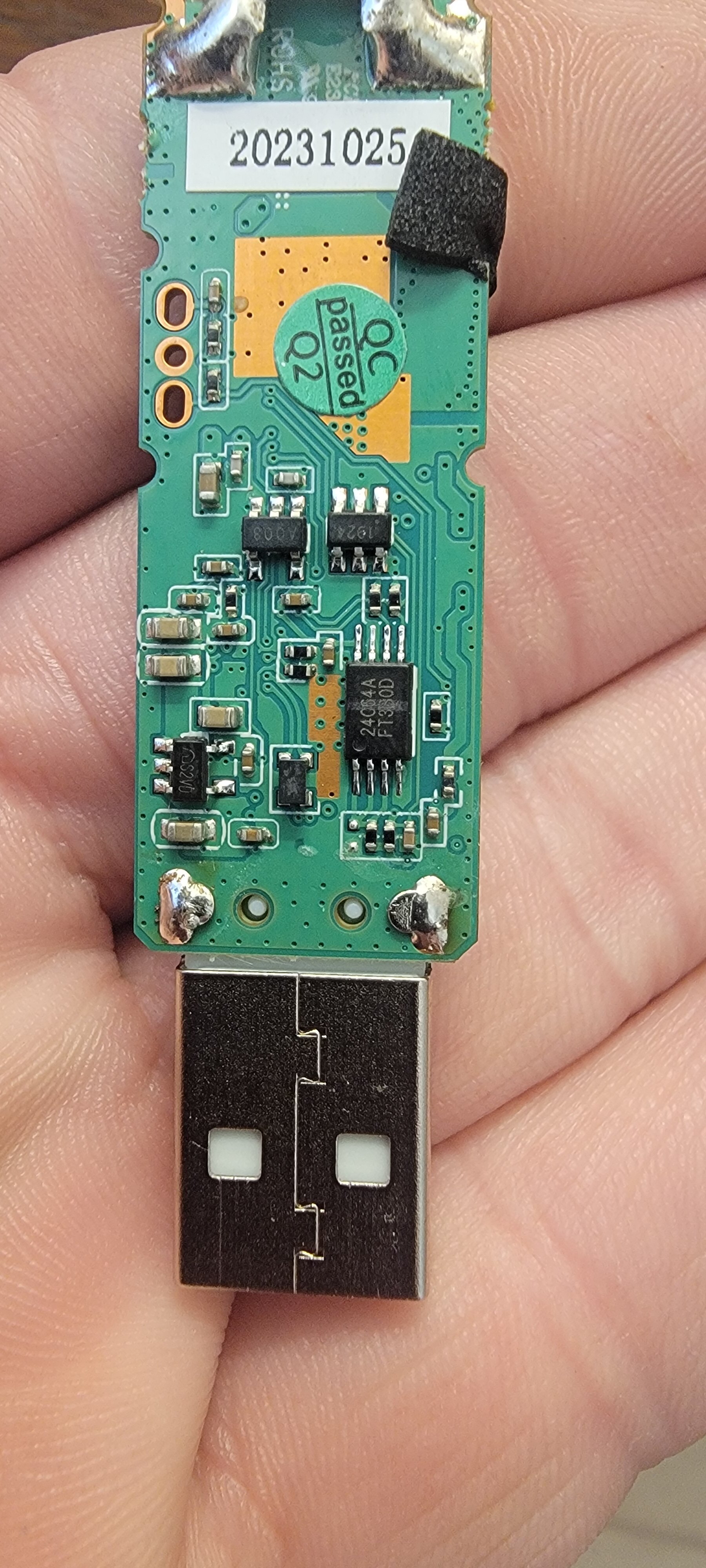

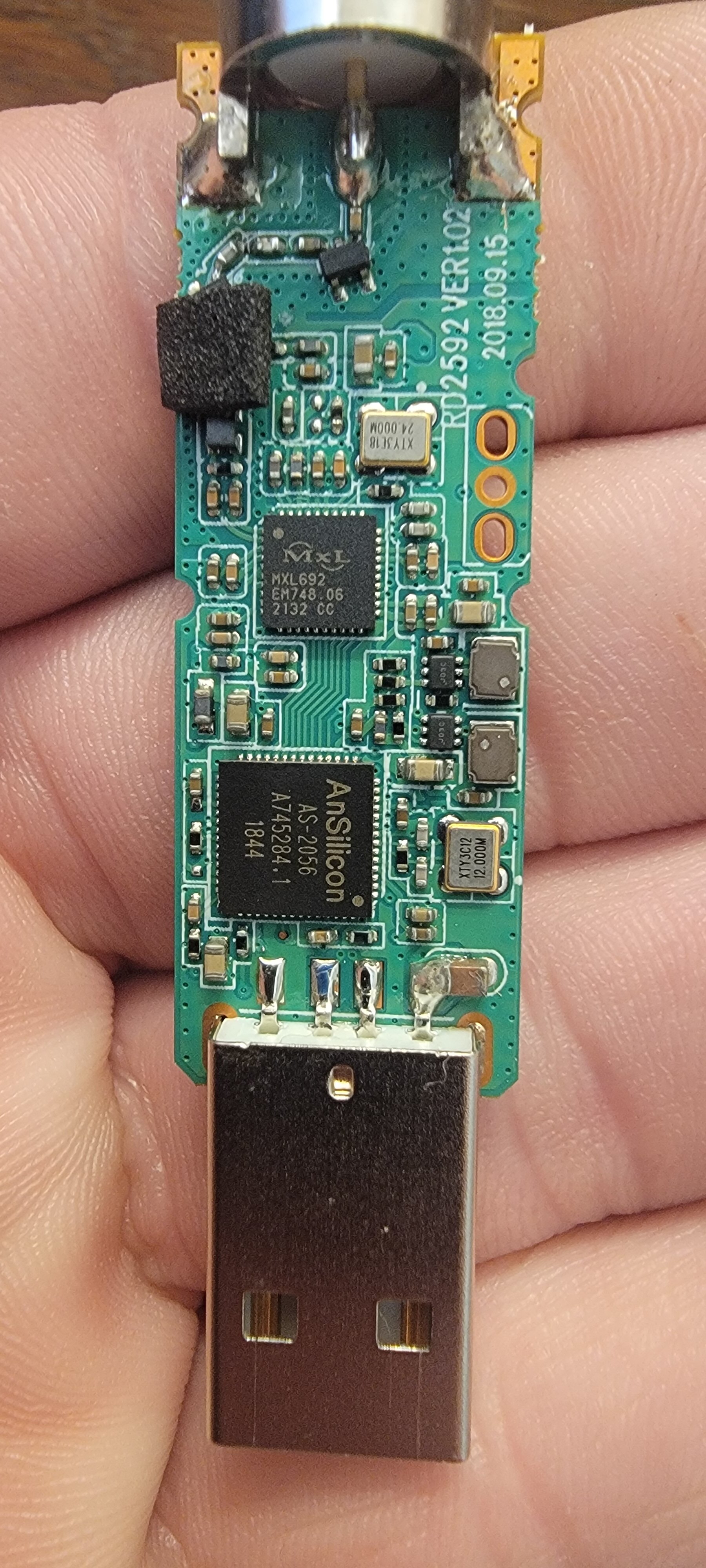

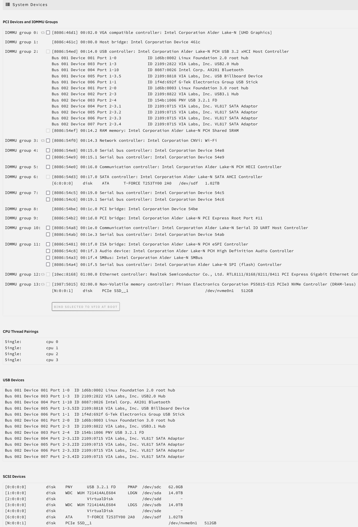

Here ya go.
MXL692 is part of the LibreELEC Package however I can't tell why it's not recognized, I really don't know what this AS-2056 chip is because the MXL692 is just the demodulator and not the tuner.
You could try to do:
modprobe mxl692
If the device is not working afterwards it is simply not supported. Sorry...

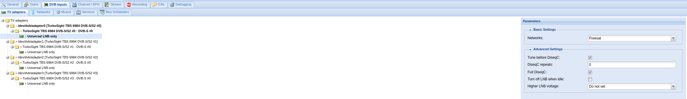

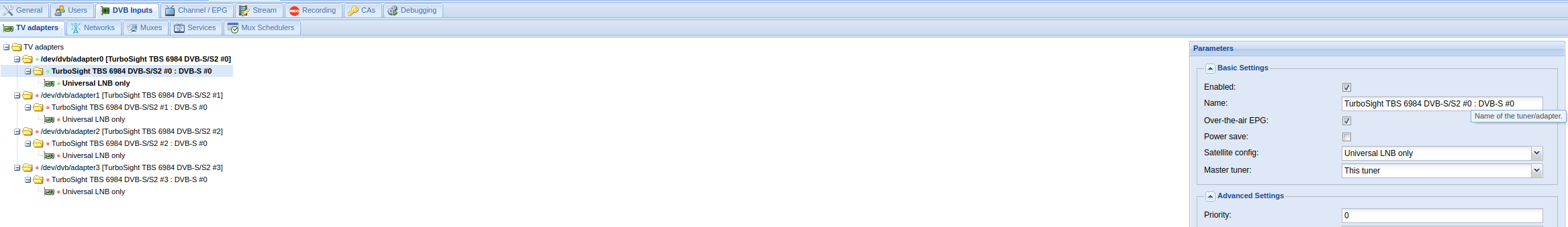

1 minute ago, fireplex said:
Apologies, probably shouldn't have used the grep as I see other errors now which may mean my card doesn't have that chip...
From what I can see in your Diagnostics everything should work fine.
Is this a new instance from TVHeadend or is that the old existing one?
Please make sure the tuners is enabled and properly assigned to a network:
This message is usually a indication that something is not configured properly in TVHeadend.

1 hour ago, fireplex said:
Yes, this is a fresh install of TVHeadend with a new appdata.
There is maybe a simple configuration step in TVHeadend missing, if you search for out of range here in this thread you'll see a few posts which the most of where misconfigured TVHeadend instances.
Maybe something at the network is wrong, however it seems the card is working properly.
