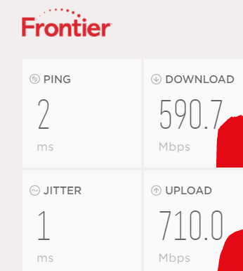

The reason I mentioned it may be unraid's how it handles connecting to external network, is because my VMs would get 350 mbps on speedtest whereas my desktop gets 750mbps (even though my desktop is actually further from the router.
4 minutes ago, takkkkkkk said:
were you maxing out the LAN connection or external network? what was your bandwidth?
External, on a 1Gbs link pulling between 60 and 70MB/s. Running an external speedtest from my VM is actually faster than my desktop lol
Desktop left, VM Right:
image.png.7a6ee382cf83bd0fbb75f79ed3df26cd.pngimage.png.70712e9d599b3af9fb731488ac0ef974.png

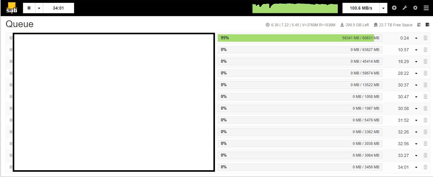

I don't know if this will help, am doin the newb struggle myself and loving every second of it learning Unraid...
I was also getting a max of 30ish MB/s in SABnzbd no matter what i did. The solution I found was a config error I over looked when setting up the news server.. Default this is set to 8. My provider allows 60. Once set to 60 I get my full and sustained 100MB/s ...
I know this is an old original post but I hope someone new like me that is just learning finds this and it is the solution they need.
Bro thanks so much, that fixed it for me as well.
