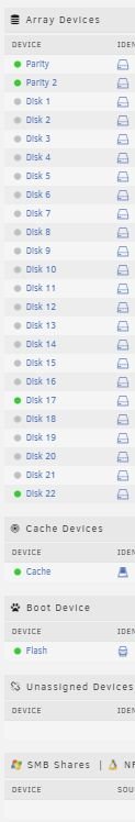

The registration page tells "27 attached devices". My main page shows 24 hard drives plus 1 cache and 1 flash device. In the past I had a cache pool of two devices, but after a crash one of the pool devices is dropped off and no longer available. I did reboot after the crash and now I'm running a single cache device. Is Unraid still counting the removed cache disk?

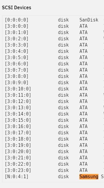

The removed device was part of the cache pool. As you can see in the images above the cache pool is not degraded, the device is not emulated. The device is no longer there. It's not listed in the SCSI devices on the System Devices page.
I usually don't care because I hold 5 or 6 Pro licenses for 3 machines. It's just something I'm interested in. Even with the missing device counted in, the result would be 24 array devices + 2 cache devices = 26 and not 27.

At boot time and besides the OS flash drive these were also connected:
Nov 12 17:28:17 Tower kernel: scsi 1:0:0:0: Direct-Access     Kingston DataTraveler 2.0 1.00 PQ: 0 ANSI: 4
Nov 12 17:28:17 Tower kernel: scsi 2:0:0:0: Direct-Access     JetFlash Transcend 16GB   1100 PQ: 0 ANSI: 6
They were since removed, but they still count until you reboot, or maybe until array re-start.
