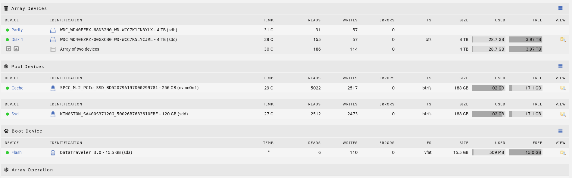

I use unraid version 6.9.0-beta35 and have two different pool devices, but they show same info. That seems strange. I try to use 120GB ssd for only one VM image, but currently can't do that because of this strange behavior.
Very possible that I have done something wrong.

system/btrfs-usage.txt seems to indicate both devices are in both pools.
system/df.txt seems to indicate cache pool isn't mounted but ssd pool is.
and shares show several that are on cache and disk1 and ssd.
So, pretty mixed up.

Sure.
First I created disk 1 & parity.
Second I added a cache, nvme drive.
For weeks I did not use the ssd, it was just powered, but not actived on unraid (pool or array).
Yesterday I added a second pool for that ssd, because I need it for my Windows VM.
What do you mean by "require a do over".
Backup my VM and reset unraid and start from clean table?

You'll need to remove one of the devices from the pool, there are many ways to do it, easiest is probably to assign both to the same pool and then remove one of them, note that you need to reset pool config first or it be wiped, this should be straight forward but make sure anything important is backed up before starting.
Stop the array, if Docker/VM services are using the cache pool disable them, unassign the cache devices from both pools, start array to make Unraid "forget" current cache config, stop array, reassign both cache devices to the same pool (there can't be an "All existing data on this device will be OVERWRITTEN when array is Started" warning for any cache device), re-enable Docker/VMs if needed, start array, now do a standard pool device removal and when done assign that device to the new pool.
