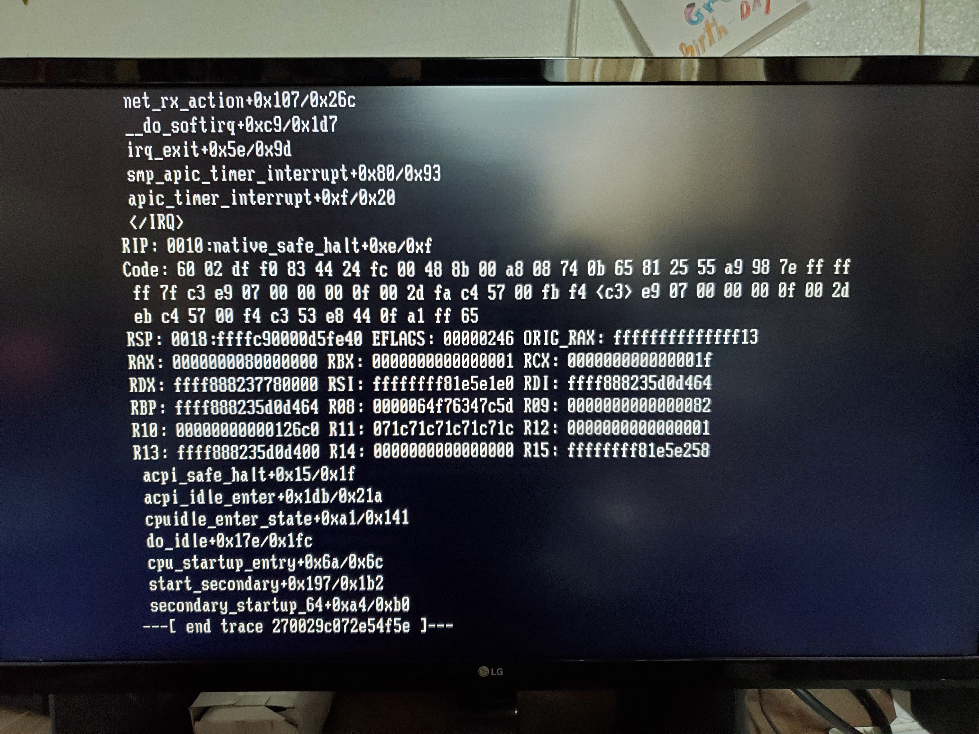

Has been working great for months, and now it's starting to crash randomly. I have the attached pic from the monitor that is connected to it when it crashes.  Any ides?

You should post your system’s diagnostics zip file (obtained via Tools -> Diagnostics) so we can see the current state of your system which might help with getting informed feedback.
diagnostic steps you might want to try:
  • Boot in Safe mode to stop plugins being run in case one of them is causing your problem
  • disable docker and/or VM services in case one of them is causing a problem.    If that does seem to stabilise the system then they can be progressively re-enabled to try and identify the guilty party.
So I opened it up and reseated the sata cables just in case and swapped out the power supply to a newer one and it seems stable for now, before that I was getting a lot of hard resets on a one of the sata drives
