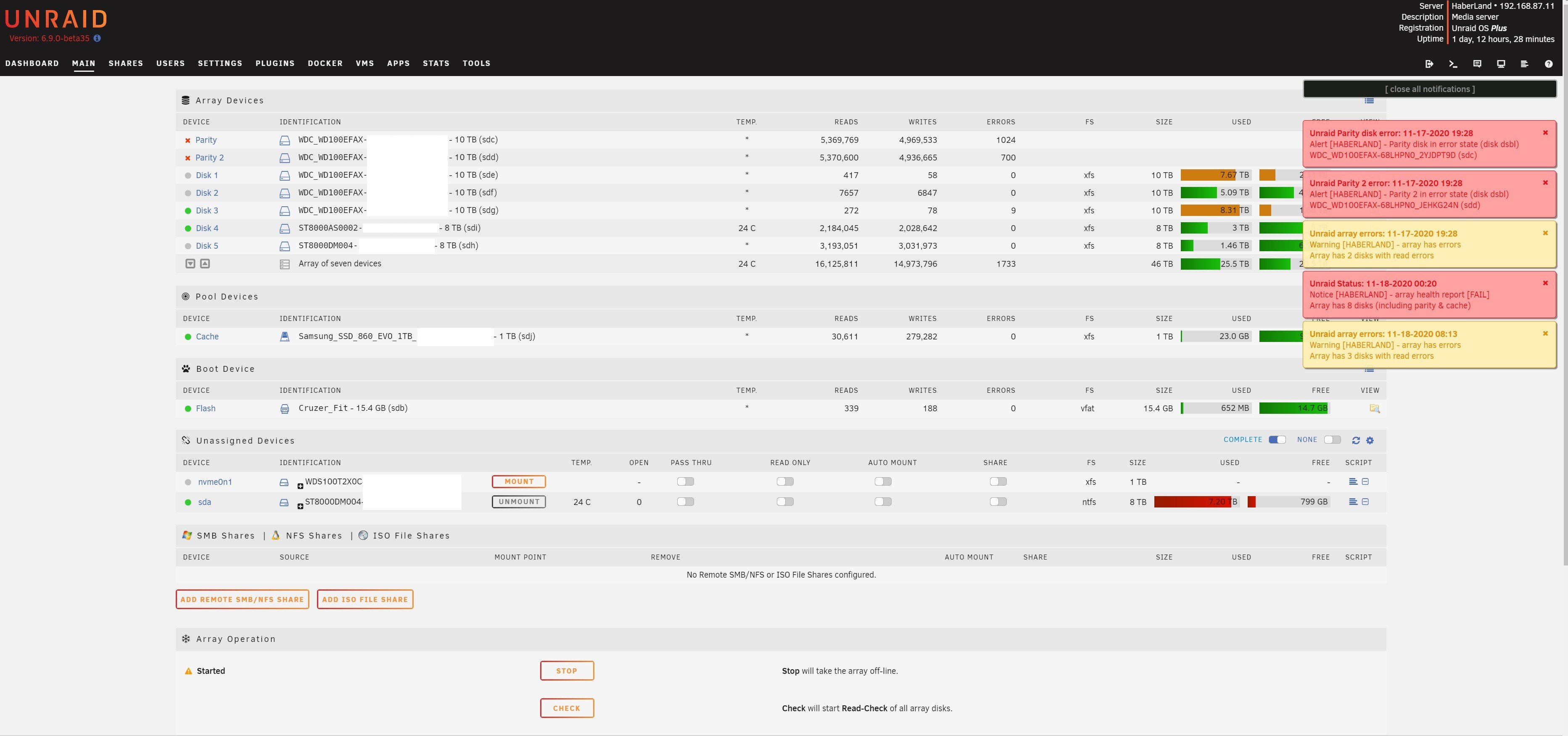

Just woke up and found my server down :(.. I have not restarted it or anything because I was afraid that may make things worse.
FYI, I was using an external HDD in "Unassigned Devices" via DOCKER Krusader to transfer 6.6TB to my array. It was going to take about 3-days to complete. I was on day 2, about 30-hours down and when I woke up, this is what I see.
Any help would be appreciated.
haberland-diagnostics-20201118-0811.zip
Edited by NotHere
Connection issues on multiple disks. Check all connections, power and SATA, both ends, including splitters. You will have to rebuild both parity of course.

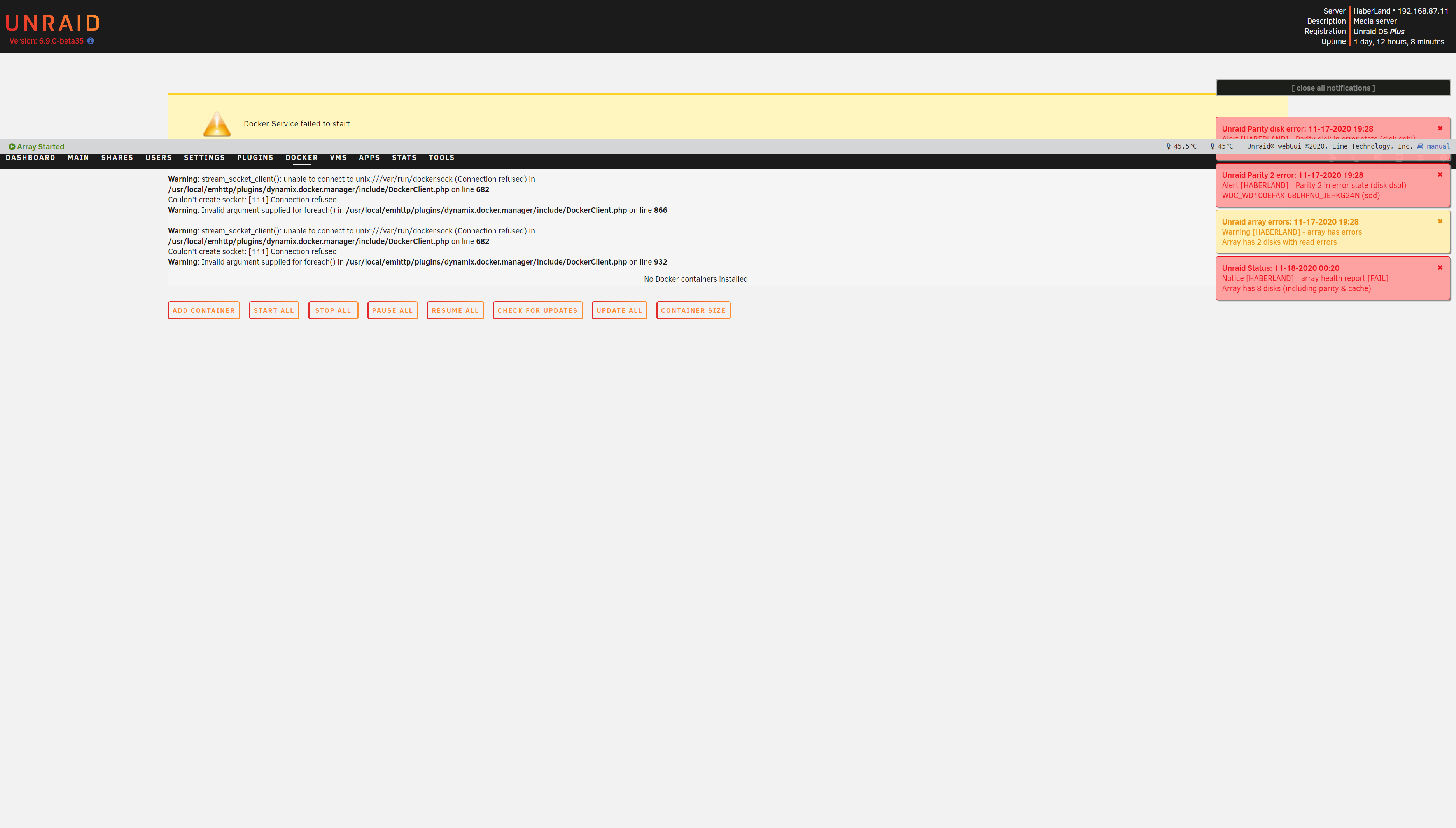

Perhaps more troubling is your cache appears to be mostly empty and appdata, domains, system shares aren't showing up in diagnostics. And corruption on both /dev/loop devices (docker.img and libvirt.img) which are configured to be in system share so those will have to be recreated after you get your hardware square.
Another possibility for multiple disk connection problems is controller or power issues.
Problem with the onboard SATA controller:
Nov 17 19:26:06 HaberLand kernel: ahci 0000:02:00.1: AMD-Vi: Event logged [IO_PAGE_FAULT domain=0x0010 address=0x9195e000 flags=0x0000]
Quite common with Ryzem boards, though it usually works mostly OK with the latest Unraid betas, look for a BIOS update for your board, or disable IOMMU of not needed.
