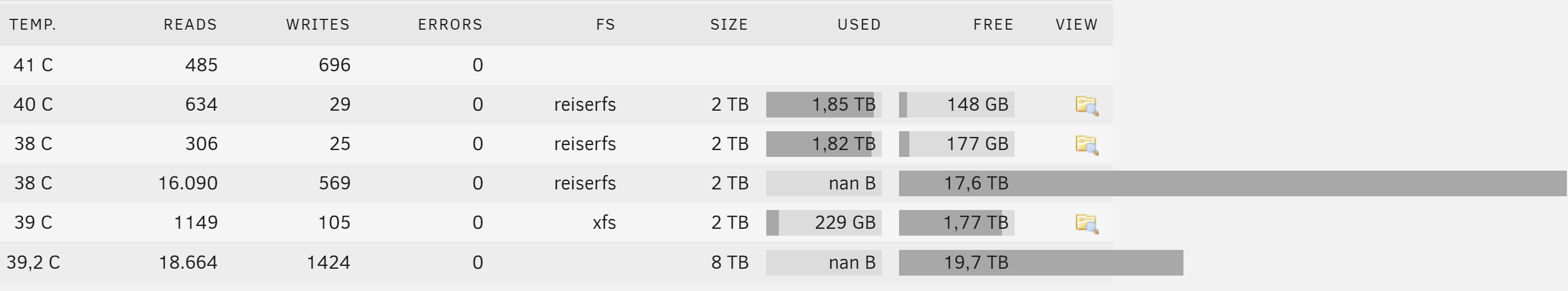

I've been running Unraid for years without a single problem, currently using version 6.8.0. A few days ago I started receiving email alerts that disk3 was full (100%) but was not able to look into it since I didn't have access to the server for a few days. I figured it will just assign new data to the other disks (there is plenty of space left on at least one drive).
When I managed to get access to the UI I logged in and found this:
So I logged in on the server and `df -h` shows this:
Filesystem Size Used Avail Use% Mounted on
rootfs 3.8G 985M 2.9G 26% /
tmpfs 32M 480K 32M 2% /run
devtmpfs 3.8G 0 3.8G 0% /dev
tmpfs 3.9G 0 3.9G 0% /dev/shm
cgroup_root 8.0M 0 8.0M 0% /sys/fs/cgroup
tmpfs 128M 224K 128M 1% /var/log
/dev/sda 7.3G 611M 6.7G 9% /boot
/dev/loop0 9.0M 9.0M 0 100% /lib/modules
/dev/loop1 5.9M 5.9M 0 100% /lib/firmware
/dev/md1 1.9T 1.7T 138G 93% /mnt/disk1
/dev/md2 1.9T 1.7T 165G 92% /mnt/disk2
/dev/md3 1.9T -15T 16T - /mnt/disk3
/dev/md4 1.9T 214G 1.7T 12% /mnt/disk4
/dev/sdb1 56G 50G 6.1G 90% /mnt/cache
shfs 7.3T -11T 18T - /mnt/user0
shfs 7.4T -11T 18T - /mnt/user
/dev/loop2 60G 26G 31G 46% /var/lib/docker
shm 64M 0 64M 0% /var/lib/docker/containers/.../mounts/shm
As you can see my disk3 is reporting as -15 TB used and 16 TB available. The mover doesn't like this, and it had been invoked probably with this information and was stuck so and I couldn't do anything but force a shutdown/reboot.
Is there anything I can do to recover disk3 and get it back to reporting it's original used/free space?

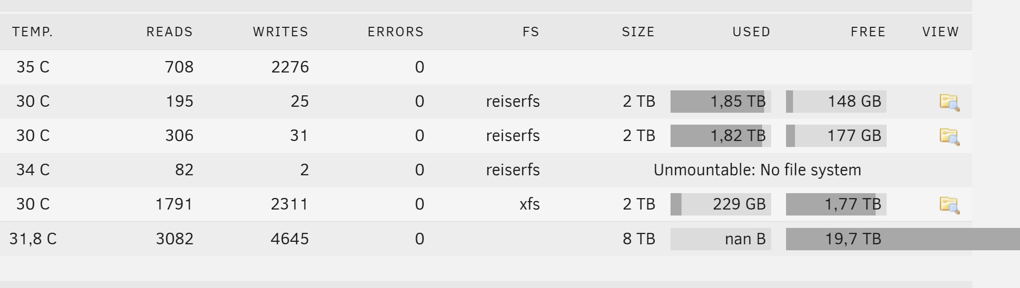

This is what it looks like after trying to start the array now:

Is there any way the data on the disk can be saved at all, can I replace the slot with a new disk now or is it lost?
The largest files on the drives are around 1-2 GB.
Though I never tried it I would guess best bet would be to clone that disk to a larger one with dd, then manually resize the partition, then run rebuild tree again, that should work.
Sounds like a plan.
Can I use an external USB HD as a clone target? I don't think my cabinet has any more free SATA connectors, and 2TB is max/partition drive size.
Yes.
Thinking more on this not sure resizing the partition will be enough, might also need to resize the filesystem, you should be able to do that by recreating the superblock after the partition is resized, but try just the partition first and post back.
Thanks for info. I'm gonna try tomorrow, gonna do the dd command first since that seems fairly straight forward (making sure the correct target device is selected :)). Do I need to format the external HD before running dd, if so should I format it as reiserfs then? I'm not sure I want to include it to the Unraid array, just want it as a temporary clone target.
I'm probably gonna go with a 4 TB drive.
No, just need to run dd.
1 hour ago, project6 said:
Unraid choose to keep writing to disk3, being close to max capacity, although it had disk4 available which only used 200 MB of 2TB
Includes / excludes and split level would also have to allow it to choose disk4.
