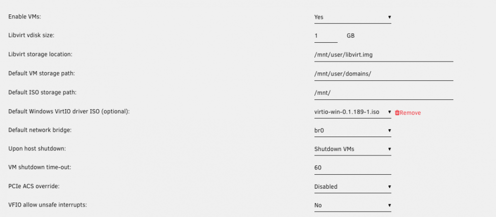

Hello,
Having this issue, Could anyone help?
Diagnostics
Ive looked up with other uses having this same issue is due to the file / incorrect location. Im trying to set it up and have only basic knowledge.
The Default iso storage path looks wrong - the location /mnt/ is not a valid location as that would be in RAM
And /mnt/user/system/libvirt.img
On mobile now so can't look at Diagnostics yet
Probably other things need some work to get dockers and VM paths optimal
