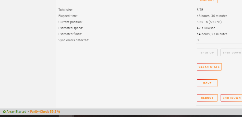

Parity check is running,

It's a parity check?
Are you asking me? If it's a parity check then please post diags.
No, again Sorry for the confusion.
It says that it is a parity check.
But then again I have proven my ignorance quite well when it come to this system.
Dropped a new diagnostics just in case.

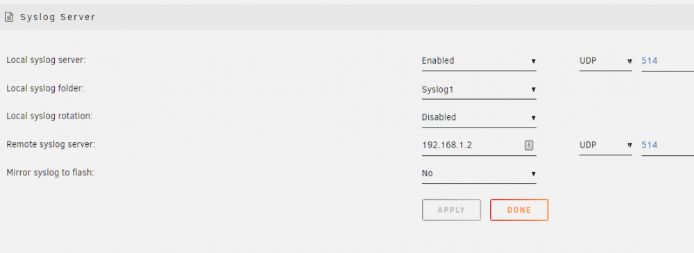

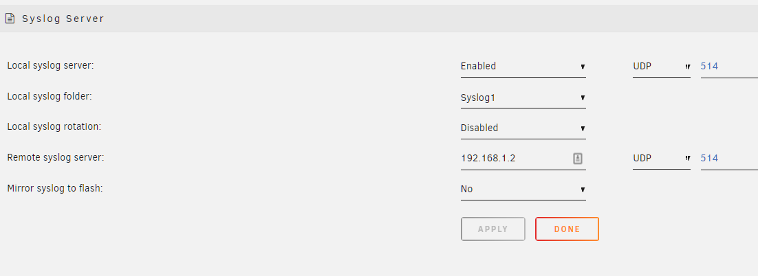

Unfortunately diags after rebooting are not much help, you can try this.
I followed the directions. I created a syslog1 share, set it up as preffercache and set the local syslog to that folder. I set the local ip as the server and clicked apply. the directions say that I should find a file in the folder immediately called syslog-192.168.1.2.log. I check the share and it is empty.
What did I miss this time.
Thanks again
I forgot there's currently a problem with the beta and this, it should be fixed on the next one.

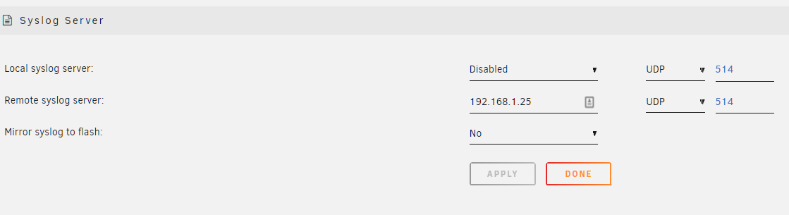

Does the remote server have to be local, can I use my remote machines swag address? server.xxxxx.net?
I downloaded kiwi syslog and dropped it onto my windows desktop, set it up and tested the folder, it passed the test.
I setup syslog in unraid
But nothing is populating in the external folder.
This is the latest accessing system log via tools menu
Nov 26 11:15:23 Tower ool www[16725]: /usr/local/emhttp/plugins/dynamix/scripts/rsyslog_config Nov 26 11:15:25 Tower rsyslogd: invalid or yet-unknown config file command 'UDPServerAddress' - have you forgotten to load a module? [v8.2002.0 try https://www.rsyslog.com/e/3003 ] Nov 26 11:15:25 Tower rsyslogd: invalid or yet-unknown config file command 'UDPServerRun' - have you forgotten to load a module? [v8.2002.0 try https://www.rsyslog.com/e/3003 ] Nov 26 11:15:25 Tower rsyslogd: [origin software="rsyslogd" swVersion="8.2002.0" x-pid="18067" x-info="https://www.rsyslog.com"] start
Did I do something wong, or does the beta problem extend to remote as well.
Chas
Sorry, never needed to use it so idea if it's well configured, maybe someone else can help, according to Tom remote server is still working.
