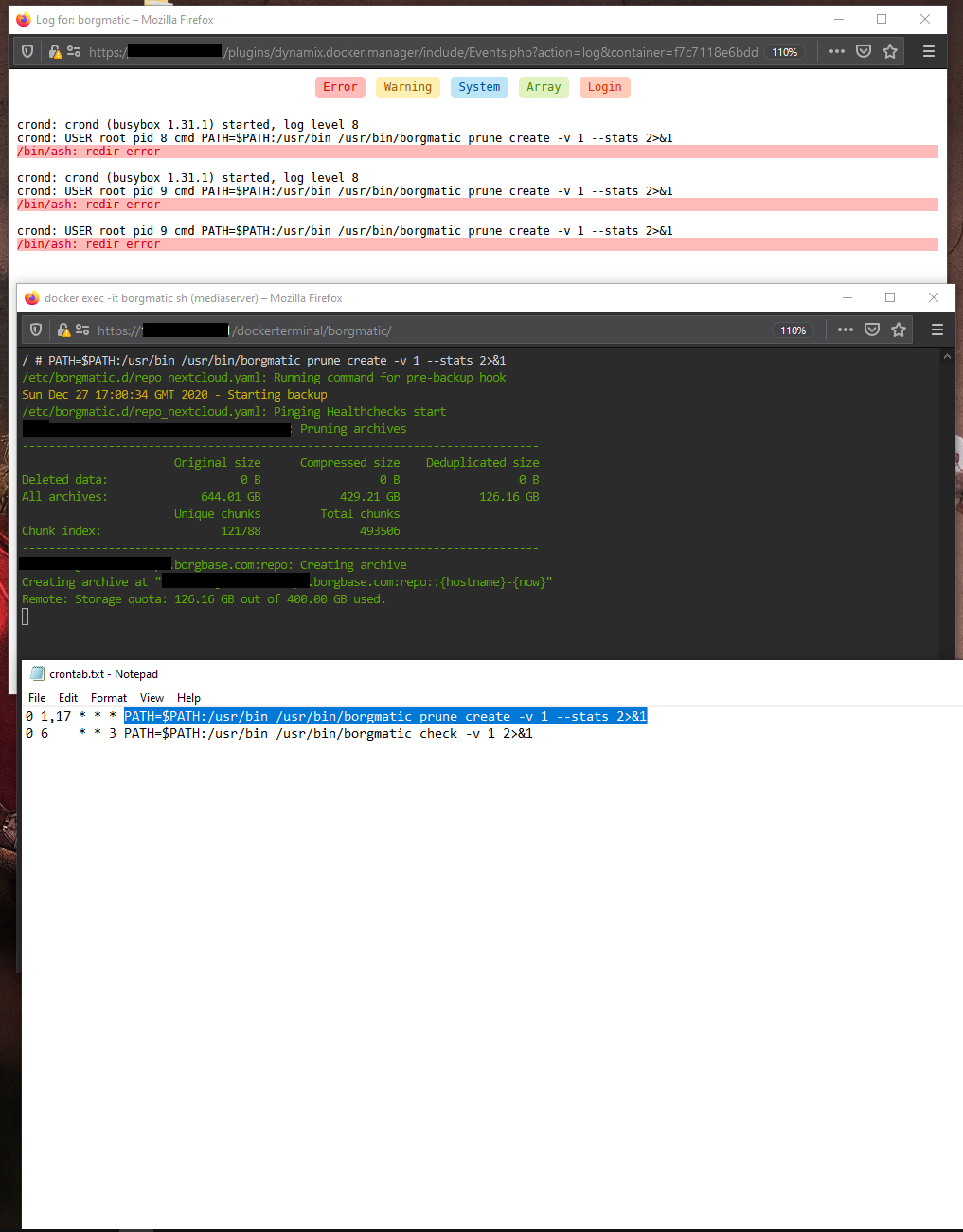

The error was from the previous cron attempt. I just changed the cron time to run and restarted, so its atempting to run the cron but giving the error directory?
Image attached

ISSUE: Cron not running
When I console into the borgmatic container I can run backups fine.  I can even paste the cron entry, and it works, the cron is functioning as I monitored the logs just now, and it tried to run the cron again.
If i paste this into the console it works and backs up correctly.
PATH=$PATH:/usr/bin /usr/bin/borgmatic prune create -v 1 --stats 2>&1
Edited by Greygoose
added colour header RED
So problem solved?
No, the cron runs when I manually run it like the image above.
But when I leave to do it automatically I get the errors as above.
Could this be down to privileges allowed to the cron scheduler?
Edited by Greygoose

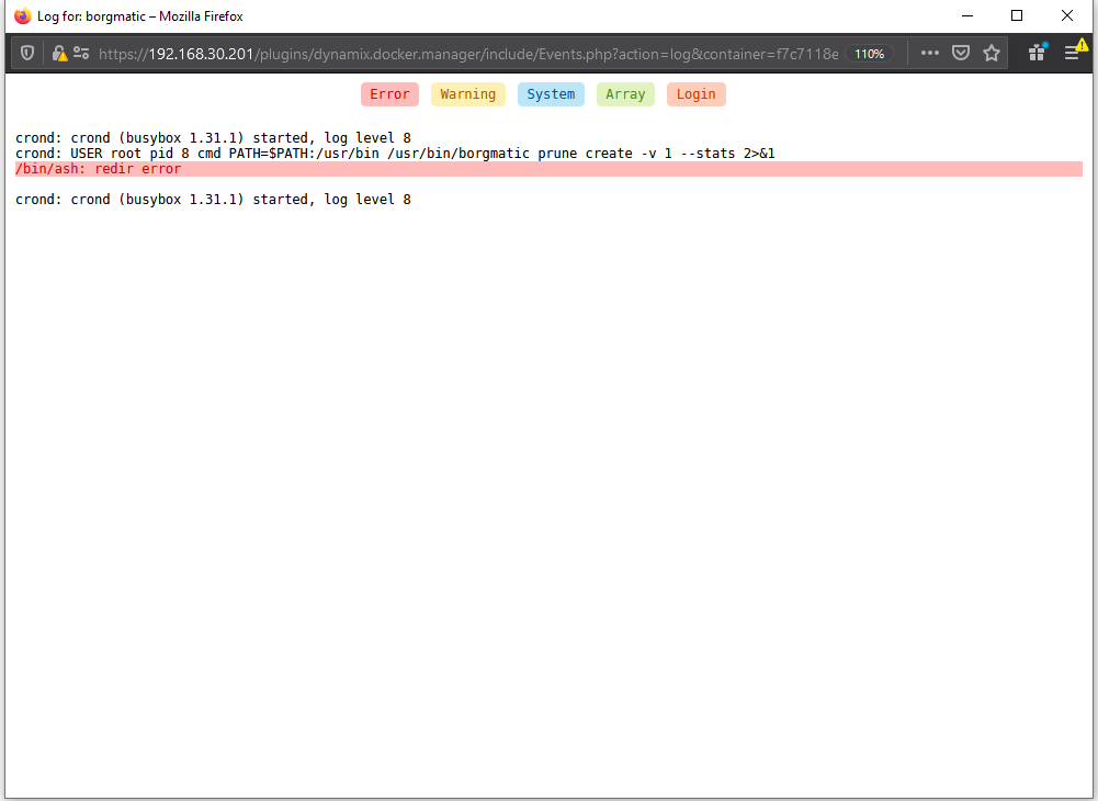

Hey @Greygoose - I setup my crontab.txt as follows, which is found in /appdata/borgmatic/config/ (note, this is the exact file - I have not changed any PATH directories)
0 1 * * * PATH=$PATH:/usr/bin /usr/bin/borgmatic prune create -v 1 --stats 2>&1
0 6 * * 3 PATH=$PATH:/usr/bin /usr/bin/borgmatic check -v 1 2>&1

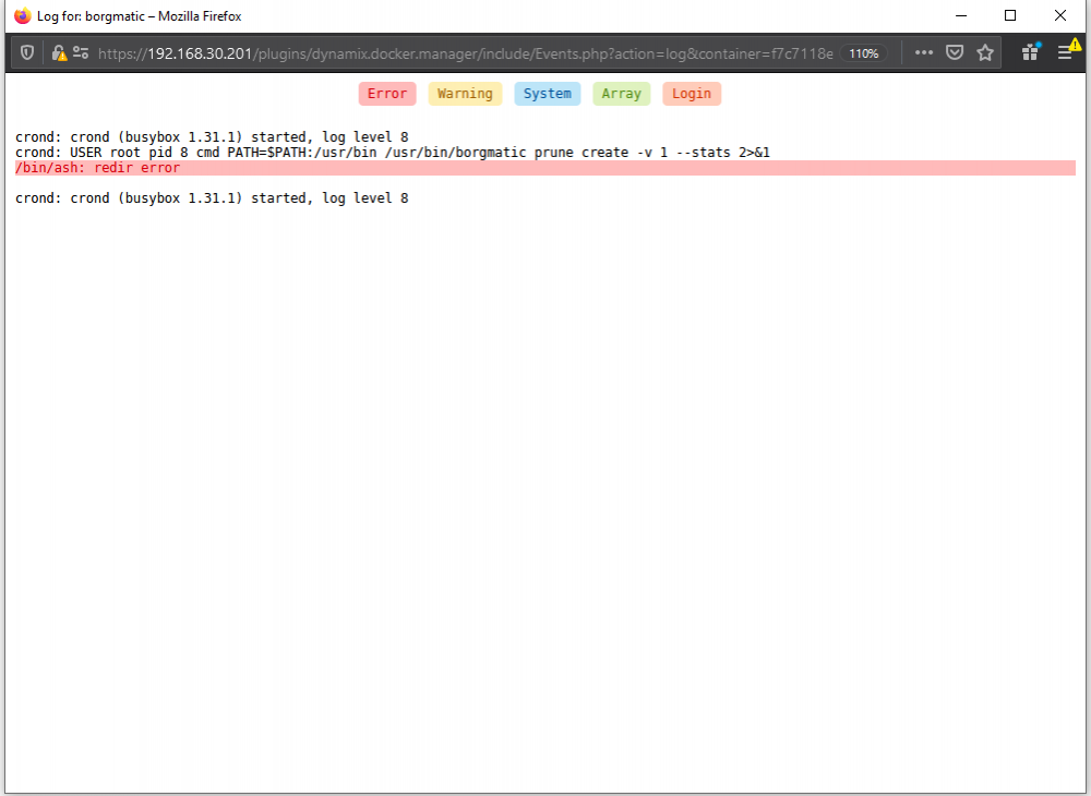

The docker log output:
crond: USER root pid 8 cmd PATH=$PATH:/usr/bin /usr/bin/borgmatic prune create -v 1 --stats 2>&1
/bin/ash: redir error
I thought it may be a permissions issue, but the txt file is set as -rw-rw-rw-.
I did find a post where someone put this in their crontab, but i'd prefer to use the proper method if possible:
0 6 * * * borg create -v --stats --compression lz4 /backup_repository::$(date +'%Y-%m-%d') /backup_sources
I’m going to try and sudo nano the crontab.txt and see if that fixes the /bin/ash error I’m getting. I just read the comments above.
Update: I've tried using the unraid terminal to nano the file and save it, and I've tried running the borgmatic container as an admin, but i'm still getting the
Anyone have tips on how to fix this? Does the file need to be accessible to the 'root' user of unraid?
The Fix: Same as above.
  1. Copy contents of crontab.txt
  2. move current crontab.txt file
    mv /path/to/crontab.txt /path/to/crontab.txt.old
  3. ssh into unraid, or, use the unraid terminal
  4. nano /path/to/crontab.txt
  5. Paste contents of crontab.txt
  6. Restart borg container
Edited by Rick_Sanchez

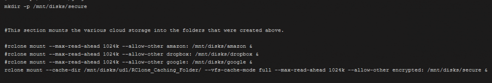

I have an issue which i'm not sure is my configuration or is not possible at all.
I have the waseh rclone plugin installed, unraid is set to boot and mounts the OneDrive folder using the user scripts. I then have the folder set as a repository in the Borgmatic docker, I can see the folder mounts correctly in Borgmatic console.,
When I start the backup in borgmatic after init a new repo on the OneDrive rclone folder it backs up for a few minutes then the array crashes and I need to reboot.  When I login to onedrive I can see the backup has started to upload onto the microsoft servers.  I have tried a few times and always the same outcome.
@Greygoose below is the config I have on my User Scripts to mount rclone, in my case I'm using Google Drive, but it is working fine, no errors so far.
Keep in mind that you have to set up a folder for rclone cache, and use the vsf-cache-mode full.

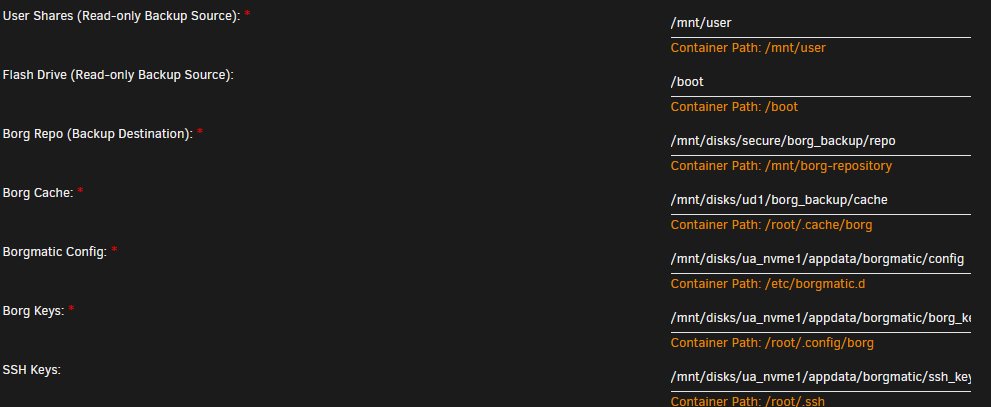

I'm using inside the config.yaml the repo (/mnt/borg-repository)
location:
    source_directories:
        - /mnt/user/sourcerepo1
    repositories:
        - /mnt/borg-repository
    one_file_system: true
    files_cache: mtime,size
But in the docker template I point the repo to the rclone mounted (in my case secure)
I hope these screenshots help others... 👍
