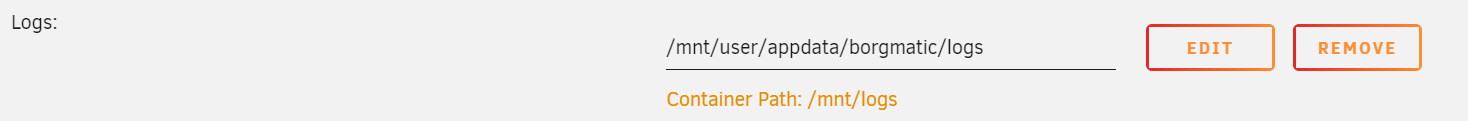

I have followed sdub's guide on creating persistent logs in appdata and can see the output. According to borgmatic documentation the notification should already contain some log up to 10kb? https://torsion.org/borgmatic/docs/how-to/monitor-your-backups/#healthchecks-hook

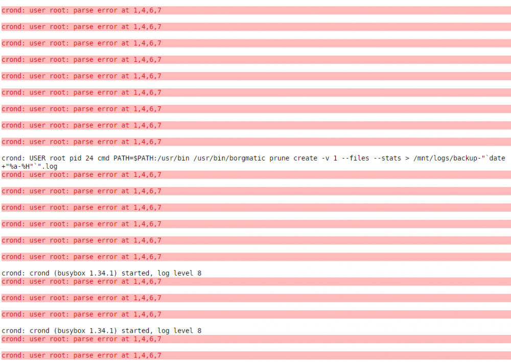

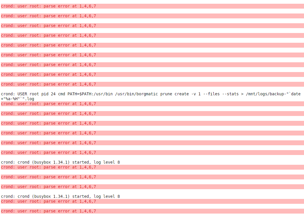

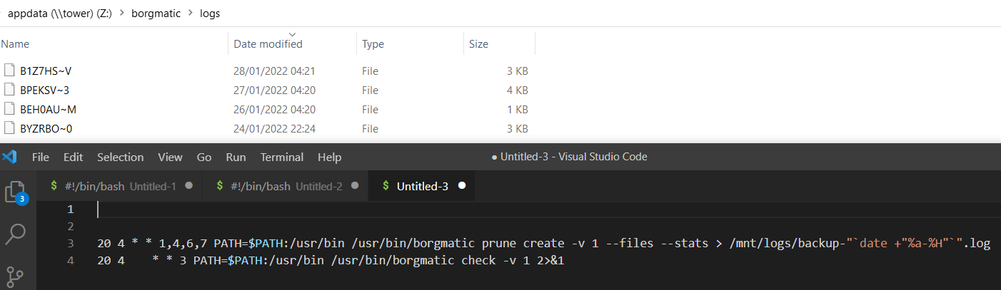

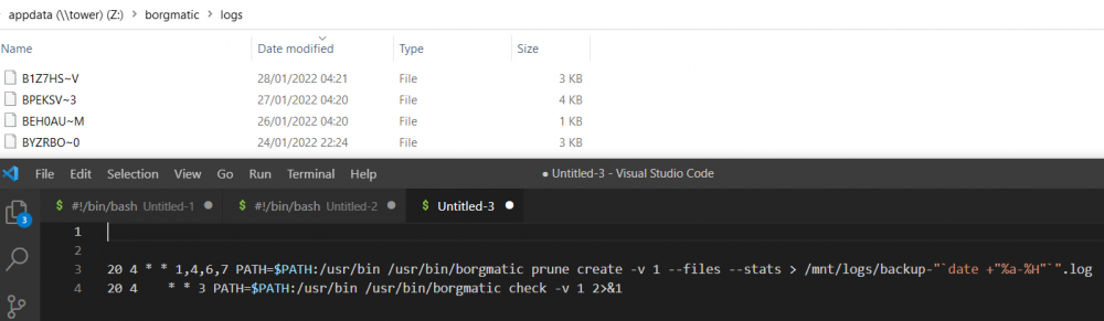

I have tried to set this up but it does not seem to work:
20 4 * * 1,4,6,7 PATH=$PATH:/usr/bin /usr/bin/borgmatic prune create -v 1 --files --stats > /mnt/logs/backup-"`date +"%a-%H"`".log
20 4    * * 3 PATH=$PATH:/usr/bin /usr/bin/borgmatic check -v 1 2>&1
First added the statement with notepad but read elsewhere that it might be causing issues so recreated the file in VSC, the issue persists.
Logs are created but with a strange name:
Docker log is full of cron errors as well
Any idea what is going wrong?
I mean, the logs say "error at 1,4,6,7"
Looking at the part "1,4,6,7" in your crontab.txt file, I do not understand what this is here for and Cron does not understand what it is.
Thanks, I replaced it with 20 4 * * 1,4,6,0 and it appears to have worked! 7 is not Sunday :)
Awesome, yeah not every cron supports 7 as Sunday, they usually use 0. :)
