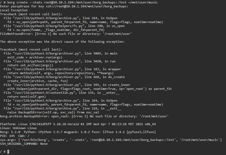

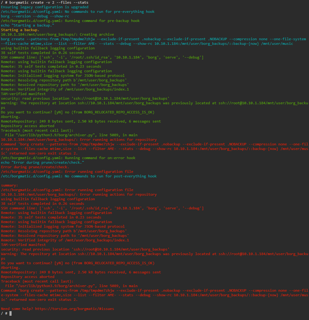

Wondering if someone can give me a hand. I am trying to backup to a remote server also on unraid. I successfully created my ssh keys and init the repo. However the backup fails to run via 'borgmatic create -v 2 --files --stats'. I also tried to just manually create a test backup via 'borg create --stats [email protected]:/mnt/user/borg_backups::Test ~/mnt/user/music' and it fails with similar errors. Not sure what I am doing wrong. I can get borg to work fine via the nerdpack plugin but would like to use this docker. I have attached the errors below. TIA
Borgmatic Response:
Manual borg create:
My Config.yaml
I think the issue is that you created the borg repo then moved it, or are trying to access it using a different path.
Run this borg command manually and confirm that you’re ok with the move.  Then try running Borgmatic again.
borg list 10.10.1.184:/mnt/user/borg
This worked although not sure the cause. I never moved the repo. Only difference is omitting the user prior to the ip. Thanks for your help.

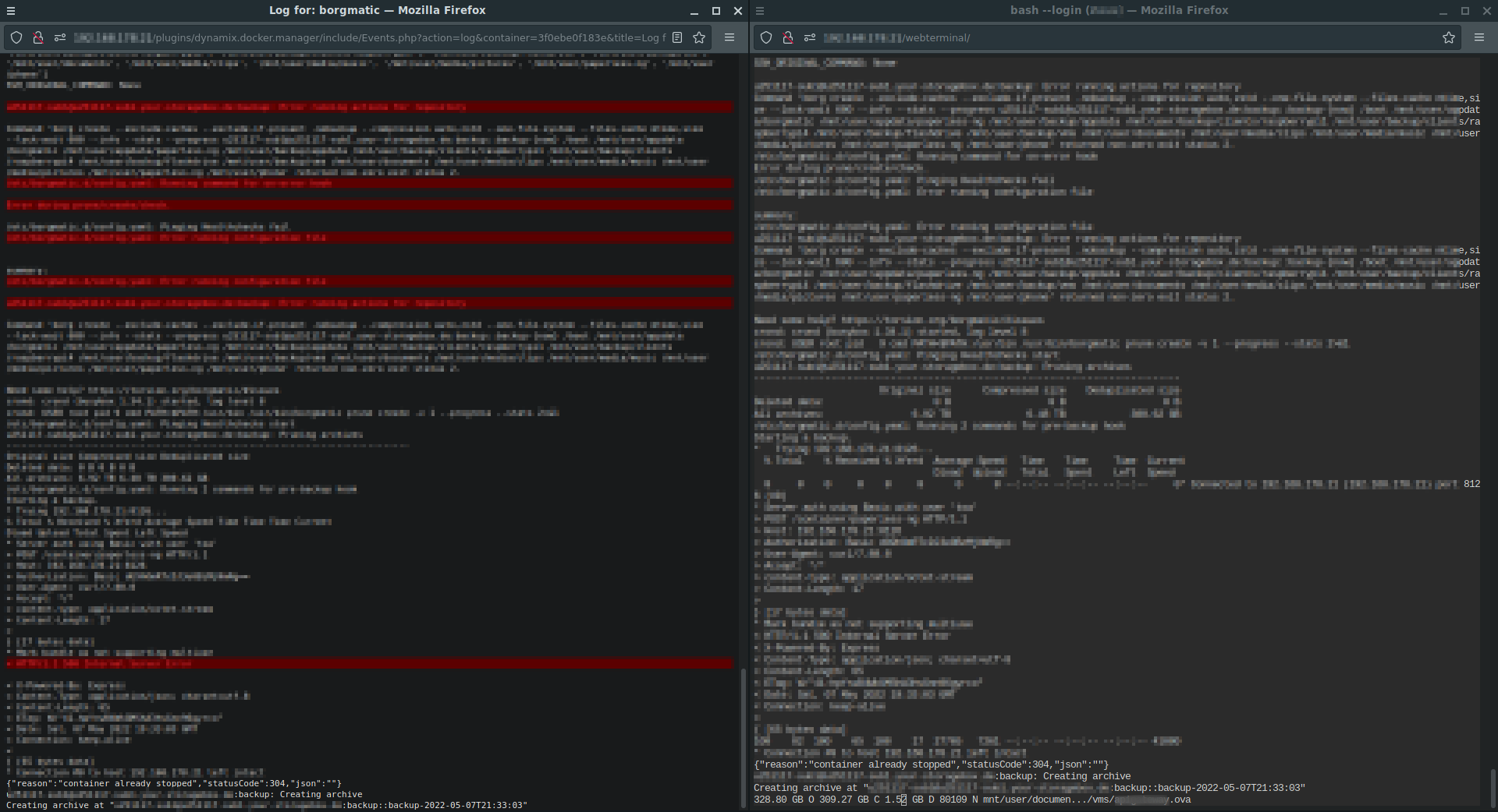

I added the progress flag to my borgmatic command (borgmatic create --verbosity 1 --progress --stats) today and noticed that the logs available via the WebUI are incomplete when compared to docker logs from the command line.
The left side shows the logs via the build-in web UI log viewer. The right side shows the logs via `docker logs -f <id>`. Not sure whether this is an issue with how Unraid fetches the docker logs for the container.
Anybody experienced something similar in the past or can explain that behavior?
