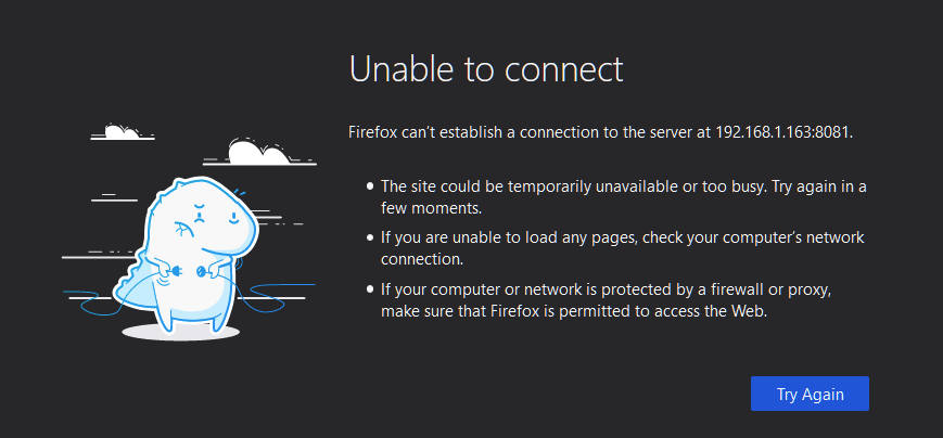

I have been unable to access most of my dockers and after checking the log I saw errors regarding permissions. I fired up the terminal and noticed that all the dockers without all permissions enabled were the ones I could not connect to. The issue appears to be limited to binhex dockers.

Should I recursively add write permissions, or is there an easy way to reset permissions? I tried force updating the dockers that don't work but it didn't help. The ones I'm having issues with are binhex-emby, buinhex-jellyfin, binhex-plex, and binhex-sabnzbdvpn. Thanks for any help!
