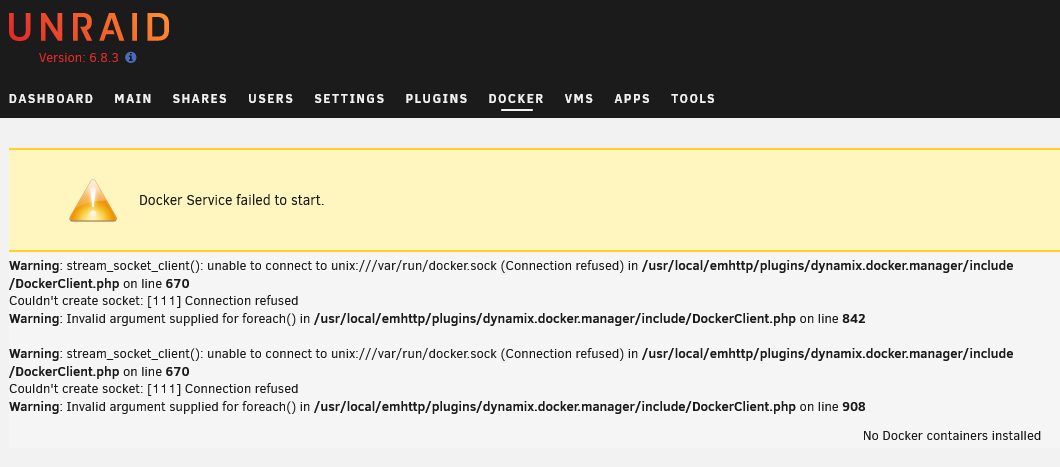

New to UnRAID and I love it, but I've been having some stability issues that I hope folks can help me with.  Usually I can search enough to work things out on my own, but I've started drawing enough blanks here and there that it's time to reach out for help.
I've seen this issue one other time, but I need this system to be stable, so I want to figure out what the root cause is.
This morning I sat down to check on things and saw the following errors when I went to work with my Docker containers.  This is after just 21 hours of uptime.
I don't see anything relevant in the syslog, but here it is anyways.

Why do you have 200G allocated to docker.img? Have you had problems filling it? Making it larger won't fix that, it will only make it take longer to fill. 20G is usually much more than enough. I have 17 containers and they are using less than half of 20G.
Filling docker.img is usually a sign that you have one or more apps writing to a path that isn't mapped. Common mistakes are specifying a path within an app that doesn't exactly match the mapped container path in upper/lower case, or specifying a relative path.
Were those diagnostics taken while you were having the problem in the screenshot?
To be honest, when I was setting this up for the first time and I didn't know any better, more seemed like it would be better.  I've since read that it's literally 10x what it really needs to be, but I haven't bothered to fix it because it seems like a bit of a chore and it hasn't caused me any problems.  Do I need to get it back to 20G?  As far as I know I've never actually filled it, but then again I've never checked either.
Those diags are indeed from before rebooting after the problem showed up.
Nothing obvious in those diagnostics but the screenshot suggests recreating docker.img to me.
