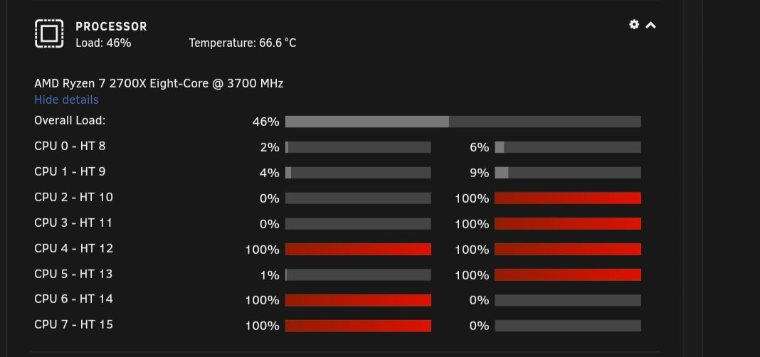

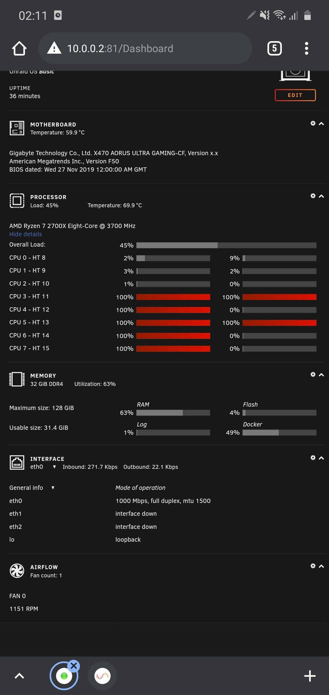

I have the cores that I am using for the VM Isolated so Unraid can't use them, but when I don't isolate them and reboot unraid the VM starts fine? But then after restart windows sometimes boots and sometimes hangs... It's like the CPU can't reset. I'm not sure what's going on at all.
_________________________

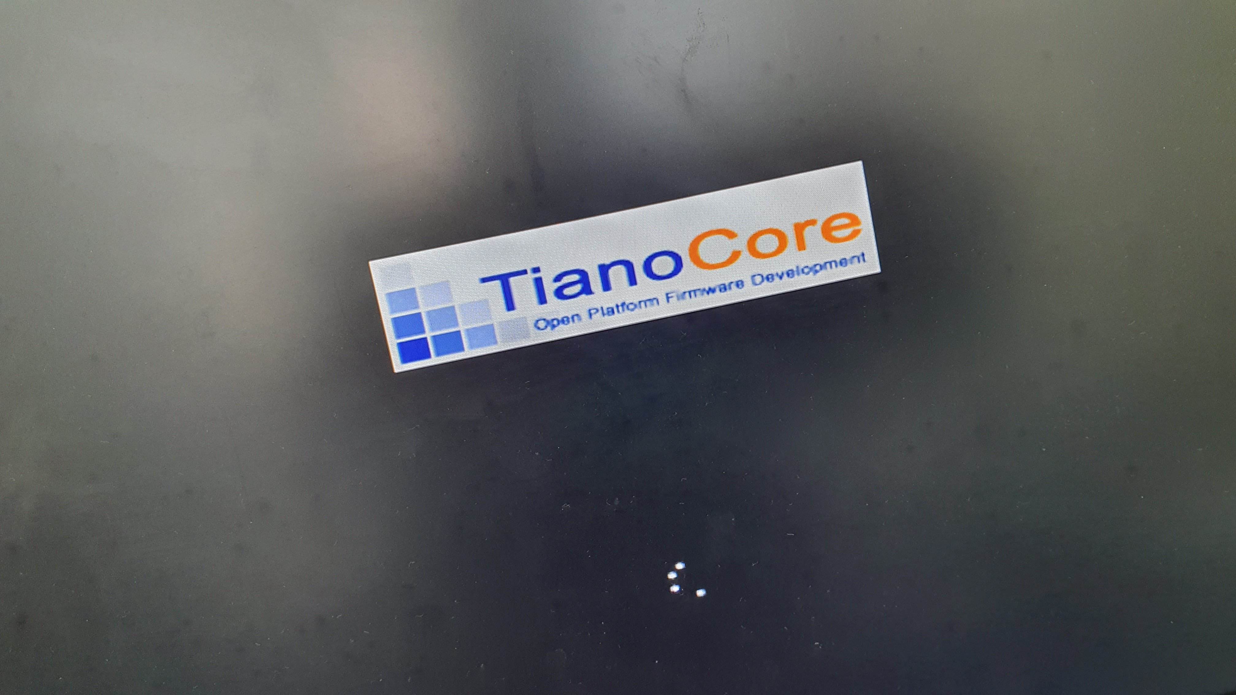

For some reason since 2 days ago my Windows 10 VM will only start if I have 1 core assigned. If I add anymore it will just sit loading at the spinning screen. All cores just hit 100% see attached screenshot.
It did manage to start one but after a reboot the same issue.
I know it says group 30 not owned, I have now fixed that issue.
But that still shows even with one core and starts fine.
Thanks for any help.

Still no luck. I even tried with a new VM so it would be a clean XML and no luck.
I have attached some pictures
Also it's strange that sometimes I can get through to the diagnosing windows screen and get to the start up repair options but still no luck.
