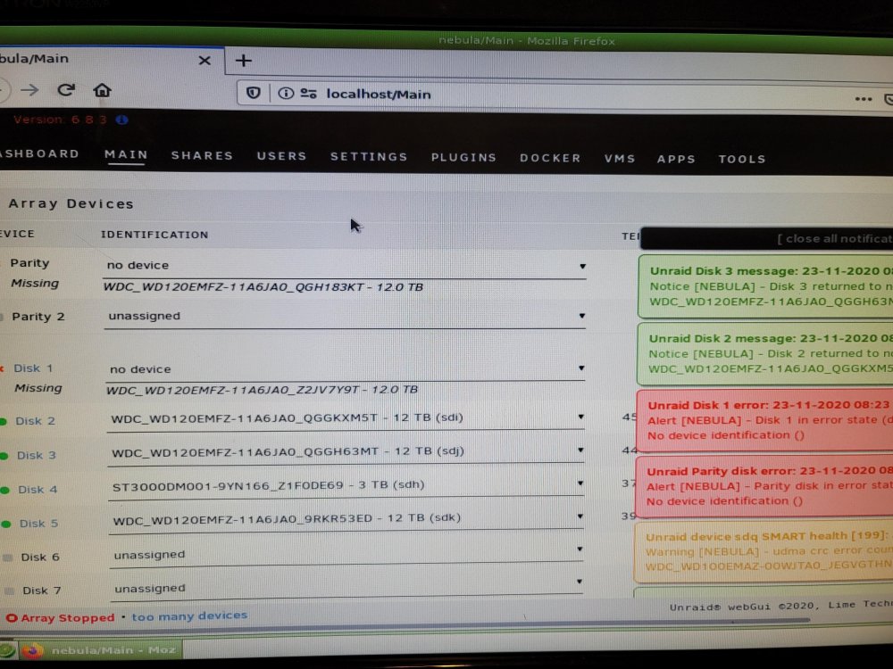

I got the license key situation sorted and it's licensed on the replacement flash drive.  Now the first parity drive (it was initially set to dual parity) was auto-assigned as well as a few other drives (see screenshot).  I have at least 9 more drives that are unassigned in the array.
I can either #1) start the array with the 1 parity drive that was auto-assigned, although I don't know if I want to.
Or #2) if I change the 1 parity drive to 'no device', the option to start the array states 'Start will disable the missing disk and bring the array on-line.  Install a replacement disk as soon as possible'.
If I assign any other of the 9 unassigned drives to any open slots, I'm unable to start the array with the message 'You may not add new disks and also remove existing disks'.

WOW!!  Nine MIA disks from the drive configuration that you loaded!   Give us a history (as complete as you can remember it) about this server.  How many drives were in the array?  Did you have any cache drives?  Did you have any disks that were being mounted using the Unassigned Devices plugin.   When was the last time you added, changed or moved any of the disks that are currently in the server?
8 minutes ago, trurl said:
The main danger of using an old backup is assuming it knows what disk is parity. More than one person has replaced parity with a new disk, reused old parity as a data disk, then later tried to use an old backup of flash that thought the old parity (now data) disk was parity, and it began overwriting the data on that disk.
Understood.  I went ahead and unassigned the Parity 1 drive and started the array with just the 5 disks it had auto-assigned.  Since the cache array wasn't setup, it's now building the BTRFS cache and won't let me stop the array for now.  Will let that run for now.

According to that screenshot, those others are unassigned, not missing.

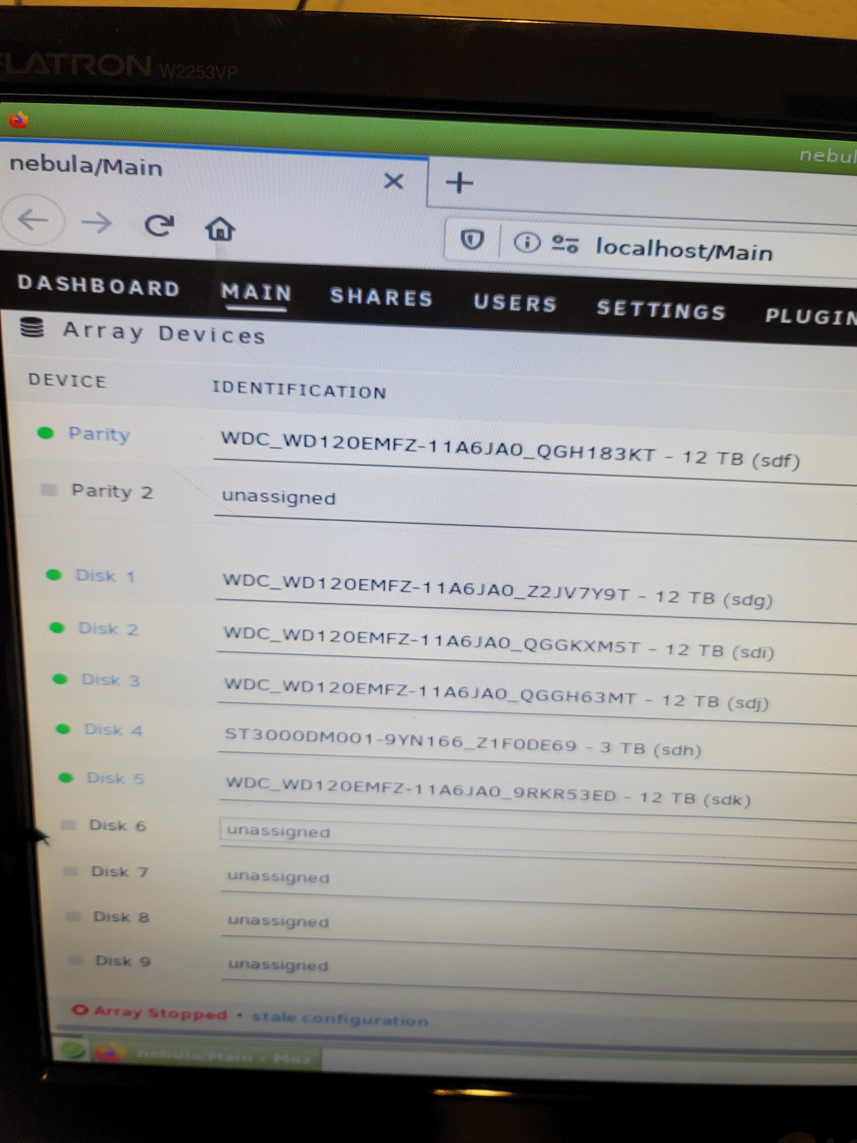

Ok, the BTRFS parity check finally finished and the cache pool is in place (didn't know it'd take that long or else I would have waited on that for later).
I found a fairly recent screenshot of my Unraid Dashboard just before I added the 2nd parity drive - the 2nd parity drive was the last drive I added and was showing as an unassigned device 'sdm'.  This is pretty much an undeniable fact based on the dashboard screenshot.  Unfortunately I don't have any other identifying factors in the screenshot for all the other disks.  The other parity 1 drive I have reason to believe is 'sdf' (from the screenshot above) when it auto-assigned from an old backup.
EDIT:  Just got confirmation by starting the array with all data drives that sdf and sdm devices were unmountable file systems, so they are our clear winners for the parity drives.
Assuming it's safe to assign sdf as Parity 1 and sdm as Parity 2...
Do I still need to know the other drive positions also?
The letter designation is not a reliable indicator since they are just assigned in the order they are detected.

So, I was finally able to locate the most recent flashdrive backup I made, from Oct 13th.  It was in fact in the Backups share, just not shown from when only 5 disks were assigned earlier.  I copied the config over to the flash drive (overwriting everything) and rebooted the server.  All of my drives are now detected in their proper places (except the 2nd parity drive, which is obviously the only remaining unassigned 'sdm' drive).  I believe I am saved now.  Thank you so much for all of your assistance!  You guys are awesome!
Last question - If I start the array without Parity 2 assigned, it says it will perform a parity-check as expected.  If I assign Parity 2, it says it will start Parity-Sync and/or Data-rebuild.  Does it really matter if I assign Parity 2 at this point, or should I 'be safe' and assign Parity 1, wait for the parity check, then assign parity 2?  I may just be overly cautious.

On the screenshot you mention, do you have the drives serial number visible ?
If so just use this to assign your drives. As you said, Parity 2 will be the last remaining drive.
Nope, it was just a screenshot of the Dashboard which doesn't have S/N info or any other identifying characteristics.
Thankfully I am back up and running - I decided to add the 2nd parity and it's now doing its parity check on 2.  All is functional except for a few minor changes I made after the last backup.
