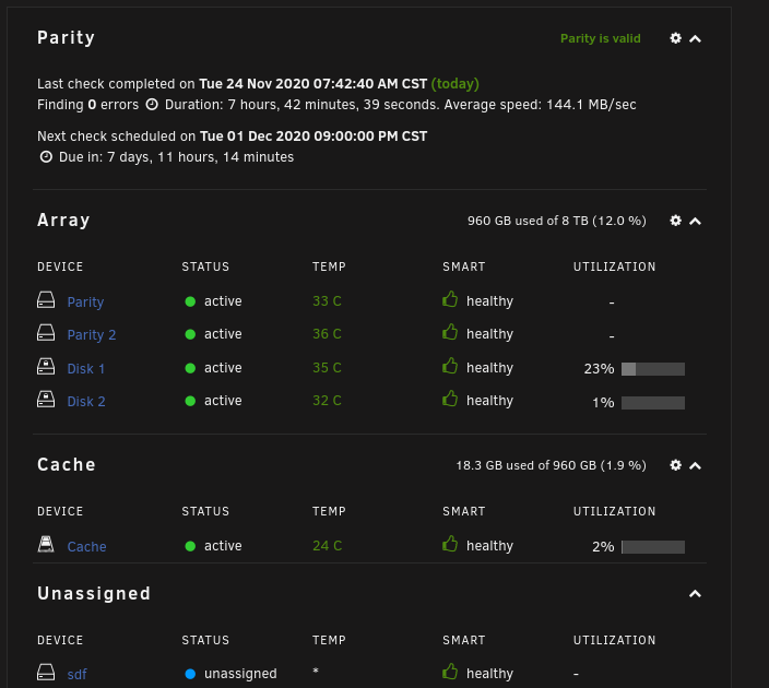

Thanks @jonathanm. Can you tell me if the below looks right a basic setup (again, trying to get close to 'mimicking' RAID 6?
Now, I have the 4x 4TB drives set
Parity
Parity 2
Disk 1
Disk 2
(and then added a 1TB Evo 870) for Cache.
Does this look right for the array to 'mimic' the Raid 6 setup I had prior? Thanks.
Sorry- Also, once I have the drives in, how would I set up the second cache pool using BTRFS RAID1?

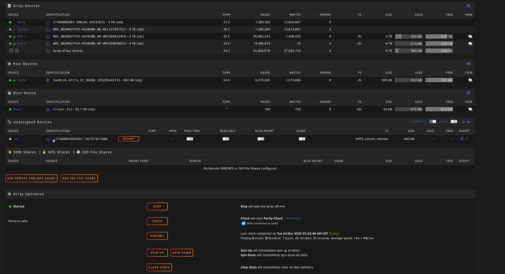

Can you post a screenshot of the MAIN GUI with what you have done so far?
I don't see the 2ea 8TB drives in the Unassigned section. Are they connected?
Sorry, I dont have the 2x8TB drives in yet. I was only asking on how so I could prep.
Do the main drive setup look correct to you?
Looks good so far.
With the 2 8TB drives connected and the array stopped, just click Add Pool and go from there.
