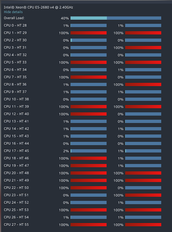

Today, is the first day that the "dashboard" is available, I'm able to see that some of the CPUs are pinned. (this never happens)
Also, on the Main page, only the drive show up, today though, I can see the "Array Operation" section.  I tried to stop the array... but it don't think it'll work.

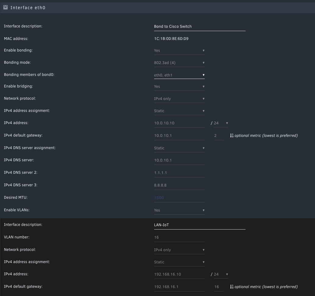

I'm noticing errors relating to. "192.168.16.10" - this was it's old IP.
the only major change I did prior to my unraid server crashing like that was change my network.
I have have multiple VLANs and this servers local IP is no 10.0.10.10
I didn't think it was related.
Network related crash, simply your LAN config as much as possible.
What in the logs whats you think it's a Network issue?

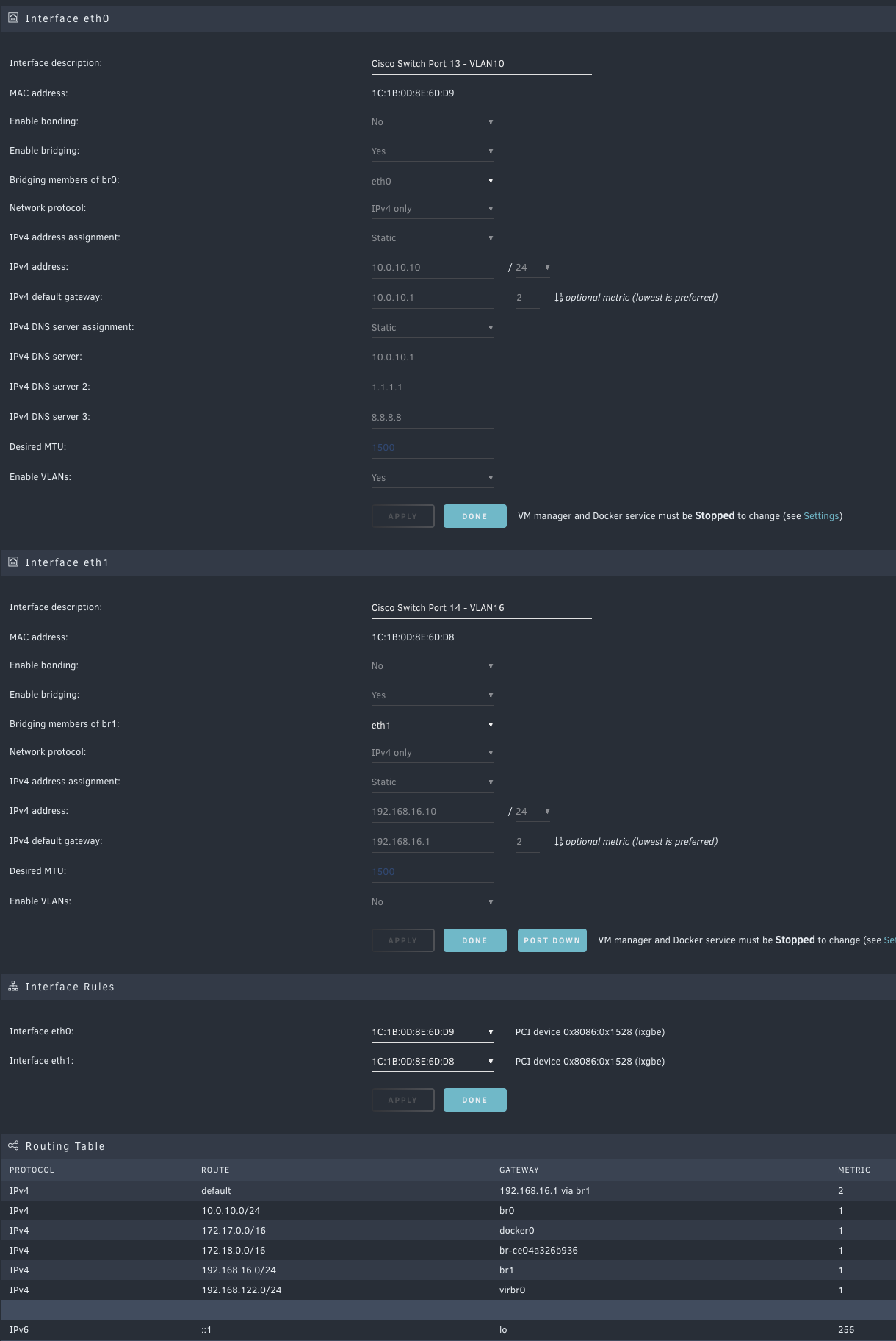

Here are my configs..
Call trace refers network related modules and the NIC driver.
Alright.. I got rid of the Band and Trunks.
Let see if I can stay up for more than 2 days.
Thanks for helping me out.
UPDATE!
My Network configurations was redone, more simple as suggested. I basically removed the bond on my unraid server. And reconfigured both ports on my switch to 2 single ports with their own native vlans instead of 2 ports in a trunk group.
Instead of the usual 24-48 hours, I was up to 3 days! I wanted to wait for a 4th day before posting back with a success story,
