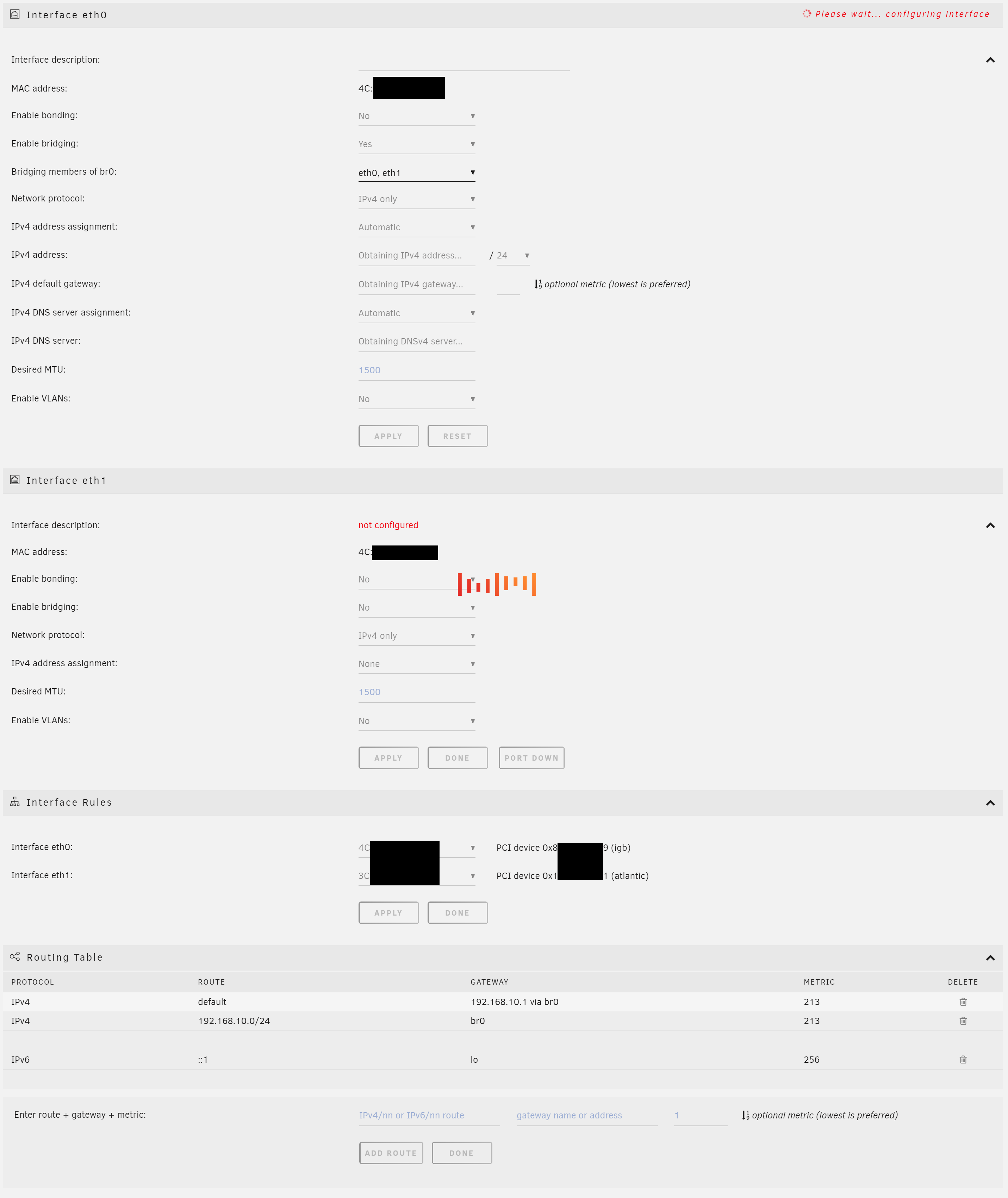

my unraid machine is connected to my gigabit switch, which is connected to the router and most other devices in my home.
Now I bought two ASUS XG C100C Network cards to create a 10G connection between my PC and the unraid machine. I've read that it is possible to configure unraid to behave as if it were a switch:
Both of these posts conclude on the same config:
For eth0:
- Enable bonding = No
- Enable bridging = Yes
- Bridge members = eth0, eth1
For eth1 (will get automatically added to the eth0 bridge)
- Enable bridging = No
But if I disable eth0 bonding and enable bridging (add eth1) and leave everything else unchanged, unraid looses network connectivity. Therefore I have to take the thumbdrive and delete network.cfg.
What am I doing wrong?
Edit:
I'm running Unraid 6.8.3.
I'm currently also connected to the router from my PC. Is this a problem? (I can't use the 10G direct link currently as its not configured yet)
