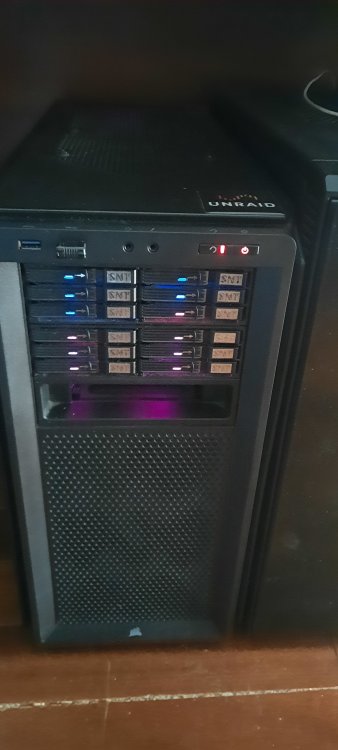

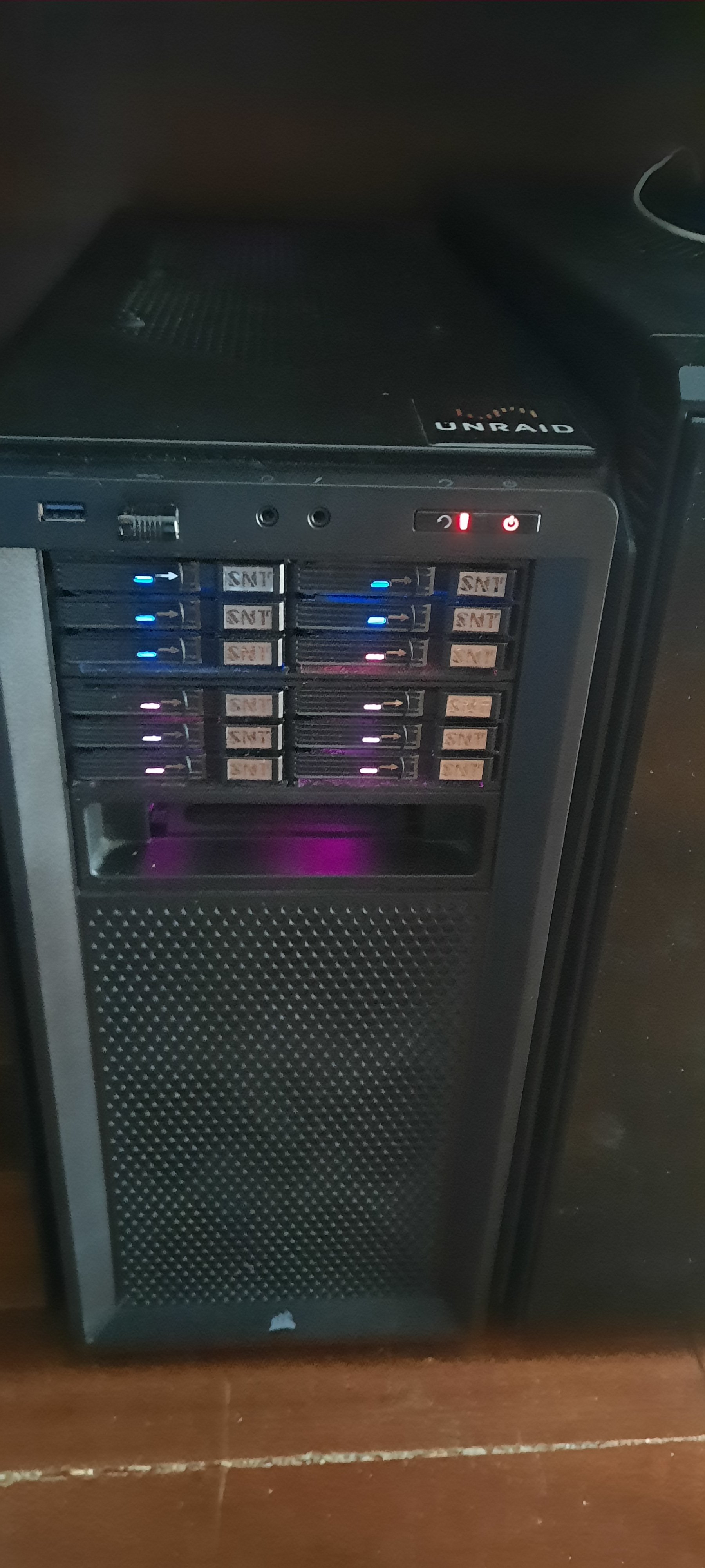

PS can we post pictures somewhere of our build? i found these great 2.5" drive cages who take up one 5.25" slot, and they are in black mesh kinda, it fits the case perfectly, i think im in love )))
Also have some 2.5" drive cages:

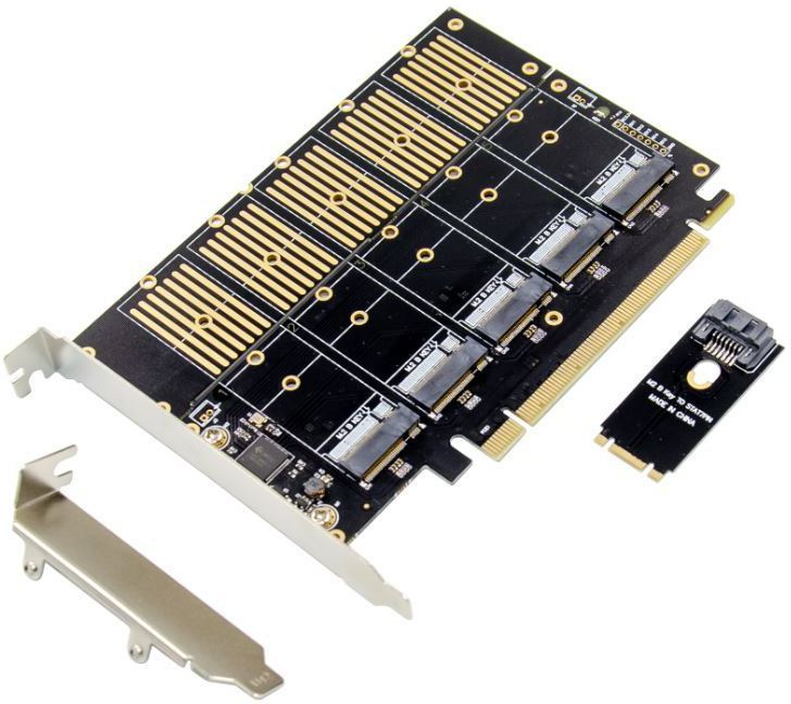

but for HDDs, the SSDs are in a controller like this one, only 4 data devices, like mentioned it's a small server (parity is NVMe).

looking good , i like those status lights )) one can never have enough lights ))
