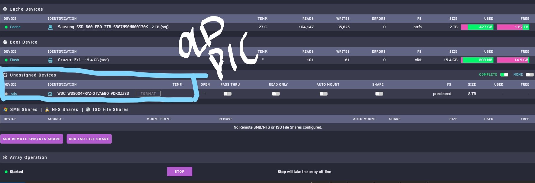

996375760_Screenshot10-22withtheDriveShowingasprecleared.thumb.jpg.8678757d4e5c6891415b28a8ffc7d15f.jpg
Has anyone encountered this before. Diagnostics is attached. All help appreciated.
tower-diagnostics-20201126-1012.zip
Edited by abhi.ko
Moved picture down

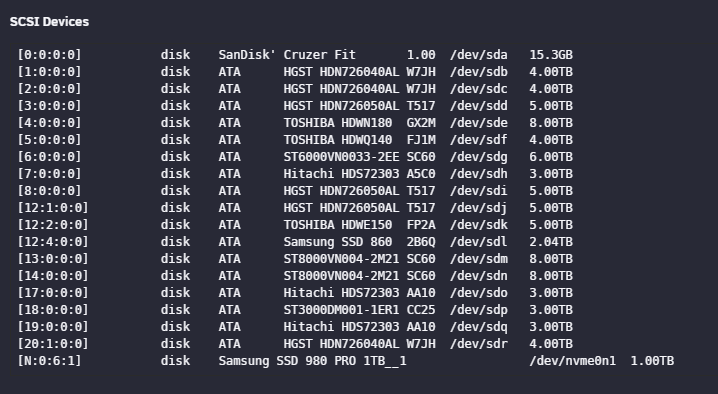

This looks like the only disk not assigned to the array:
devs
    [d..0] => Array
            [id] => Samsung_SSD_860_PRO_2TB_S5G7NS0N600130K
            [tag] => 0
            [device] => sdl
            [sectors] => 4000797360
            [sector_size] => 512
This is from the vars array that shows what Unraid says is unassigned.
You have 15 disks assigned to the array, plus cache, and parity.  One disk is unassigned.  That's 18 disks total.  You have 18 disks showing in the smart.txt of the diagnostics.
If you have more disks, there is an issue with your port multiplier?

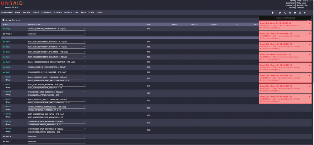

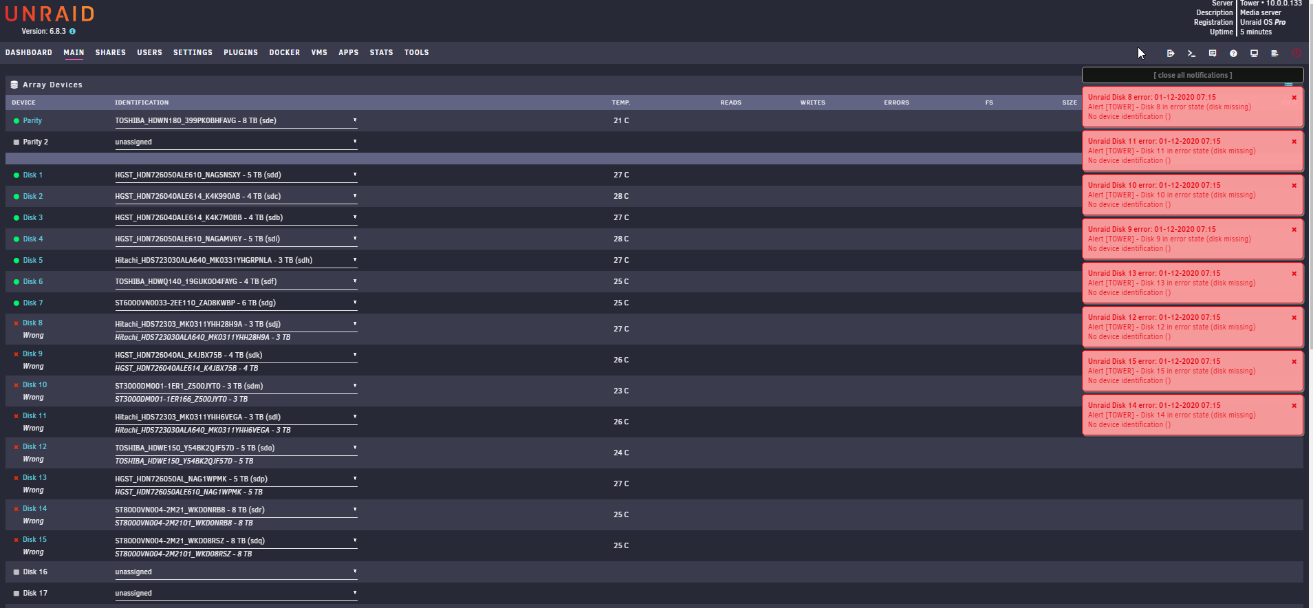

  • Unfortunately, I do not see the unassigned disks still, all the assigned disks still do get recognized. So the HBA card did not solve the issue, those 2 disks are connected to the HBA card.
  • Also bigger problem is that I have a ton of missing disks now. I guess the way the card identifies the disk and how it was identified earlier with the SATA multiplier cards are different, please see the screenshot below. Unraid says they are wrong disks but they are the same.
How do I fix this without loosing any data please?

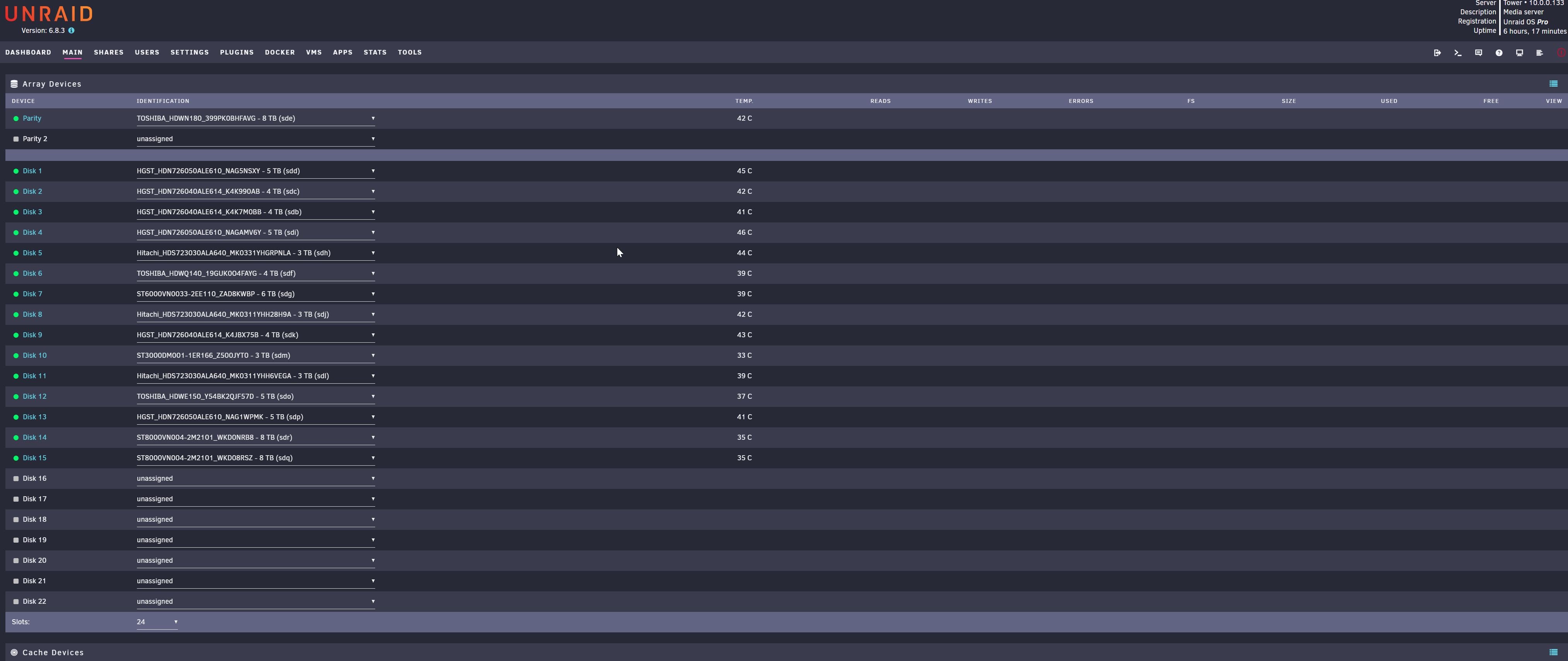

Update: So the array is now back to normal, did not even have to reboot. The disks all got assigned properly immediately after the HBA was flashed. The only problem is that the 2TB SSD that was showing up prior as unassigned is no longer showing up, neither are the other 2 hard drives.

Priority #1: I have an xfs disk in error now that happened when I was trying to insert another unassigned HDD on the hot swap bay to test while the array was running. Have done it many times before, this is the reason why I bought a case with hot swap-able bays to begin with, not sure what went wrong this time. Any how I have the array running with this disk showing as unmountable. How do I recover this and clear this?
Priortiy #2: Will come back to the other issue of drives not being detected soon, but I took those drives out (a WD Gold 8TB and a ST Ironwolf 8TB) and tested them on a windows system (through an external SATA hot swap bay attachment from SABRENT) and the ST did get recognized, but the WD did not, so I am RMA-ing that one (that is the one that was already precleared in Unraid before all this started). So I plugged in the external SATA device with the ST drive on to Unraid by USB and the drive did get detected, which leads me to believe that the issue is with the NORCO drive bays/SAS Backplanes/power connectors etc? The unassigned SSD is part of the same SAS Backplane (HDD row) and it works fine. So I'm not sure what the issue is.
The one I was trying to plug in today was different 5TB drive, which was being detected by windows as well but not detected now, by unraid . Anyhow that was just to test this hypothesis.
Priority is to recover the disk in error. All help appreciated please.
tower-diagnostics-20201204-1216.zip
Edited by abhi.ko
Besides disk15 there's also these:
Dec  4 10:12:54 Tower kernel: md: disk9 read error, sector=9000
Dec  4 10:12:54 Tower kernel: md: disk13 read error, sector=9000
Dec  4 10:12:54 Tower kernel: md: disk9 read error, sector=9008
Dec  4 10:12:54 Tower kernel: md: disk13 read error, sector=9008
Dec  4 10:12:54 Tower kernel: md: disk9 read error, sector=9016
Dec  4 10:12:54 Tower kernel: md: disk13 read error, sector=9016
So some hardware issue there, as for disk 15 reboot then check filesystem, if the emulated disk mounts you can rebuild on top, but ideally after fixing whatever is causing those issue, could be power, cables, etc.
So I did an xfs repair on disk 15 and had to use the -L option because the drive was un-mountable. It was completed and now the disk is mounted but still shows as disabled and there is a bunch of data in Lost+Found - I'm unclear on the next steps. No SMART errors on the disk.
What are the steps to get the drive to function normally and move the files from Lost+Found to the right folders/shares?
tower-diagnostics-20201205-0902.zip
Edit - Can I not worry about the Lost+Found directory as mentioned here and just reconstruct the disk from parity? Or is the parity for this disk messed up (somehow) as well because of the fs corruption? Disk 15 was emulated when the array was started last, I have switched the server off for now.
Edited by abhi.ko
