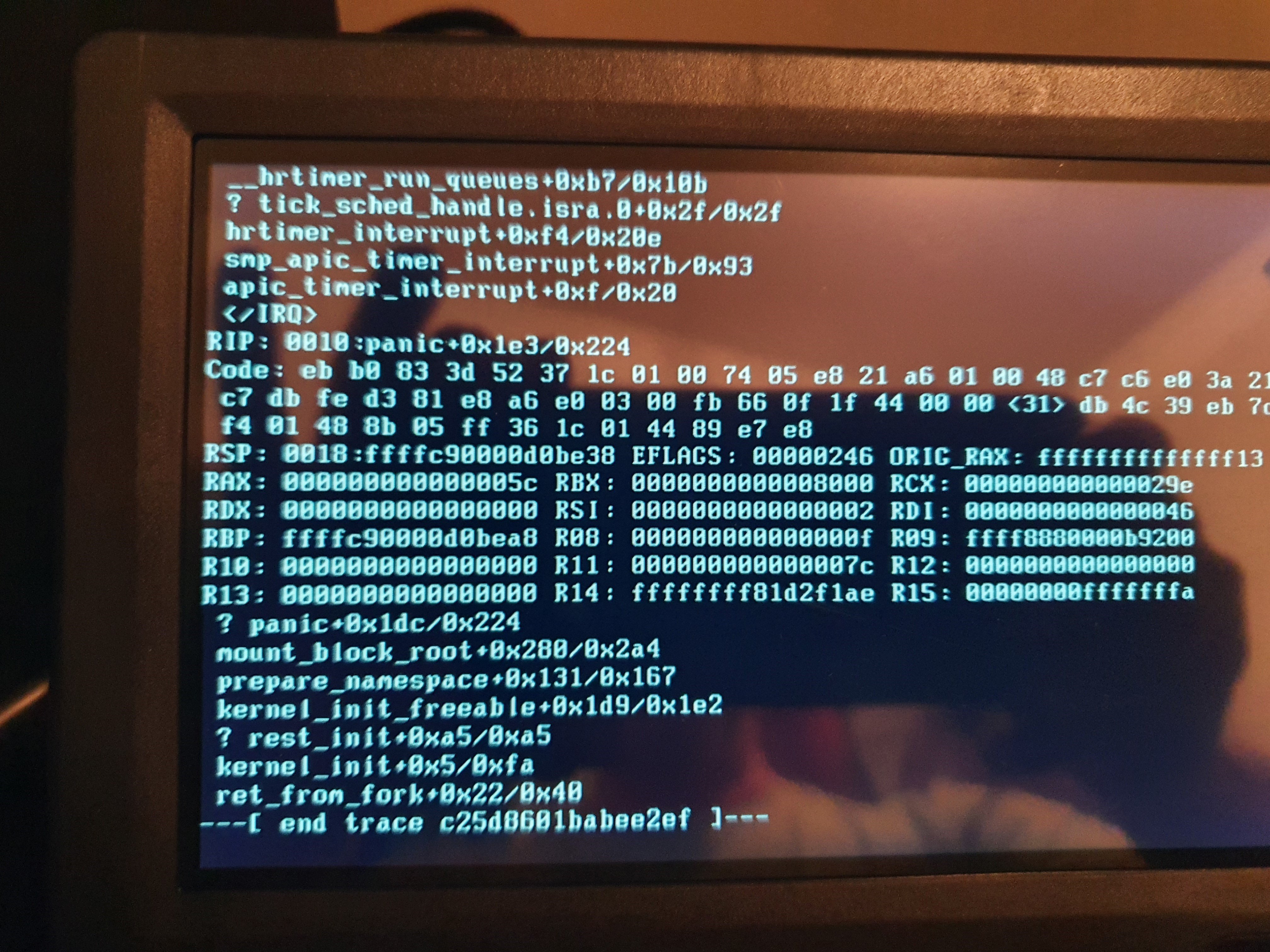

Hi everyone last weekend i updated from 6 disk to 12 on my license and restarted the the system but now it will not boot up again i am worried because i have so much stuff on there and no experience on this1736128483_unraiderror.thumb.jpg.d9256905cc75e2043115ede993982faf.jpg UNRAID i have added image of what i get thanks you very much
Edited by Sparky678911
Start by redoing the flash drive, backup the config folder, recreate the flash using the USB tool, restore the config folder.

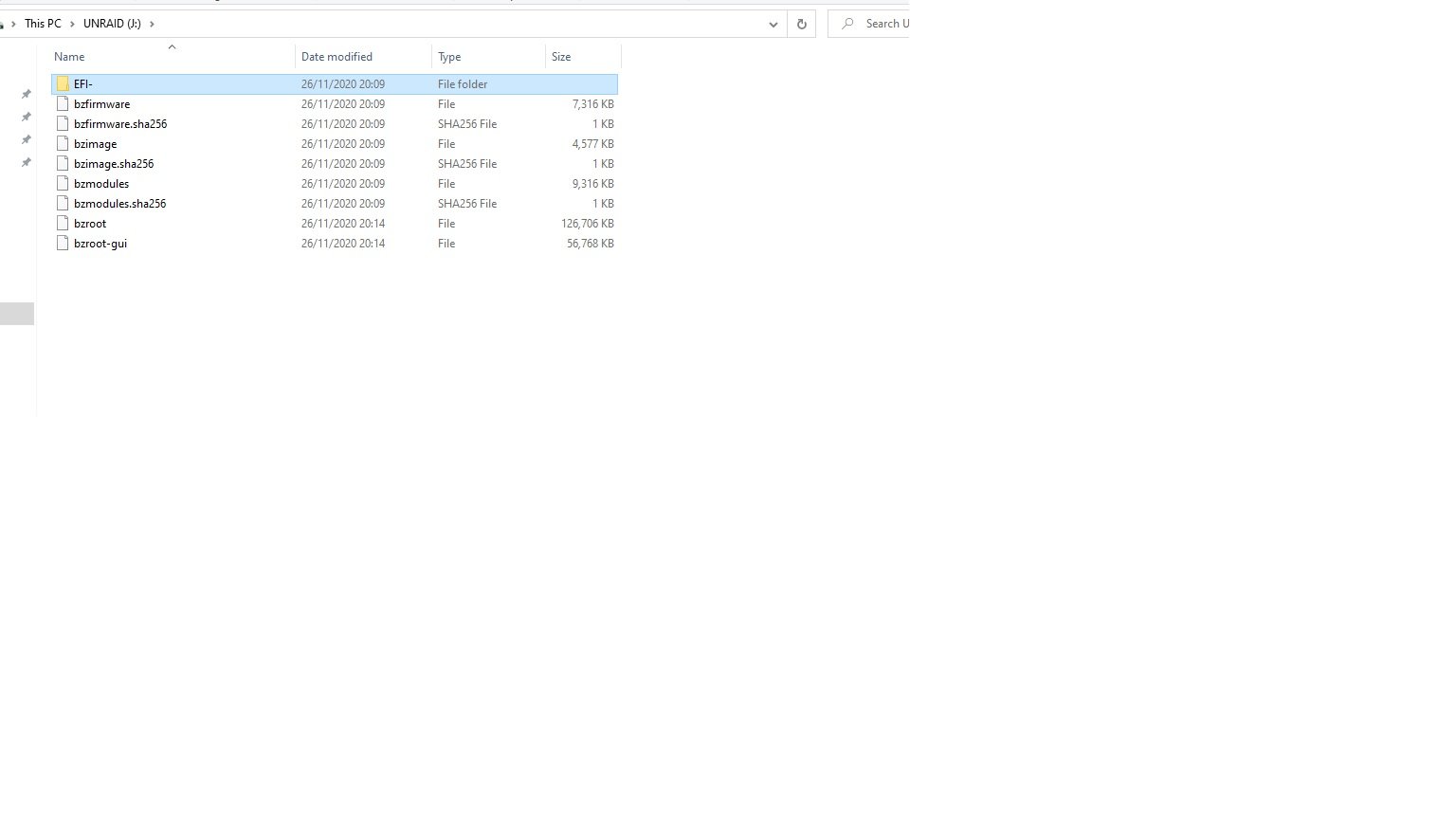

so i dont know what i have done but hope i have not screwed it up this is all i have on the usb and will not boot up help
That is definitely not correct as there should always be a ‘config’ folder and a ‘syslinux’ folder.   Did you take a backup before trying to recreate it - if so you can redo the USB stick and then copy the config folder from the backup.
