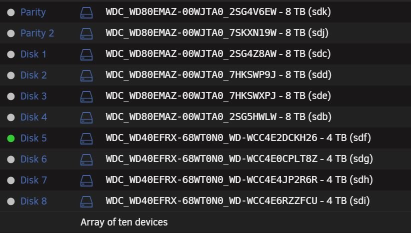

If I move disks 5-8 to slots 9-12 (both physically and in the array configuration), will it invalidate my parity (I have 2 parity drives) ? A picture of my array configuration is attached. I could not find the answer in https://wiki.unraid.net/UnRAID_6/Storage_Management or in the forums.
Ultimately, I would like to insert 4 additional drives in slots 5-8.
Many thanks for your help.

1 minute ago, trurl said:
It will invalidate parity2

Yes,  the calculations for parity2 includes the drive slot number as one of the input variables while that for parity1 does not.

Physical configuration doesn't matter, but slot assignment is how drive order is determined. Slot 5 is not equal to slot 9. Just because you move a whole block of drives, it's still a different order because slot 5 doesn't contain the same bits as it did before you reassigned it.

And yes, what you describe is considered "reordering" from the UnraidOS point of view (especially w.r.t. the parity2 calculation). And like others have said, the physical configuration doesn't matter at all -- you can change where a drive is physically mounted or which SATA/SAS cables/ports to use between boots and the OS will easily cope with it. (Although I wouldn't switch an array drive from being internally mounted to being in an external USB enclosure.)
I used to be overly concerned with the ordering of the drives, but I eventually found that it's best to live with leaving the order alone. Although... I have requested a feature to be able to assign nicknames to the drives to make it easier to manage. But if you do choose to reorder, keep in mind that the 'included/excluded' drive selections in the shares do not automatically update to track the change -- you'll have to update those manually.

Not true.    You can have as many gaps as you want.  Most people prefer not to have gaps but,Unraid does not enforce this.
