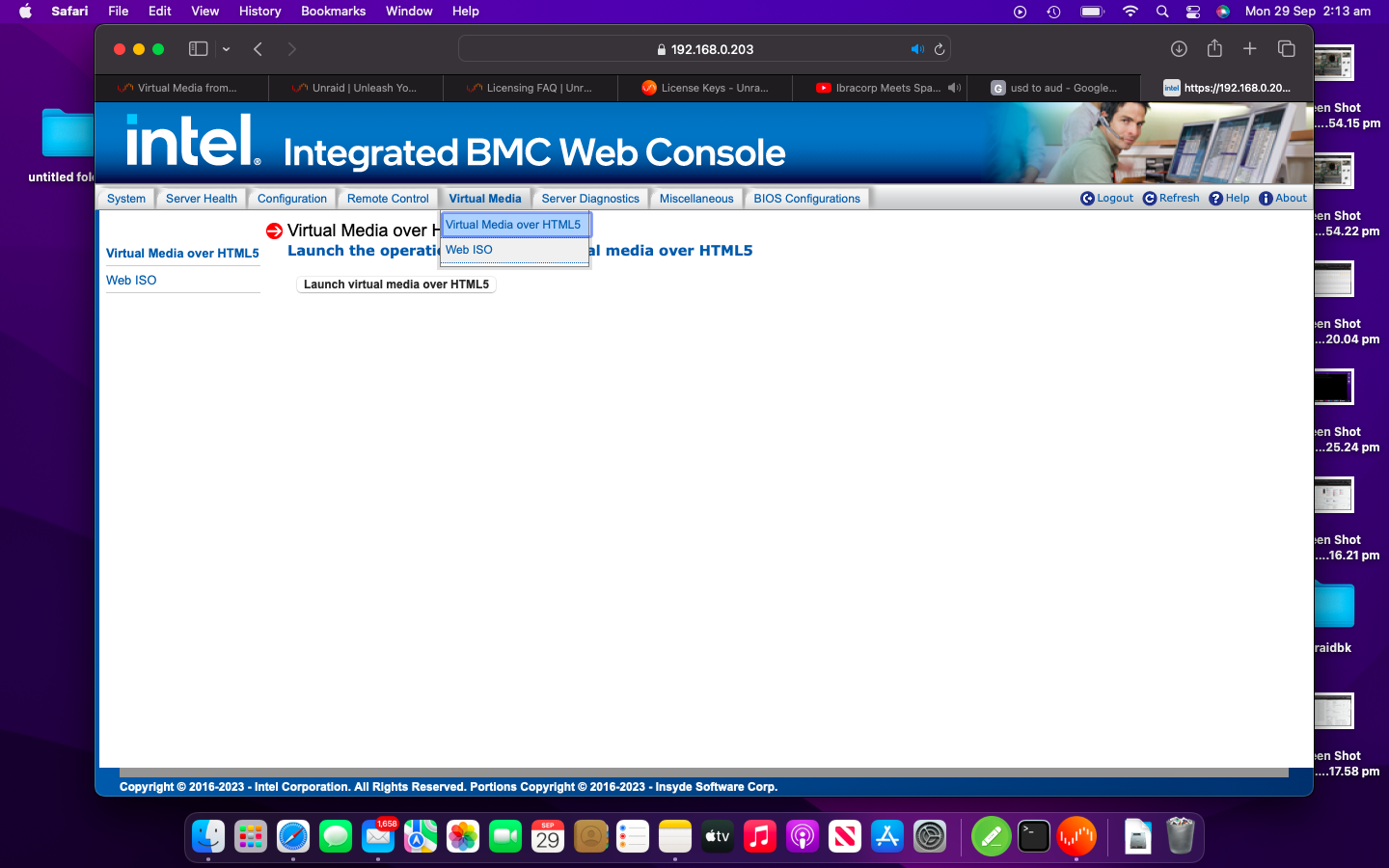

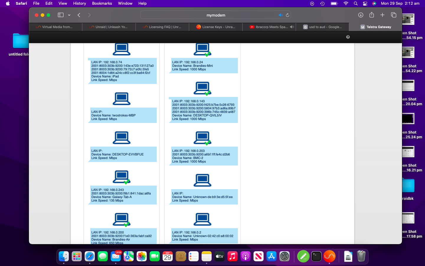

You have to connect to your bmc and remove them, connect to your bmc port to network, make sure you have login and pass for bmc set in bios then post IP of BCM port in browser address bar and connect. Unmount virtual media and done, here's mine from my s2600stb and note I connect to modem gateway to find broadcasted BMC port IP.
