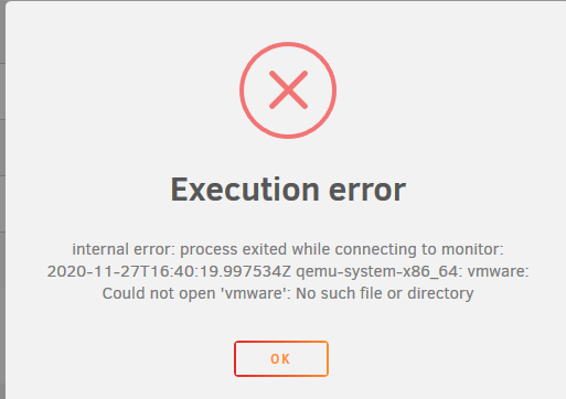

Tried that but get an error when starting the VM
Sorry, but I don't know, I simply translated into code what it's written, which seems correct to me.

7 minutes ago, ghost82 said:
You can try this also:
   <video>
     <model type='vmware'/>
   </video>
Just experimenting with 2d acceleration and the vmware svga kext from darwin.iso. Doesnt look like UNRAID likes it.
