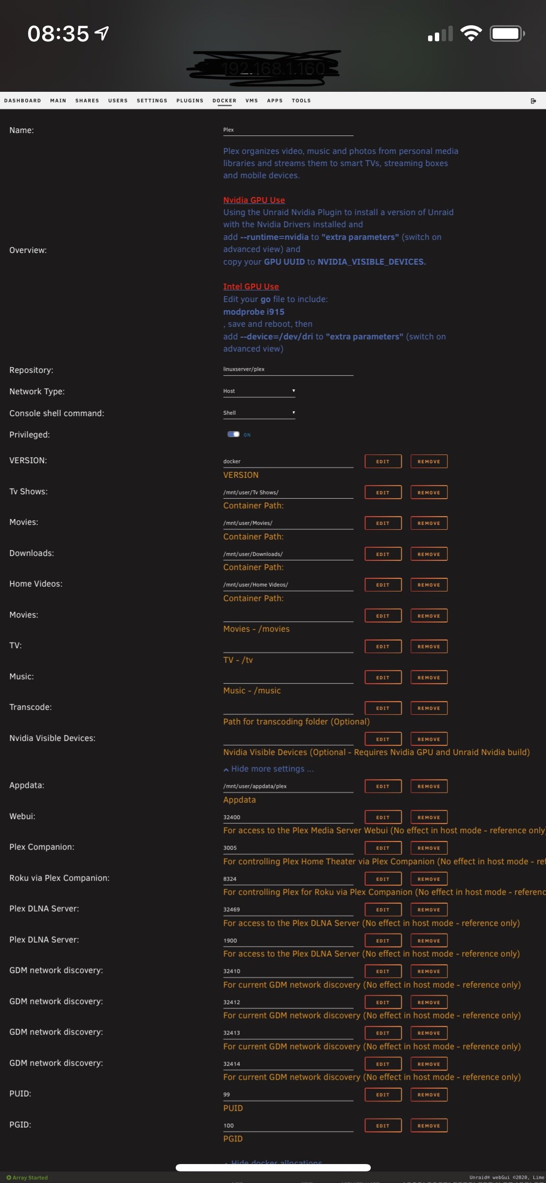

Thank you for the reply.Looking at what you have suggested I think it is set correctly. Looking at the intel GPU notes I’m not sure if that’s correct but I can’t seem to work out how to check what it’s talking about.
You might ask in the support thread for the Plex Docker that you are using.  You can find this by left-clicking on the Docker's icon and picking the 'Support' from the dropdown menu.
