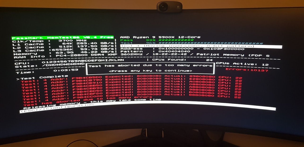

I tested the SSD in another system and passed ok, tested it with preclear and got random lockups, never in the same place.  After reading up pre clear tool isnt designed for SSDs sp ignored the lockups.  Decided to do a memory test and it stopped after a few mins due to to many errors!!!
So basically i believe all my issues are down to faulty RAM and not the SSD.  I have order some new sticks that should be arriving in the next few days.

The OS is unpacked fresh from the archives on Flash at each boot
