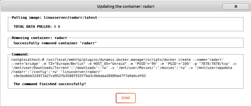

Docker containers are not able to update anymore or establish a connection:

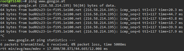

Pings are looking fine though:

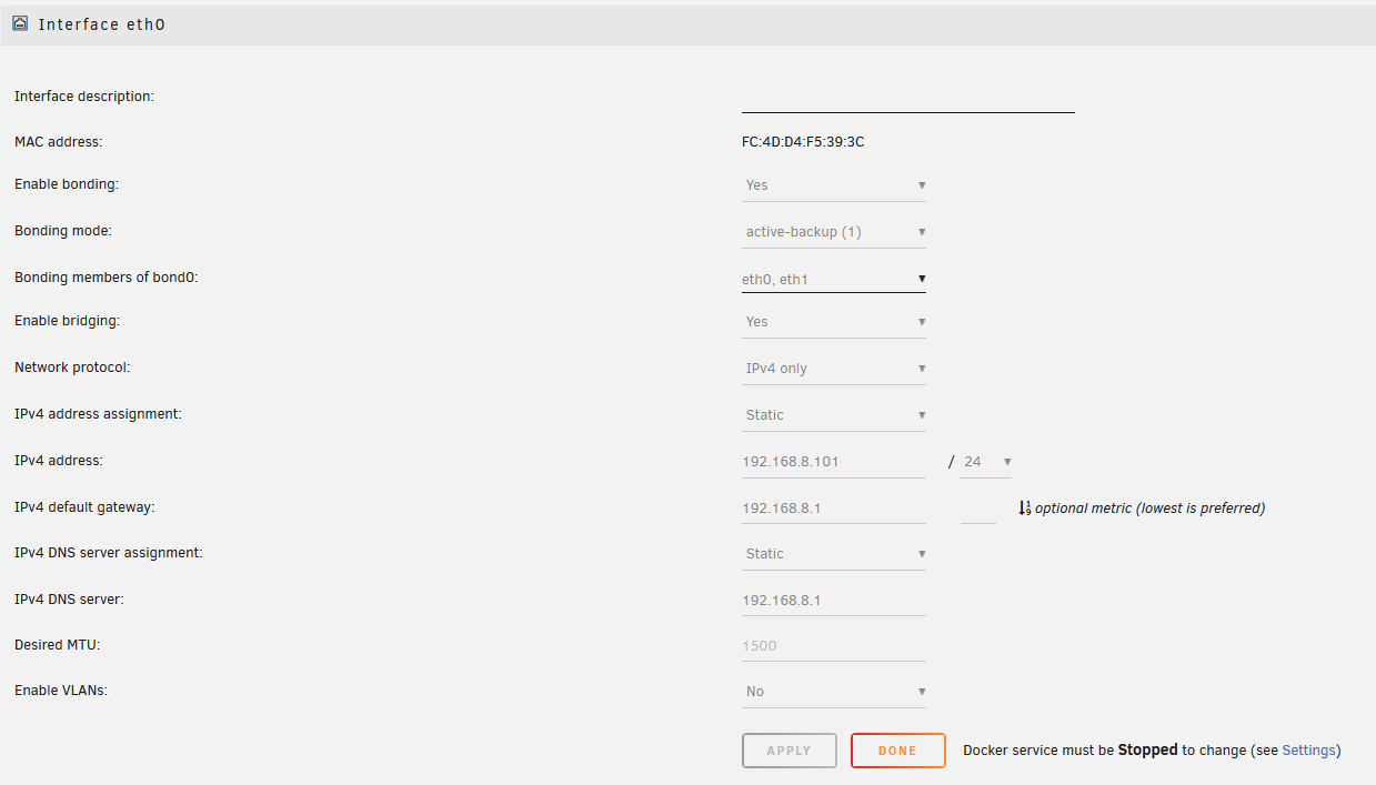

Those are all my network settings
Unraid static ip:
image.thumb.png.09a989ca4338d1c0b93f03374bf70451.png#

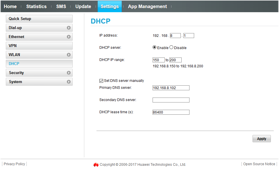

Router DHCP settings:

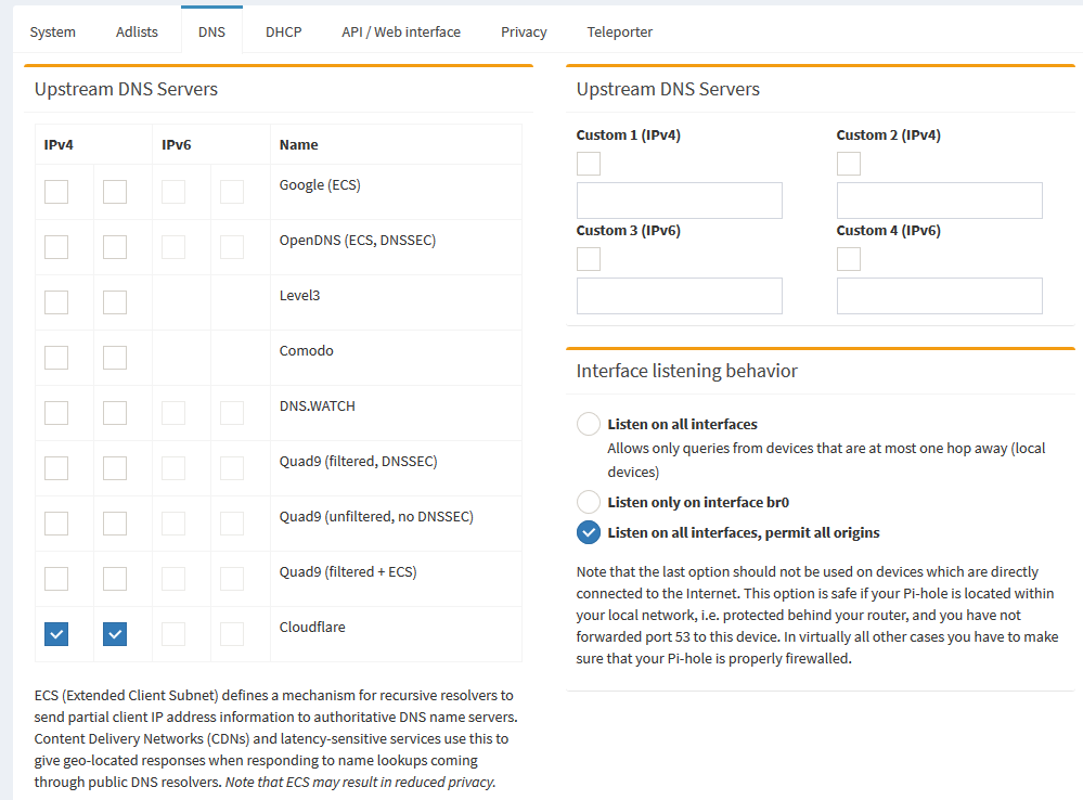

Pihole

I did the following. I set the unraid server static DNS to 1.1.1.1 and the Router DNS to the Pihole IP. Everything is now working fine right now. It seems that setting the pihole server address as DNS in the UnRaid Server Network settings during the changes and the docker containers not running that it creates some sort of confusion.
