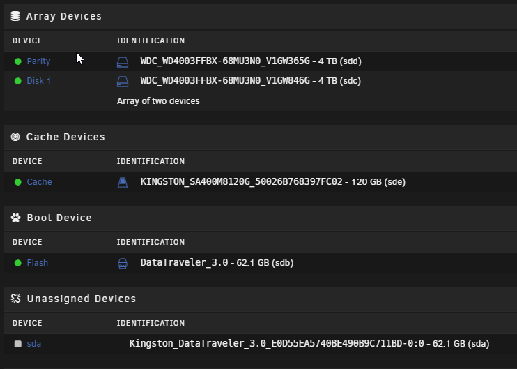

Speaking of things USB related, I am now successfully booted and my boot USB shows up as the flash device. The second USB shows up as an unassigned sda. I suppose I now have to "assign" it to get it to show so I can point my backups to it?
Will this USB count towards my device limit? I am guessing so. Meaning this will bring my total to 4 devices leaving me open to two moer, right? Since I gather the boot doesn't count.

Backup appdata using CA Backup, and don't attempt to use your boot flash as a backup destination or any other large writing.
